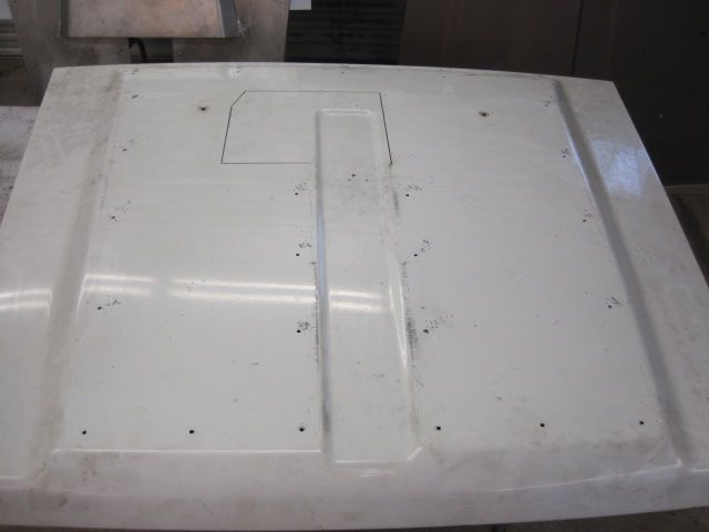

the fun ...
mark the cutout for the intercooler flow through
cut
clean
done
simple, unless you are like me and nervous when cutting perfectly good sheet metal.
