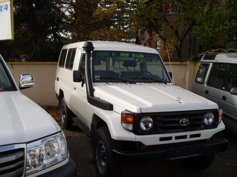

I know, i was in Fance a few years back with my gal, we went to see a dealer that preps them for ( Raids) in Africa.wanted info on price,etc
VERY,VERY, expensive but i think worth every penny!!!!
ah, one day!

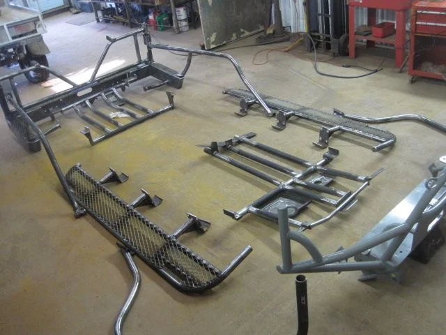

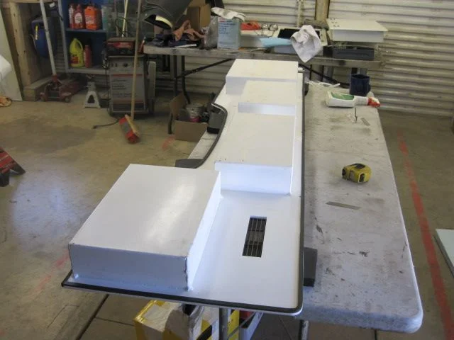

the steel is cut with a waterjet machines.
the pipes are bent using a manual Greenline bender.
thanks for the compliment.
i designed the components from idea to paper to cut and welded to powder coated.

yesterday finished off the storage boxes and added antirattle foam.

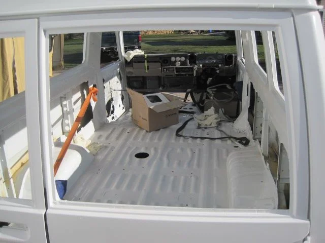

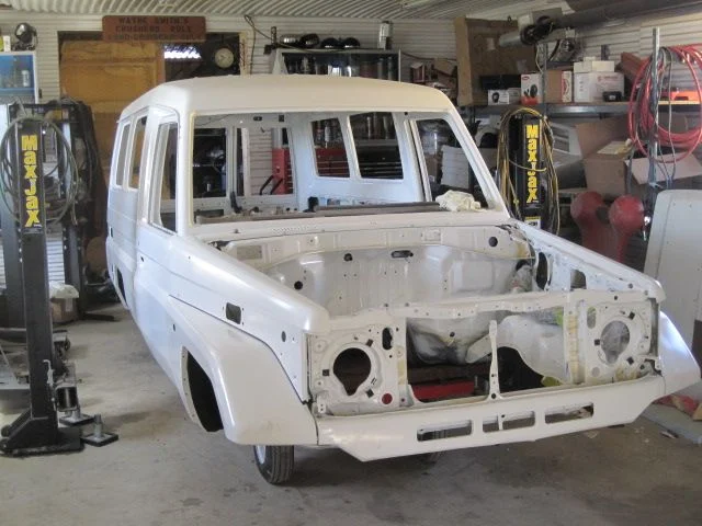

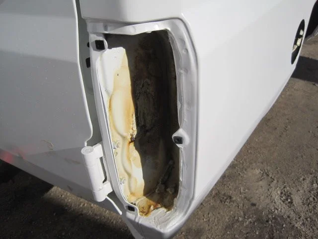

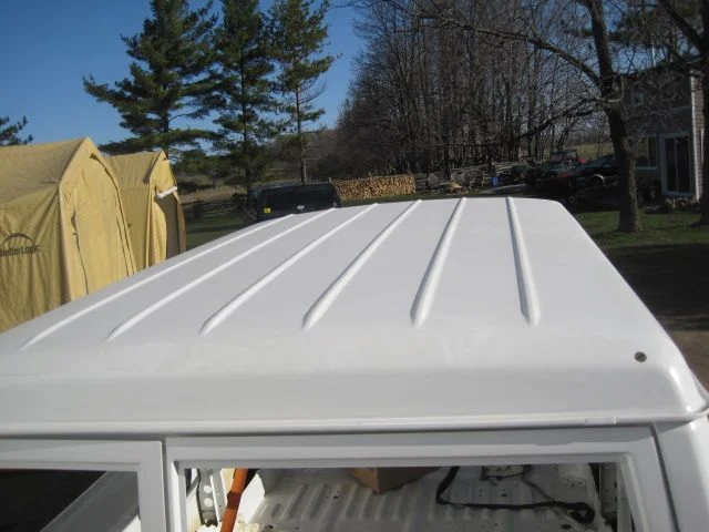

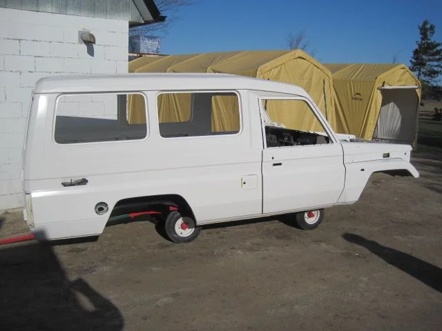

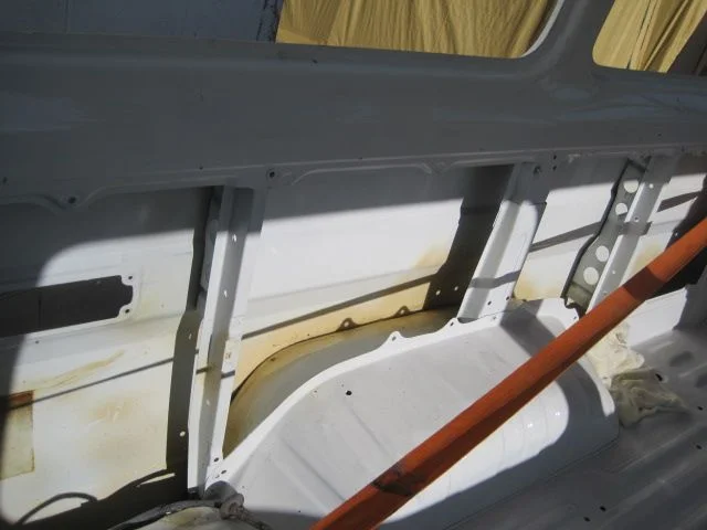

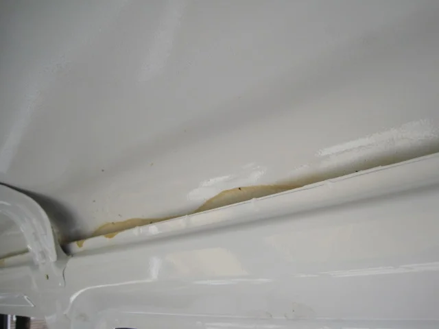

well, the body is back. a few flaws will need fixing but all in all a decent job.
TONS of rust proofing in all the joints, roof inner channels, everywhere ... what a bitch to work around. :mad:

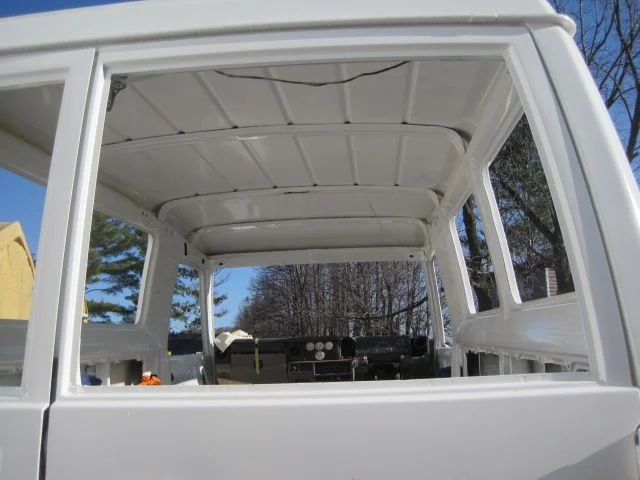

the outside is chauk white
the inside is factory white

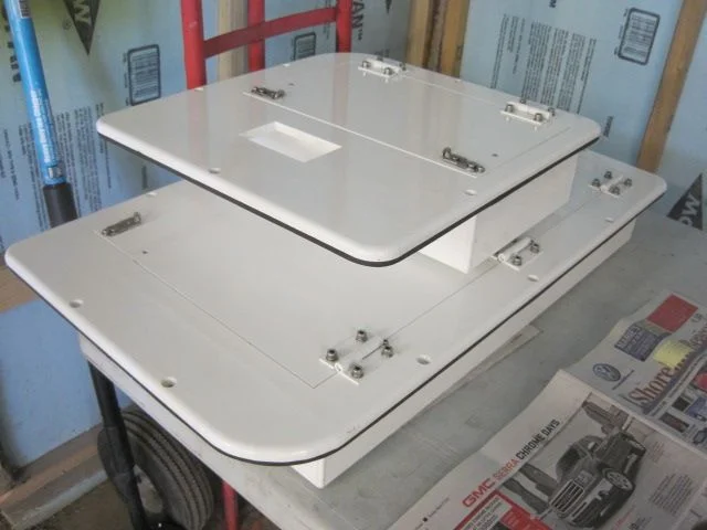

finishing touches on the storage boxes ...

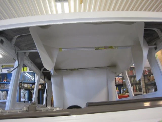

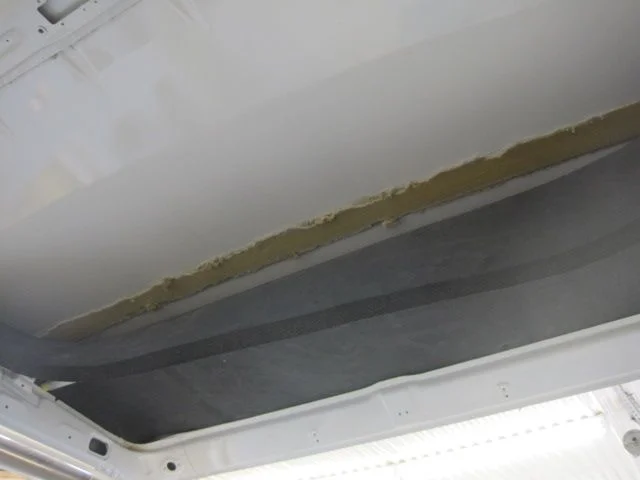

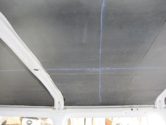

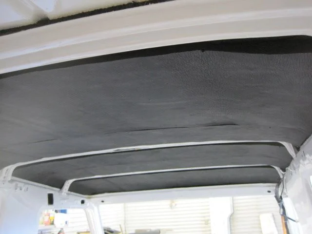

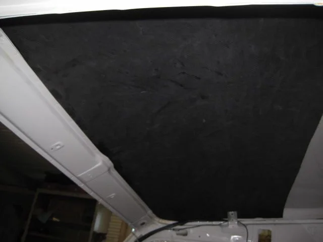

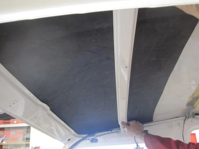

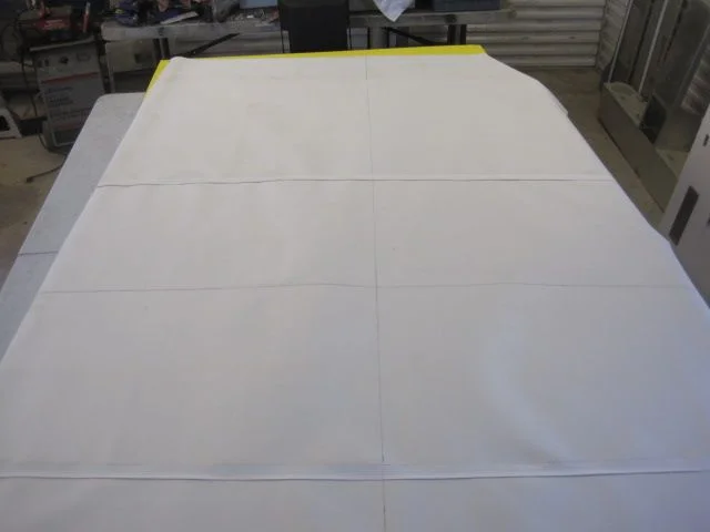

new head liner insulation installion
1" thick
shape
hang over rod
mark edge
spray adhesive to the line 1/2 the area
stick the back to the line
spray the front and dry and stick

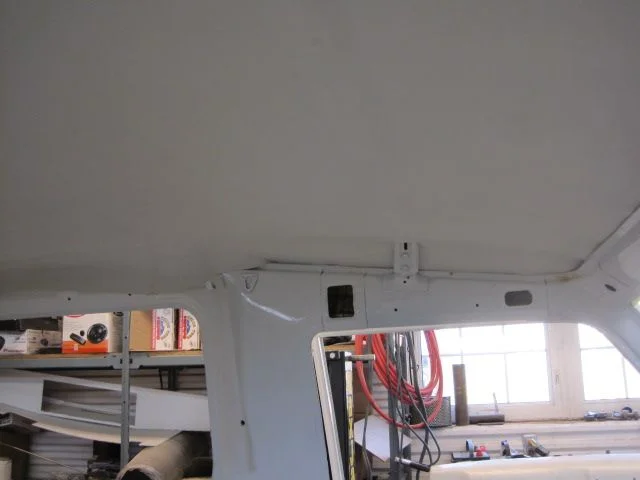

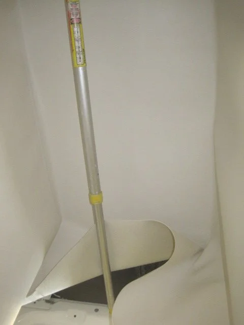

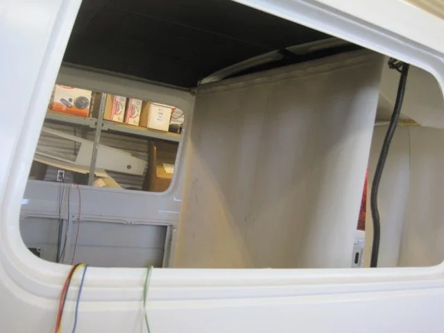

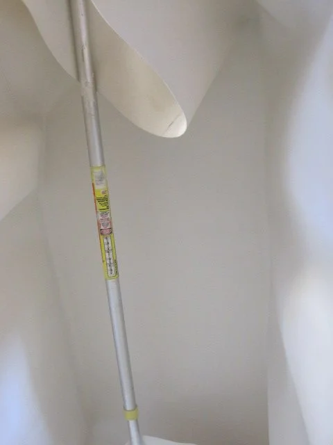

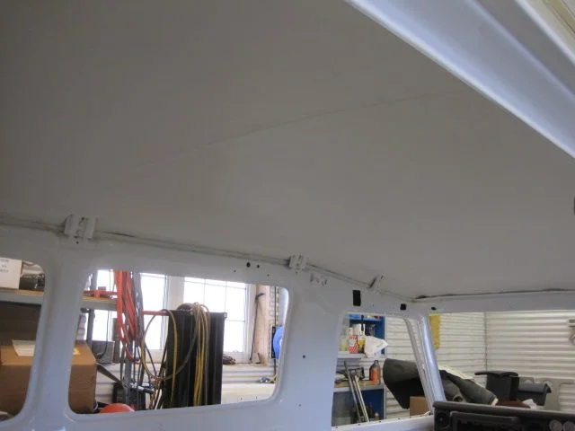

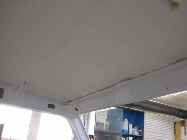

installation of the white liner cover
mark for alignment on the cover and the insulation
the stress is on the first 6 square inches.
mess that up and the whole top is screwed.

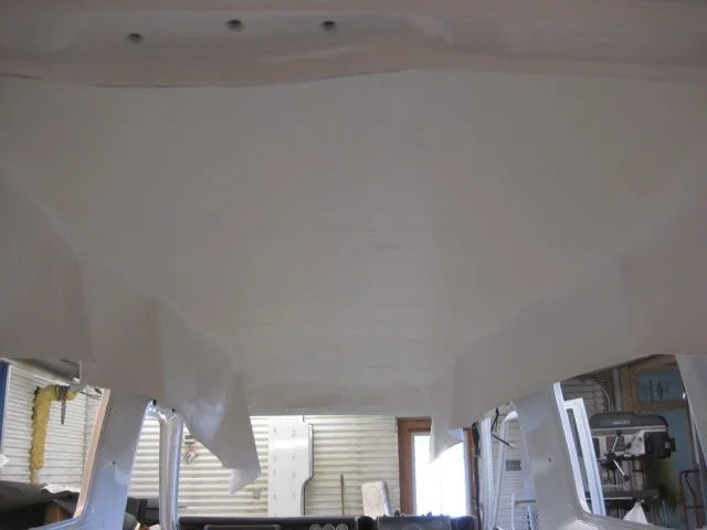

you do the center run first and fit the edges after...
