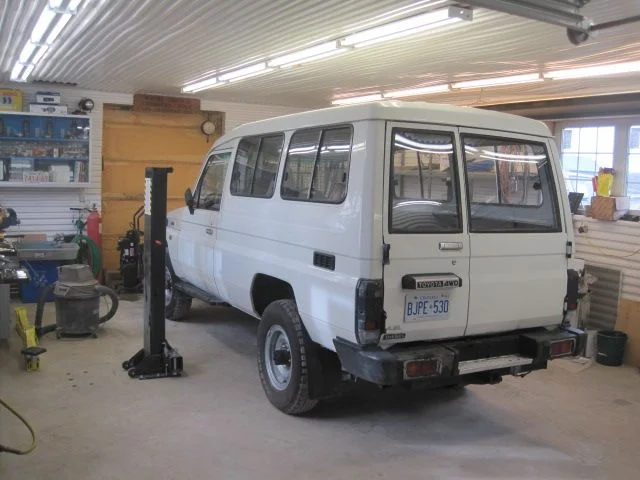

the old girl moved into the shop yesterday to get a 1.5" body lift.
since this is a very extensive build i needed the lift on to set up for the rear PTO winch, the proper height for the side bars, location of the top of the bumper, the front side bars and the location of the rear bumper and side step.
first things first.
here is a list of what is being done to the truck over the next few months::steer:

starting on the body lift:
