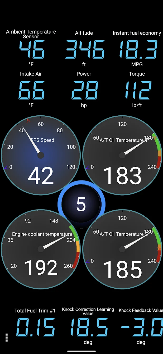

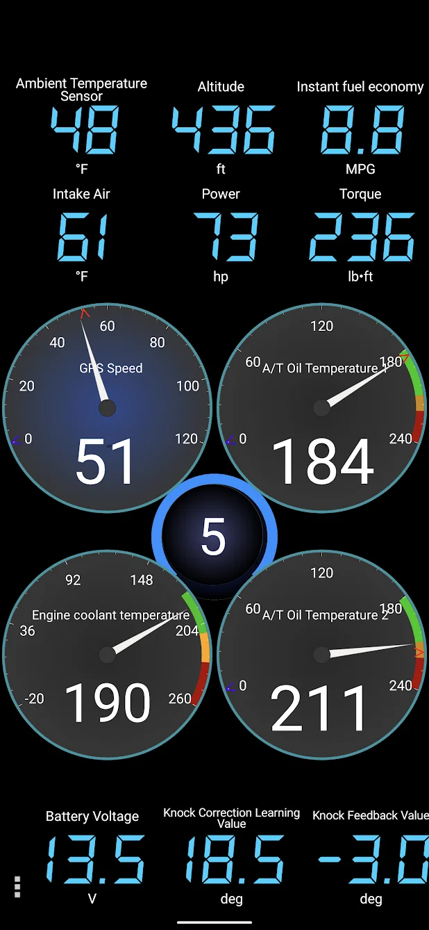

I've been trying to wrap my mind around the torque converter locking strategy. Seemed strange that it won't lock in anything but 6th when in "D". Did some playing around on this and I've found my car to lockup in 5th or 6th readily when in "D". I'm pretty sure I use to feel it lockup in 4th too. EDIT: New observations of locking up 4th in "D" here. Never did confirm prior with OBDFusion, but I can't seem to get it to lockup in 4th anymore, either towing or unladen, unless I'm in sport mode and selecting 4th. Prior to re-gearing that is.
So we see different behavior between your setup and mine. I wonder what a stock car would do. Anyone?
The difference in our cars is different tire diameters (34s vs 35s) and different diff ratios (4.88 vs 4.30), yours versus mine respectively. I wonder if this is a load computation difference that the ECU is seeing between engine rpm, wheel speed, and selected transmission ratio? If I had to guess, wheel diameter is not playing into this as the ECU is not referencing GPS speed. Just engine speed vs wheel speed, against the selected transmission ratio.
This may be an unintended consequence of re-gearing that it compromises the lockup logic of the torque converter?
You can see my transmission will lockup in "D" while in 5th, via the bolded blue horseshoe around the gear number.
I've been trying to wrap my mind around the torque converter locking strategy. Seemed strange that it won't lock in anything but 6th when in "D". Did some playing around on this and I've found my car to lockup in 5th or 6th readily when in "D". I'm pretty sure I use to feel it lockup in 4th too. Never did confirm prior with OBDFusion, but I can't seem to get it to lockup in 4th anymore, either towing or unladen, unless I'm in sport mode and selecting 4th. Prior to re-gearing that is.

I would reasonably assume the transmission might lock up in 4th or 5th if you're going slow enough that it doesn't want to go into 6th. I'm surprised to see you lock up in 5th at 51mph as I would think the truck would want to go to 6th gear at that point.

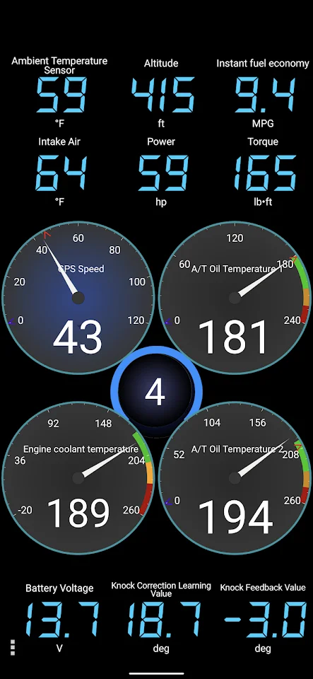

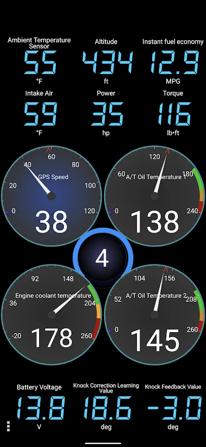

Funny enough, got her to lockup in 4th today on the morning commute.
Previously I was on a long road trip focused mostly on lockup with a 8k trailer. I did try without the trailer too, but perhaps didn't find the right conditions for 4th.
Got her to lockup readily several times, but it really needs a steeper grade, probably 6%+. I live in a hilly area and that was the ticket to getting it to lockup in 4th while in "D".
