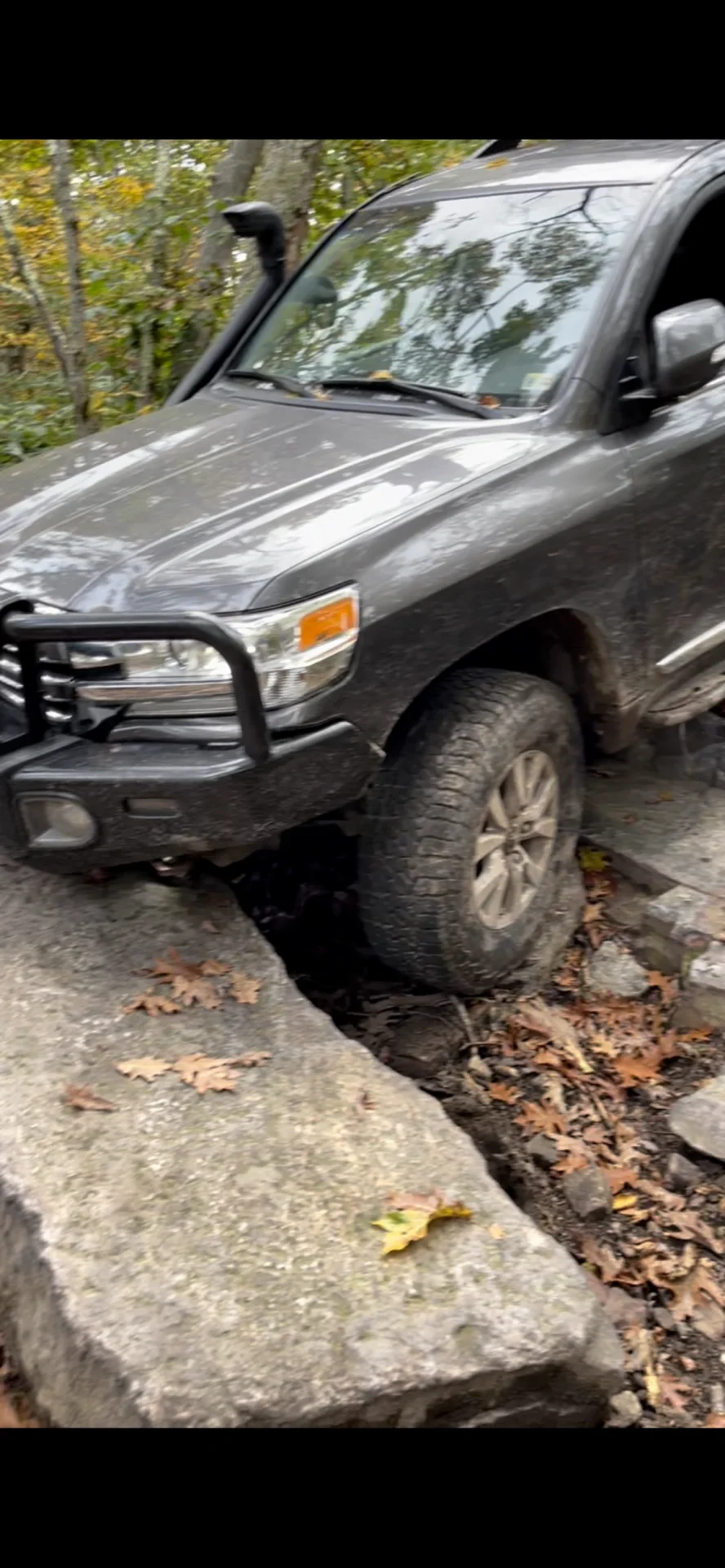

Never in a million years would I have thought that I would blow my transmission in my 200 series wheeling hard. Just installed lockers. Coming down a tough drop got stuck, bounced around a bunch of boulders. Driving home I noticed awful noises and transmission slip. I thought it my be something with my lockers or maybe even my transfer case. I have a 17,000 mile transmission for 2017 I found on car-part coming Monday so I can head off to the Red Clay Rally next week. Broke my winch cable too.
