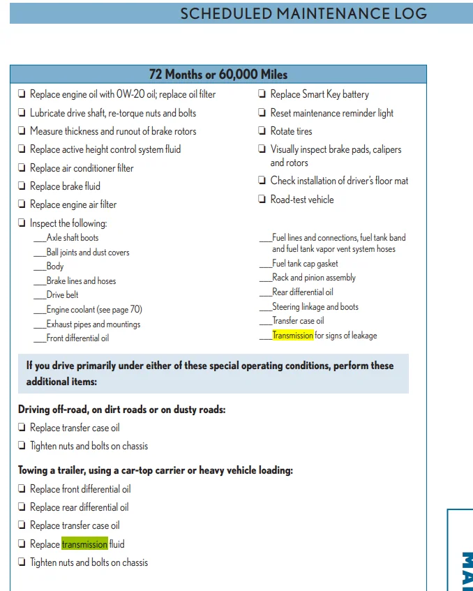

We should post correct info here. Here is what the manual from Mr. T says (same for 120k). They do not say "lifetime".
According to this there is no need to change ATF at 60 or 120 for a mall crawler. That’s the problem with relying on the manual.
Inspecting for leaks is a different matter entirely.
The interval is 6 years or 60,000 miles.. I think the lexus dealer is advising to change because it is over 72 months. This is consistent with what the CarNut says... IMO, it should be changed..

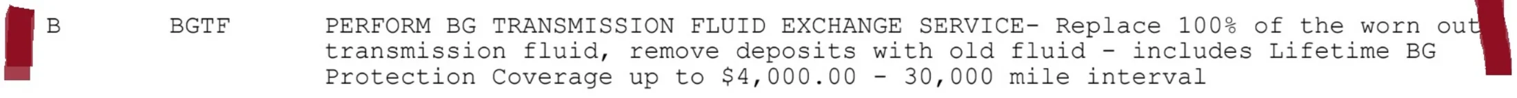

2017 LX570. I was surprised when scheduling my next fluid change the service writer saying Lexus recommended a full trans fluid flush at 30K. I don't see that anywhere online and was wondering if I'm just missing it or what. Any help is appreciated.
Not too unreasonable for a dealer estimate even with balance front tires. WS fluid is expensive and the labor to do a drain and refill per the toyota spec will take a few hours..I would go to an independent shop or do it yourself. I did it myself following the Toyota procedure from Techstream in 3-4 hours on my 2018 LC .
What makes you think the OP's dealer estimate included Toyota WS fluid? Here's what's on the estimate:
The name of the service is "BGTF" which I take to mean "BG Transmission Fluid."
The description of the service is "PERFORM BG TRANSMISSION FLUID EXCHANGE" which I take to mean that BG transmission fluid will be exchanged for the "worn out transmission fluid" which is currently in the transmission.
As a final observation: I would love to see the details of the "Lifetime BG Protection Coverage." My guess is, that the conditions of the coverage include the use of BG products - not Toyota WS.
HTH
Some good points.. I read BGTF as the fluid exchange service not the fluid.. Transmission – BG Products, Inc. - https://www.bgprod.com/services/transmission/
I would be surprised if they put anything other than WS fluid in an AE80 transmission since the warning in the owners manual is very specific. The procedure for an AE60 (6speed) transmission is very different from a AE80. The 6 speed is a flush by disconnecting one of the lines going to the radiator, while the AE80 is a drain and refill (3 times). My guess is they dont do many 8 speeds and the line item language on the estimate is for a 6 speed.. in either case, IMO, the fluid should be drained and refilled per the toyota procedure..
30k is way overkill, more like 60k if subjected to heavy usage. I would also be more concerned using BG fluid rather than the Toyota WS.

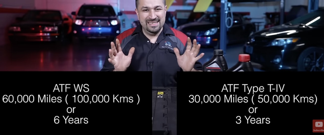

see this video from carNut on how to make you LC/LX last 300K+ miles..
