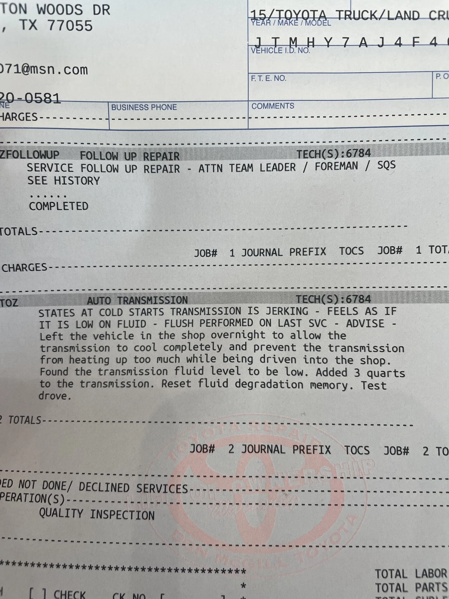

Here is a pic of the service report from today…
I would be pissed to have that explanation in my Toyota service record history. Sorry for that. The good news is that it appears to be okay. If the transmission acts a bit wonky over the next few months, at least you have clear documentation the fluid was 3 quarts low with barely anything in the pan while running, and you can press the dealer to replace the transmission.
I don’t know how Toyota dealer measures the new fluid when using the machine that cycles it through the fluid cooler. If they put 13 in, I wouldn’t think I’d have the problems I’m experiencing when “cold”.
the machine that we used was a 1-1 exchange, so if it was over filled or underfilled it wouldnt correct that condition. thats why we had to do a final fluid level check after the flush was finished.
