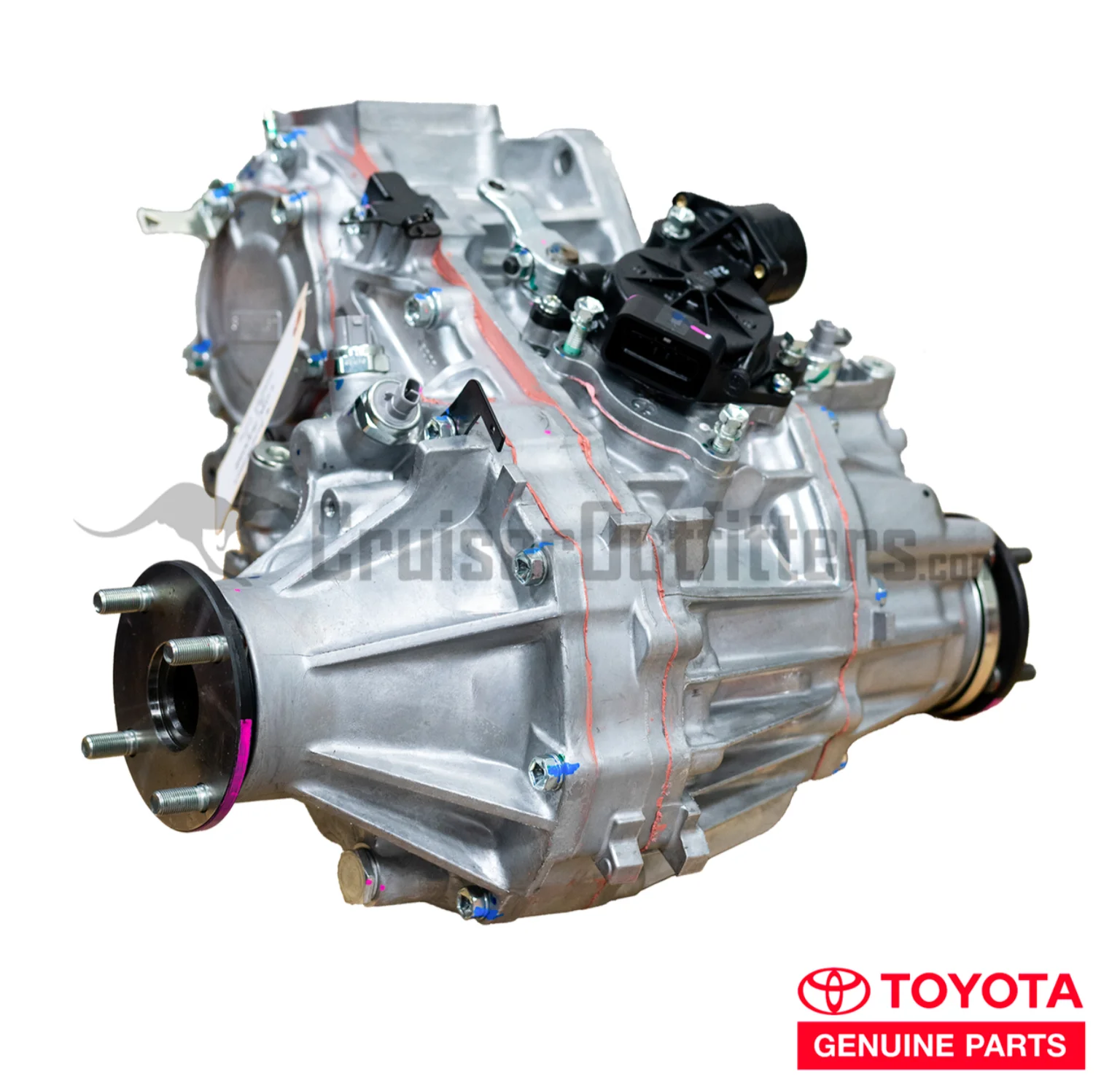

A. Even if it does need a t-case replacements (and that is a big if) $5k is waaaaaay over the top. We sell brand new OEM 100/470 HF2A t-cases, ready to bolt in, for $2450, $700 labor is high to do a Tcase R&R too. With a new case, it’s a 2-3 hour job.
B. From there. Find out what is bad about your case. Seals are not easy to do in this case compared to the earlier 1-pc and split cases. $700 labor is a fair price to pay to have the seals swapped on a case.
Now, if they opened the case to replace a seal and found some damaged (again unlikely) parts, it could need replacement. Used cases are avail, ~$200-500, rebuilt ~$1000-1500 or new as I mentioned $2445 w/o CDL actuator or $2795 with the CDL actuator. Depending on your mechanical skill, they are not hard at all to swap and we have step-by-step instructions and access to our part engineer that builds and installs these daily.
