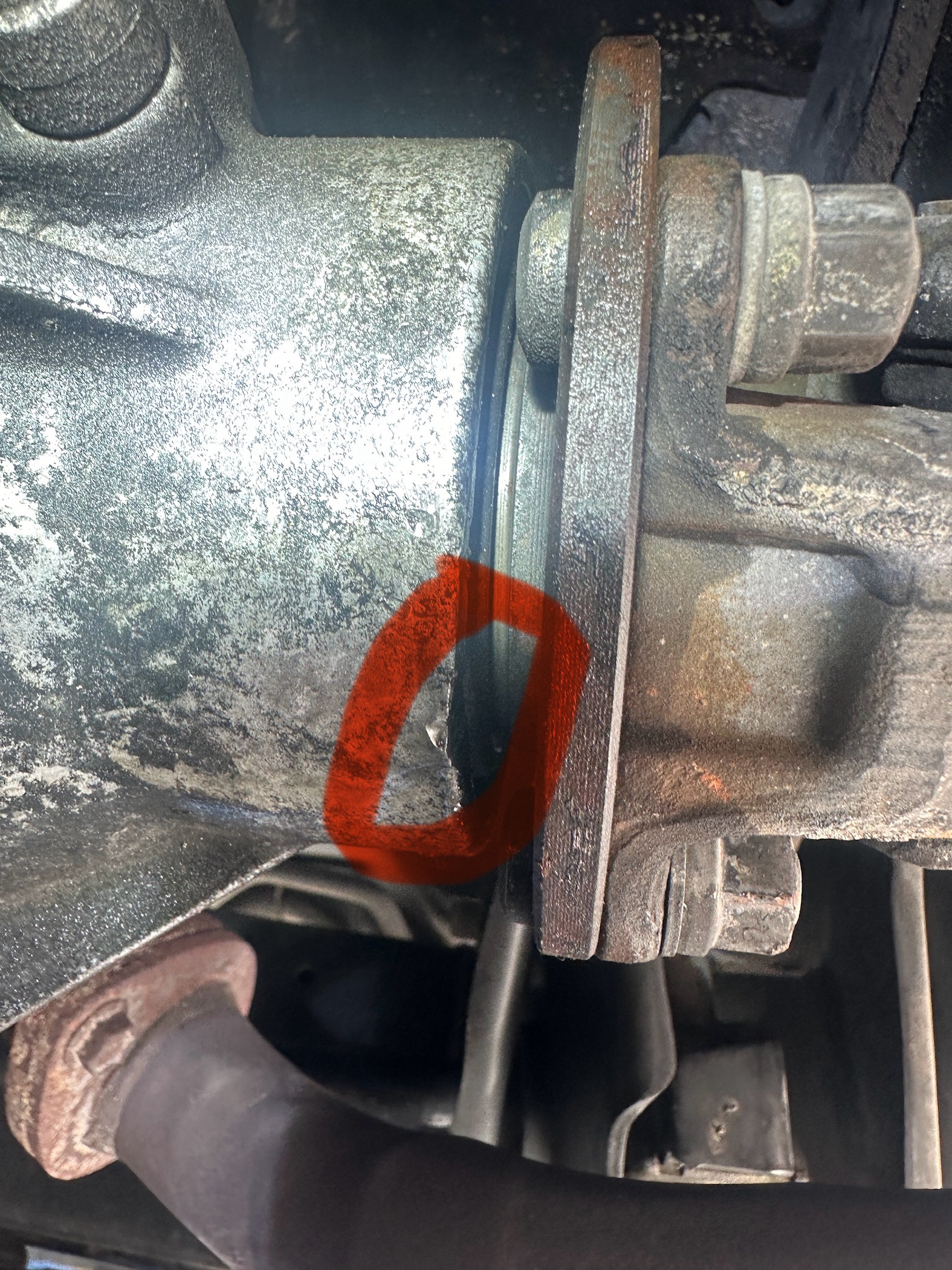

For some closure, we were able to get the truck in today for another look, unfortunately it came in on a tow truck with a no-start.
(I was on vacation during his initial appointment so I had not seen the truck previously)
My guys got it running and as expected, the transfer case is most likely fine other then the previously noted loose output bearing and oil leak. We did note the new noise that was stated by customer and other shop but we are thinking CV or U joint or something along those lines, we did no further diagnostics though.
Both the owner and I are pretty sure the other shop just wanted to scare him off - understandable this truck needs a lot and these can be risky for a shop to take on. There are more professional ways to decline a customer though.

My guys got it running and as expected, the transfer case is most likely fine other then the previously noted loose output bearing and oil leak. We did note the noise that was stated by customer and other shop but we are thinking CV or U joint or something along those lines, we did no further diagnostics though.

UPDATE: Against better judgement, I have been unable to bring myself to get rid of this truck. But I finally figured out the noise. Turns out it was coming from the transfer case after all. We knew it had play and was weeping in the rear output, but thought the noise was coming from more of the front of the vehicle. However, I found a shop to lift it and run it in the air, and we were able to quickly see that the noise was coming straight from the rear output bearing (see video) Also we noticed a chisel mark near the rear output... (see photo)
I still would like to fix this.. but it's beyond my DIY capabilities, and I have recieved some wildly different quotes on it. Anyone have a rough idea of what to pay for a t-case rear bearing and seal job? And other "while youre in theres" to try to do at the same time?
$350-1500-$3000. That’s the range from rear seal/bearing with only pulling the tail housing or a full R&R with all new bearings/seals in the entire case, or a complete a new t-case assembly.
I think we typically charge 4-4.5 hours for that job - So about $750-900 with parts/fluid? We certainly have done that one serveral times here andshould have prewritten quotes. That being said, I wouldn't say that is a typical noise for that bearing at all from my experience
