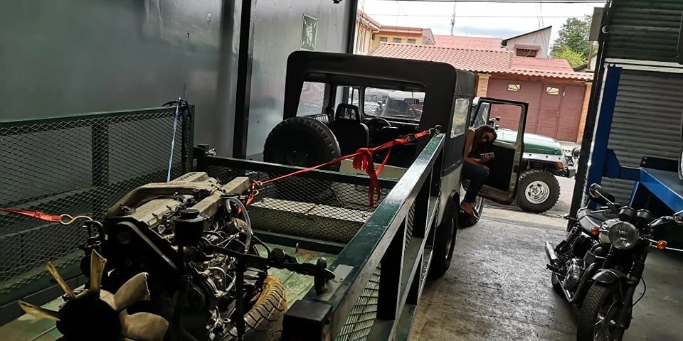

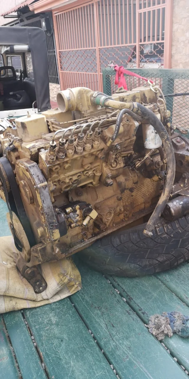

2/Feb/2019 - Towed the 6BT with the BJ40.
1907434
1907435
1907445

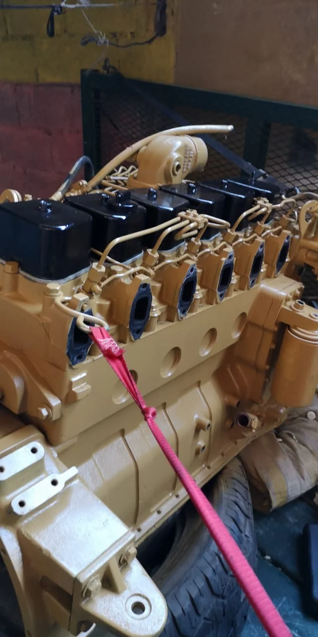

This engine came out of a '98 Thomas School Bus, the owner removed the air pump for me.

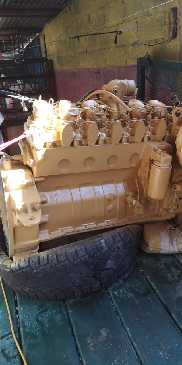

14/Feb/2019 - Painted - Yellow Caterpillar.
1907442
1907444
Updates will be happening along the conversion.

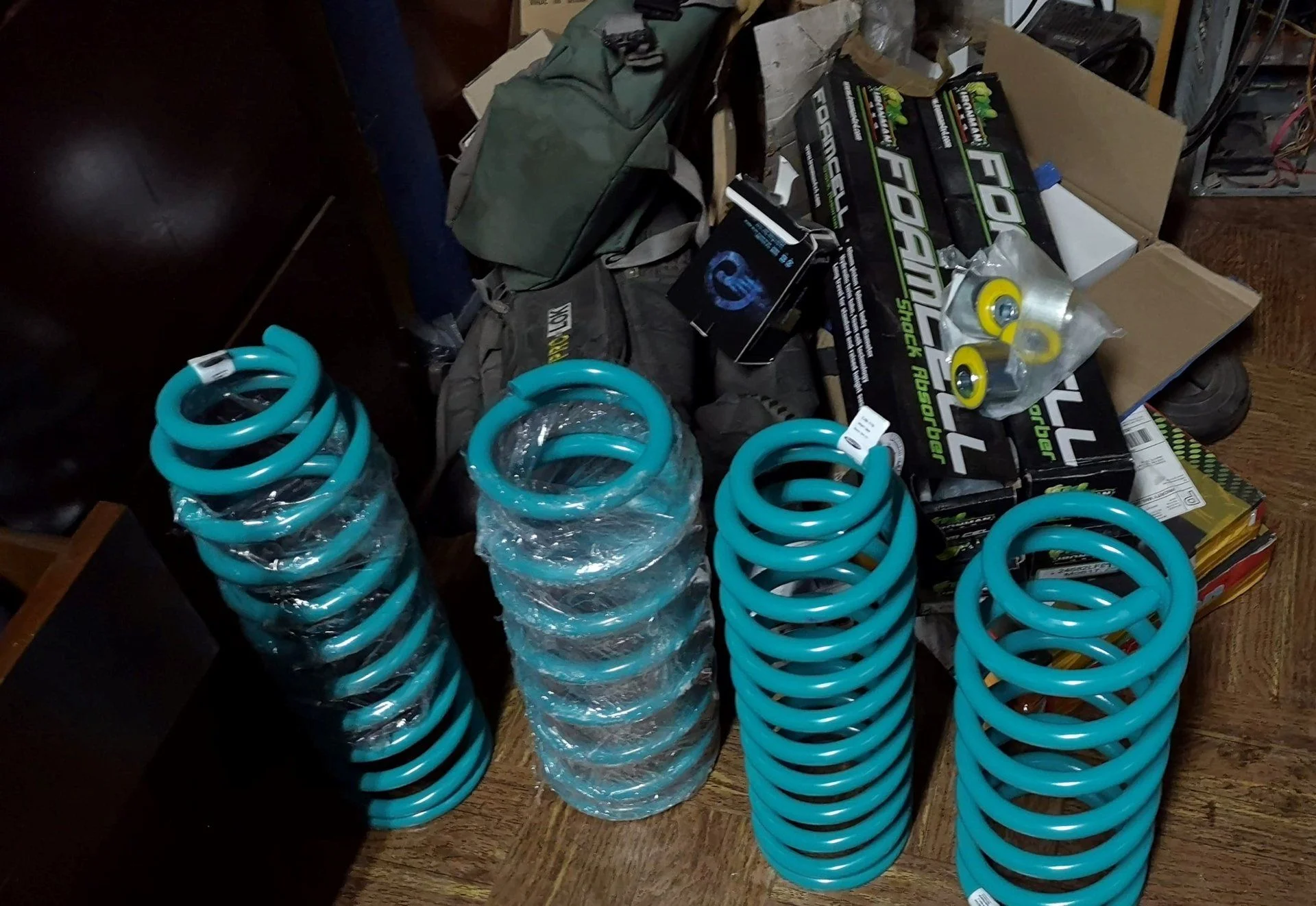

3 inch TJM coil springs, Iron Man Foam Cell shocks and OME caster corrector bushings

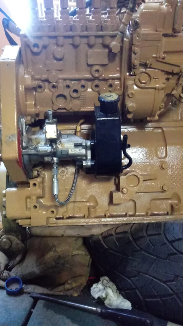

I got the Power Steering Pump and Vacuum Pump from a Dodge:
1961921

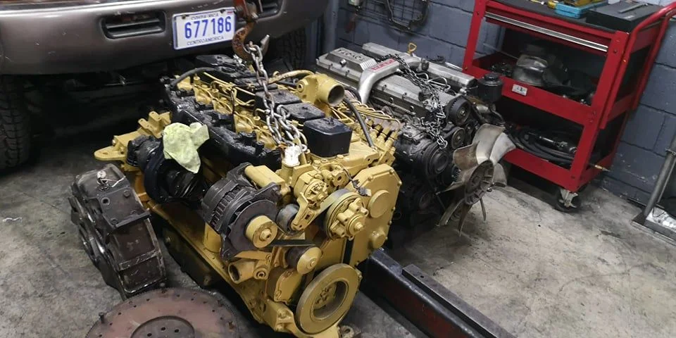

I made a size comparison and the 1HDT looks looks so small next to the 6BT.
1976470
1976472
1976486
Took my 1HDT back home will work on it after all this.
We are working on small details on how to put the 6BT inside, we need to cut the cummins housing and leave it as a "Flanger" to adapt the Toyota's housing in there.
Cummins housing has 2 engine mounts which collide with the 80's firewall, so they need to be cut.
We will need to use the 4 bolts side engine mounts.
