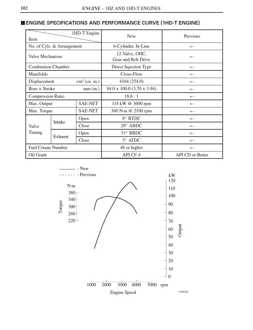

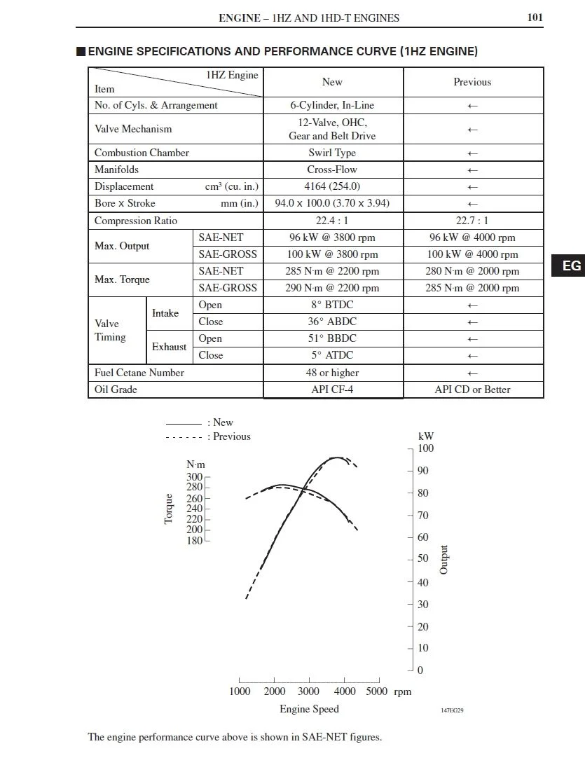

Here are the specs for the 1HDT and 1HZ camshafts:
1hd_power-jpg.1353496
1hz_power-jpg.1353497

So basically, the lift difference is on the intake only and is about 0.65mm more with the 1HZ cam. And from the specs above, the 1HZ has 7 degrees more duration on the intake, but the exhaust is the same.

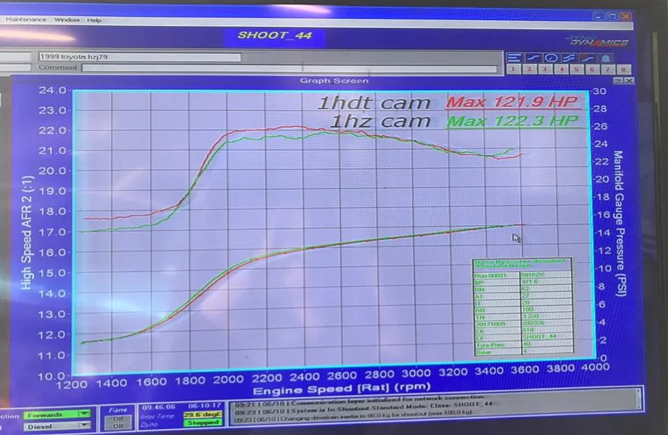

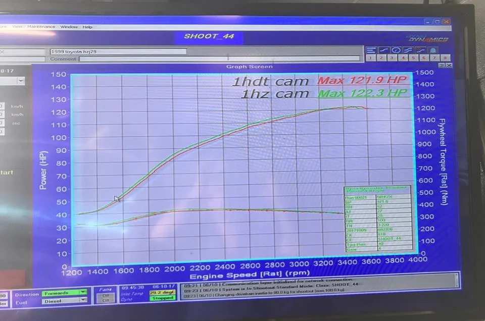

I think the same... And as Greivis posted the difference of 1HP between the 2 camshafts, I think that if you push the engine with some boost, intercooler and diesel, the differente of HP will increase between the 2 camshafts.
Update...
2 Years running the 1HZ cam on the 1HDT motor, still running like a champ.
