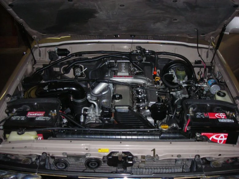

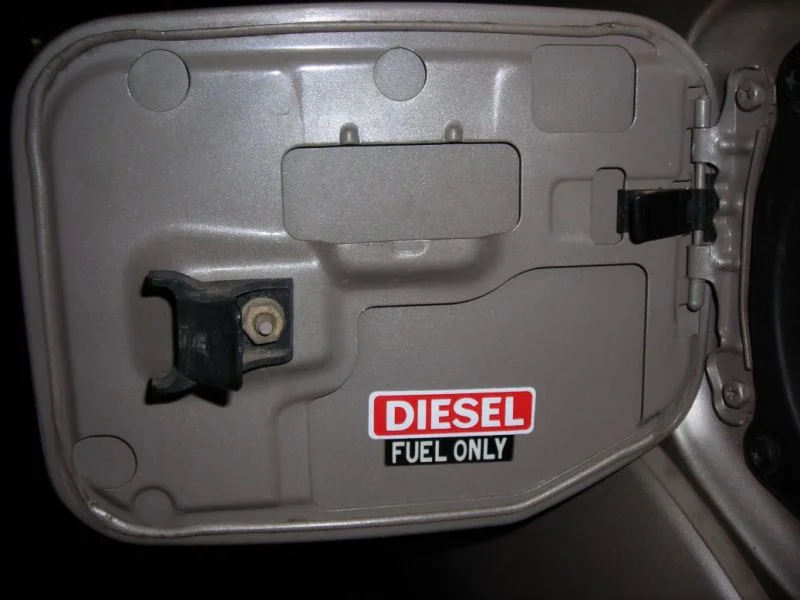

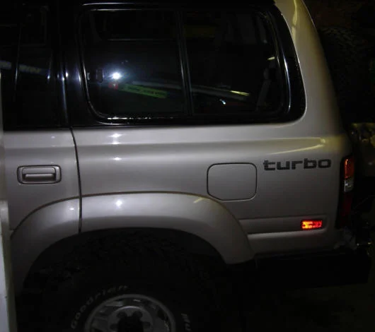

    Since we're all pimpin the swaps...
    91 FJ80 swaped to 1HD-T A442F. Combined project by G&S Cruiserparts and Ciaran Wilson of Cruiserland Enterprises.
    Disclaimer:
    No Armorall was harmed in the photograph of this engine

    That oily patch on the sound proofing fawks the whole thing:D
    Just joking:grinpimp:
    Did you change the heater hose valve to a 1HZ/HD unit,was it hard to get off?
    Is the fuel filter in its stock location. I might have put it over on RH side near the firewall like a 75 ,lotsa room there;)

    Nice clean install guys! We've done 3 80 swaps but try to stay away from them as the front clips are ungodly expensive. Actually in excess of $10,000. Did you just get the engine and adapt it or what? -Todd

    Hehehehee! Had to leave a little something to remember the ole 3FE by.
    The heater hose valve is 1HD-T unit. Not too bad to get off.. a small screwdriver and some WD40 helps.
    and ya.. that is a stock fuel filter assy/bracket right where it should be.
    Sheldon

    We Half cut a mid 91 production HDJ81 in Japan and shipped it over in a big ole box. Ungodly expensive is right. A lot of hours go into making everything as factory like in function and look.
    Sheldon

    70sGuy,
    That is an awesome swap. I am planning on doing the exact same thing to my '94 FZJ80, keeping it as stock as possible. I plan on eventually running BioDiesel.
    I have a few questions though:
    (1) I already have an A442F in my truck, will a 1HD-T mesh to my transmission or is the HDJ A442F different in some way(s)?
    (2) I also want to keep my ABS, will the ECUs for the deisel integrate smoothly with my domestic ABS ECU?
    (3) Finally, can any of the ECUs (ABS, transmission, differential) from the FZJ be used interchangeably with the ones from the HDJ?
    Any help you can give me will be greatly appreciated. And for now, I will just continue to envy you while I remain in the planning stages.

    A b series engine would be too small. An H, not much better.
    I think the 80 is too heavy for those little engines. The heavier HJ61 is powered by the 12h-t if has the grunt.
    One thing you also have to look at is if your jurisdiction allows older engines in a newer chassis. Most won't. Has to be newer or same date as the chassis.
