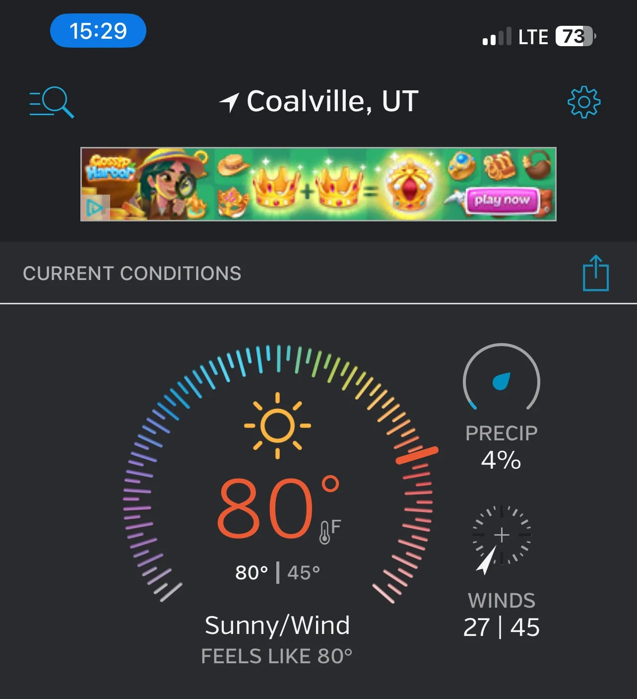

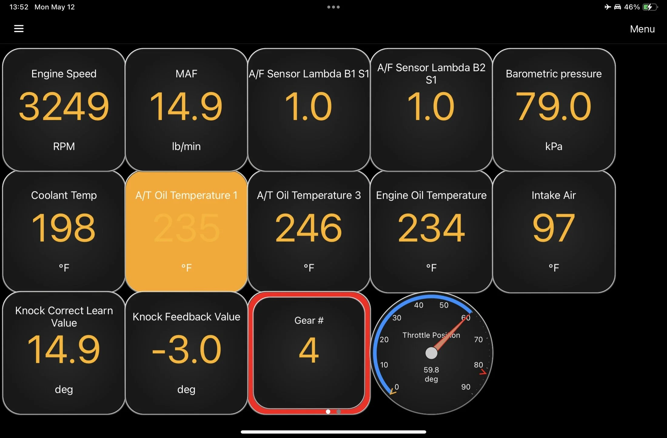

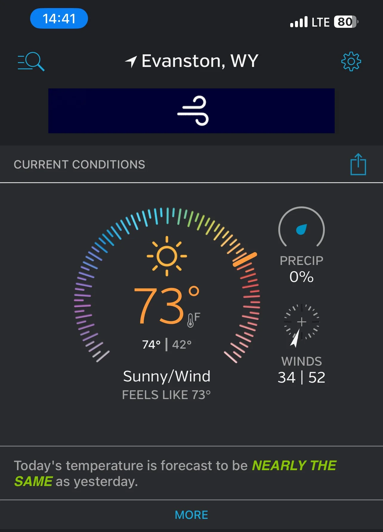

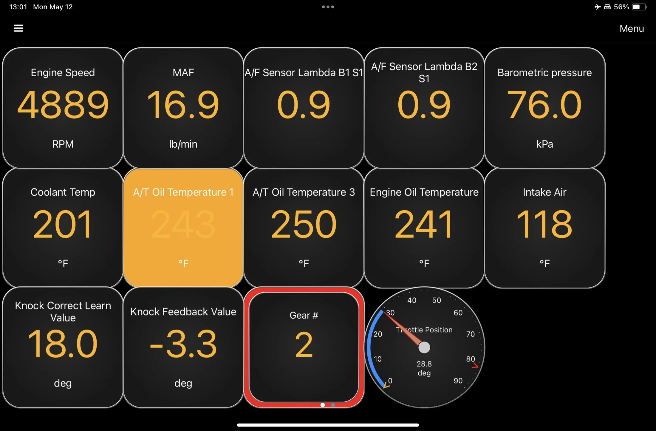

I was up in Teton NP last weekend and came home Monday. Probably one of the least enjoyable towing experiences I've had over the years and managed to get some of the worst sustained gas mileage I have ever had. On one 122 mile stretch from Afton WY to Evanston WY I averaged 6.45 mpg hand calc'd. Dash said 6.0 because of the tires(315/70's) which works out to ~6.5 correcting for the tire size. Winds were blowing right in our faces pretty much the whole route sustained at mid 20's to mid 30's and gusts into the 50's.
This forced me to run in 4th and 3rd gear(with my 8 speed) for long stretches because I was needing 150-170 hp to maintain 55-60mph. Since the TC unlocks 100% of the time in the 8 speed in any gears below 5th, this was causing my transmission temps to get pretty hot. This screen shot is just from driving on flat ground somewhere around 55-60 mph with maybe some slight rolling hills.
Another gem climbing a pretty steep grade(10% in some spots) after extended 4th gear on the flatter ground leading up to the hill.
Overall it sucked. I could really only do 55-60mph without causing the transmission to heat up beyond 230F on the flat sections of road.
View attachment 3907642View attachment 3907643
Thanks for sharing. The struggle must have been tough! What app are you running for that data? I have OBD Fusion but it doesn’t given any of those detailed temps. Maybe there is another paid tier I’m missing.

5500 lb GVWR. The aero drag is the biggest issue, not necessarily the weight. My GX460 would tow a 5500 lb dump trailer at 70 mph without much issue but really stuggled with my 5500 lb travel trailer
Ill put the towing conditions in UT, ID, and especially WY up there with some of the toughest places to tow anywhere, and I dont just mean in the US. The elevation, temperatures, winds and posted freeway speed limits are an epic combo.
OBDFusions twin, OBDLink. You need to download the enhanced diagnostics package for your model year and it should give you the extra PID’s
Ah ok. Love having to pay for an app only to pay more for what I actually want:)
If you have an OBDLink Bluetooth module, then you can use there app and get one or two of the enhanced diagnostics packages for free. Thats why I use it. At the time I bought my module, OBDLink was one of the few making an iPhone compatible Bluetooth module
