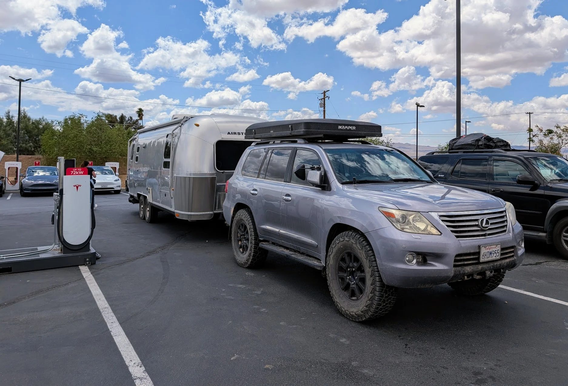

What an epic 3k mile road trip through Death Valley, Valley of Fire, Zion, and North Rim Grand Canyon.
The 37s have won me over. Gas mileage has suffered a bit more. But she still hauls the mail and does the business. Tires earn their keep for the added comfort and capability offroad.
Hung out with some Tesla's, they were amused.
