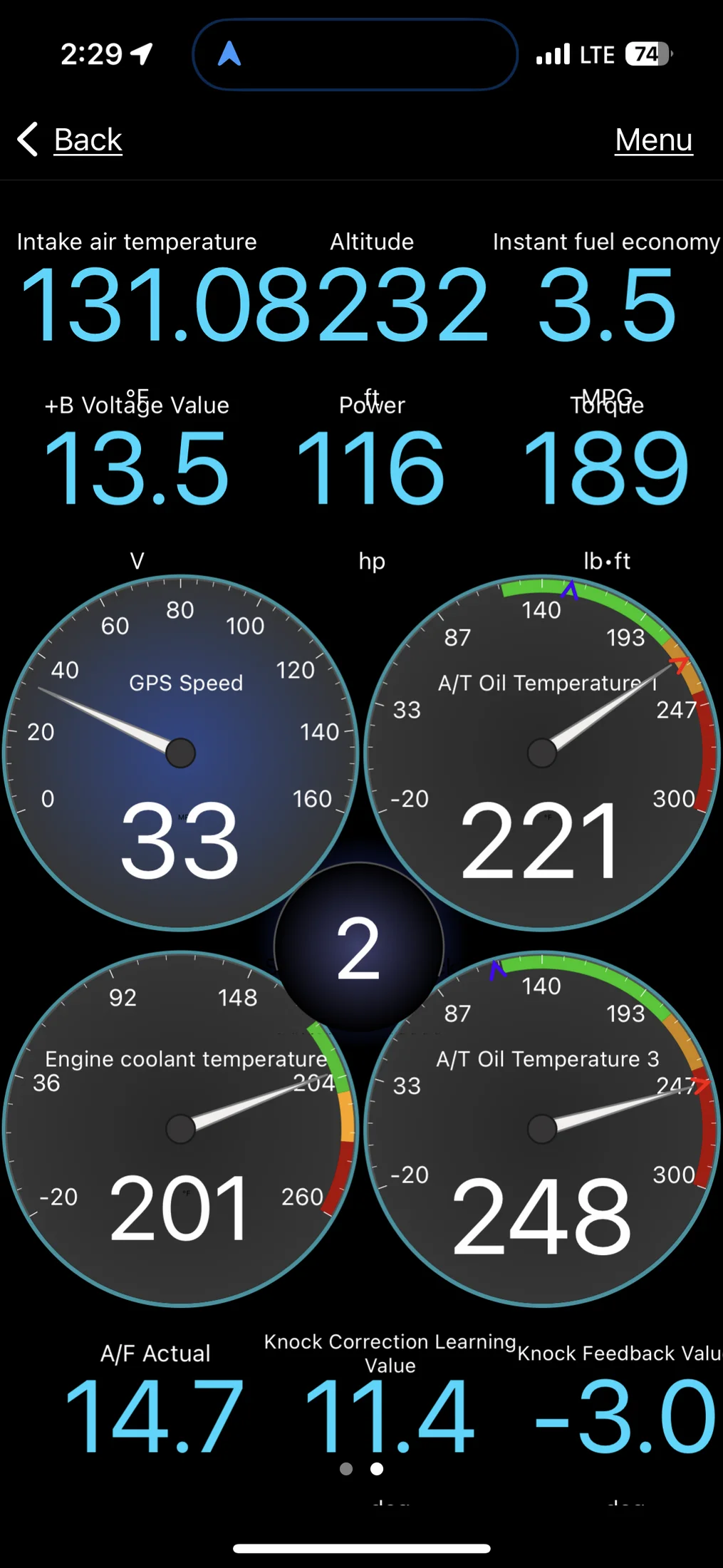

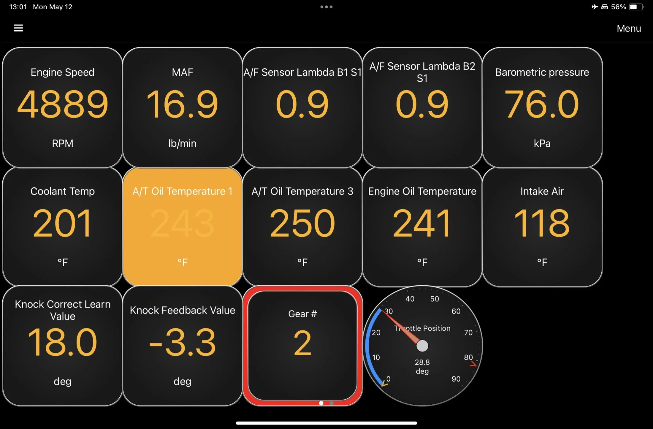

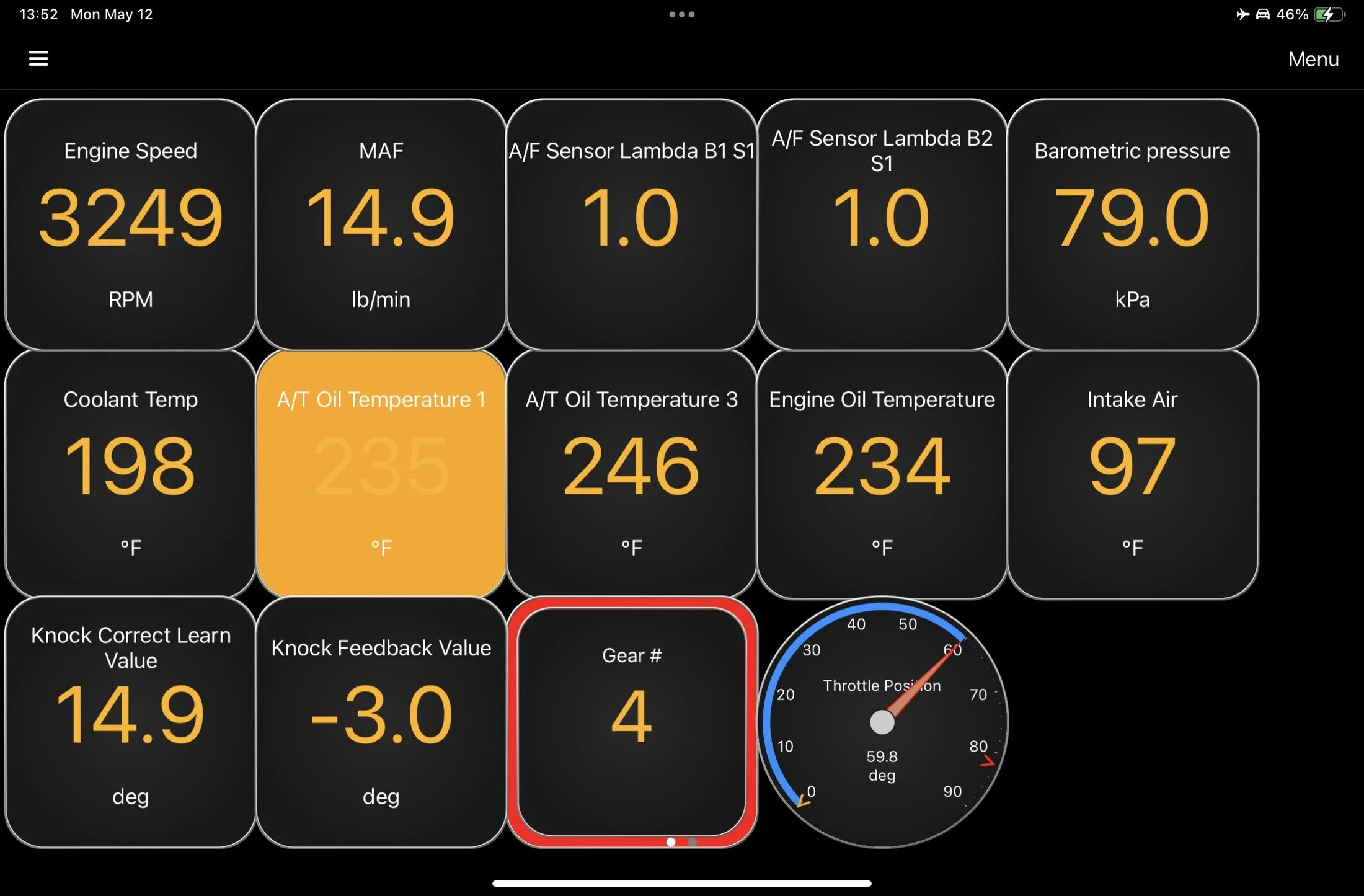

I was up in Teton NP last weekend and came home Monday. Probably one of the least enjoyable towing experiences I've had over the years and managed to get some of the worst sustained gas mileage I have ever had. On one 122 mile stretch from Afton WY to Evanston WY I averaged 6.45 mpg hand calc'd. Dash said 6.0 because of the tires(315/70's) which works out to ~6.5 correcting for the tire size. Winds were blowing right in our faces pretty much the whole route sustained at mid 20's to mid 30's and gusts into the 50's.
View attachment 3907642View attachment 3907643
This forced me to run in 4th and 3rd gear(with my 8 speed) for long stretches because I was needing 150-170 hp to maintain 55-60mph. Since the TC unlocks 100% of the time in the 8 speed in any gears below 5th, this was causing my transmission temps to get pretty hot. This screen shot is just from driving on flat ground somewhere around 55-60 mph with maybe some slight rolling hills.
Another gem climbing a pretty steep grade(10% in some spots) after extended 4th gear on the flatter ground leading up to the hill.
Overall it sucked. I could really only do 55-60mph without causing the transmission to heat up beyond 230F on the flat sections of road.

Converter at 230° is an attention grabber, 245° I’m considering options. Those 2nd gear converter lockup climbs are my least favorite.
That’s some decent engine oil temp as well as coolant. It’s extremely rare for my coolant to get over 191°.

I’ve had similar experiences. Usually higher ambient temps though. My worst was about 5.5 mpg adjusted. Yes you read that right. 6 speed but I was basically in 3rd or 4th a bunch of the time to hold 60 in some heavy crosswinds. Being regeared I can normally run in 5th.

Thanks. I’ve hit the 240° range in the converter pulling 5-6,000 pounds but only on steep grades like Douglas pass in Colorado:
I’ll maintain in the low 200°s with a 15-25 MPH headwind @ 65-70 MPH through central Utah (not like what you just had). I’ve recently added full skids and so we’ll see how much that affects temps this summer. My guess is it will be noticeable.
Sure, the transmission and everything can take it but the ATF change interval certainly shortens.

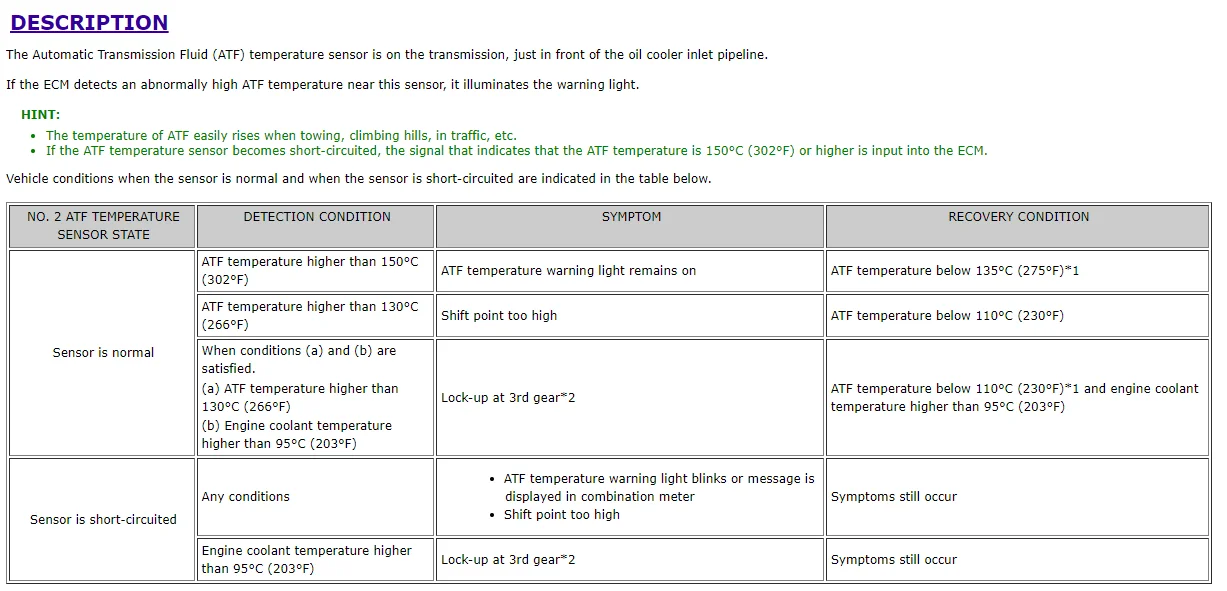

Personally, those transmission temps are fine and nowhere near the danger zone for modern fluids, even for extended legs. Towing is work and demands hp which create more load and heat. Slowing down is always a reasonable option but there's already compensation logic to protect from the real temps that destroy fluid and hardware. It can get to a point that the computer will aggressively lockup in low gears, all the way down to even 2nd (in my 6-speed) where temps will moderate significantly. And sure, you'll want to be on the severe duty service interval with significant towing. You can add a secondary aux tranny cooler, which I did not so much for this situation, but for extended climbs towing 8k lbs. That won't solve the MPG efficiency though as lockup is the key factor there. Yet lockup (or the lack thereof), is a tool the transmission uses to create more gearing (as demanded by the gas pedal) even in gear if that makes sense. The added slip is an intermediate gear between physical gears.

This is slowed down. I was doing 55-60mph in 65-70mph posted zones because I didnt want the transmission temps consistently above 230F.
And yes, the tires are like 8% larger, but that doesnt mean I could have run in 5th gear had the stock tires been on. I was in 4th, bordering on needing to be in 3rd.

I was just looking in VFTuner and it looks like it enters transmission hot mode when the ECT is >98C and Trans fluid temp is >125C.
Well, I just flashed a tune to lock up the TC in 4th gear. To late tonight to take it for a spin but I will try tomorrow and report back with more details.
No luck. But there are like 12 lock/unlock tables for different conditions and just driving around town I was having trouble getting the transmission temp above 150F. I wonder if it was stuck in "cold shift" mode and I simply edited the wrong table.

225 sustained is fine for synthetic dexron 6, WS and others,,,,sustained 250 is right there at the flash point....beware. intermittent at 250 is ok
