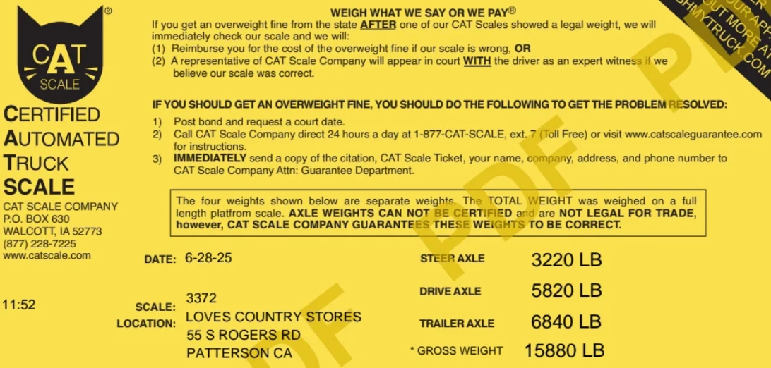

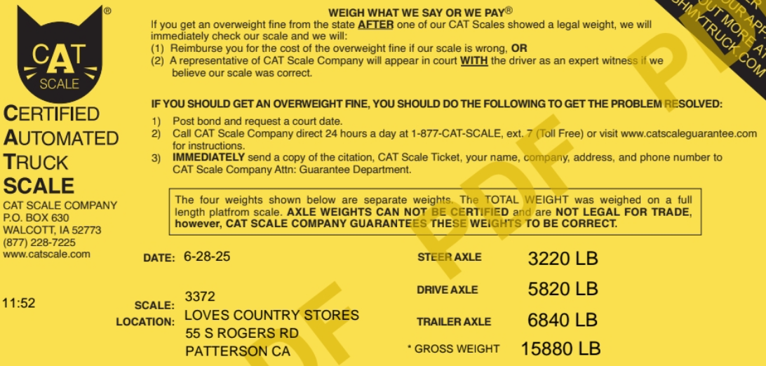

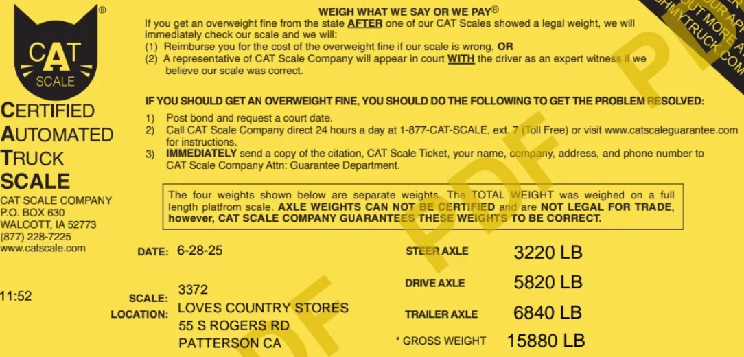

Wee bit fat this trip. Probably the heaviest I've been. Drives great and shrugged off 400 miles today easy.
I’m suddenly feeling much better about my heavy rear end, you’ve got 800lbs on me. It’s Impressive what these trucks can do.
Surprised to see so much weight on the rear axle of the LX570 (front 3220 and rear 5820lbs). I would have expected your WDH together with around 1200 lbs tongue weight to have values more in the order of 3220 and around 4500lbs. Must be those gold bars you are carrying with you in the boot... Or the WDH being useless... ;)
:popcorn:
:popcorn:
I'm not shocked. I was at 3440 front and 4140 rear when I weighed last fall. I had some camping gear in the back but no more than 100# extra. My last trailer weight was 3320 front, 5520 rear, and 5560 trailer. That weight included 3 additional passengers (350#+) and a rotopax of fuel on the roof, plus the 100# for the WD hitch and bars. I can't recall what else I had... maybe some extra drinks in the cooler, but nothing crazy. The trailer had at least half a tank of water in the tank IIRC... We were on our way to Banff
The best weigh ins are done back-to-back, but I rarely want to spend the time unhitching to get the truck weight at that moment. @TeCKis300 probably has done one. I probably should as I think my trailer tongue is getting heavier
Take a trip up to Glacier Nat Park and we can use my hitch to get your tongue weight :cool:
I was up here there in 2021. Such a beautiful area.
Another member in here loaned me his Shurline tongue scale back in 2018 when I bought my trailer. At the time the empty TW was 780# with propane and battery on the tongue. I’ve since moved the battery inside under the fridge, but the trailer also has a lot of gear in it, and in the above example I also have probably 200# of water in the fresh tank in front of the axle. That was my heaviest weight and I bet my tongue was 1200#. Normally it’s probably 950… a more typical weigh in has my rear axle and trailer axle combined are 650# lighter
Practically i could unhitch on a scale, and also weight each individual trailer axle. It just takes time and when I’m doing 30 hours across the country I don’t want to spend the extra 20 minutes.
TBH sometimes I question how accurate the CAT scales really are anyway… I know they’re supposedly certified but I’ve had a very similar setup for years and as in this case Infind it hard to believe 20-25 gallons of water added 200# to my tongue and 450# to my trailer axle over my prior weight.
