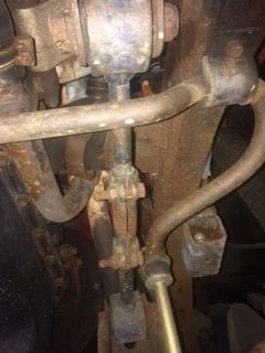

Hello everyone I recently installed an old man emu Shocks and leaf springs front and back kit on my 1984 Toyota pick up I had to remove the torque rod to be able to drop the front axle enough to install the leaves now it’s really difficult to install the torque rod back I zip tied the torque rod as an example to show how little I’m off to where the bolt can’t slide in place. Any tips?? Should I buy a slightly skinnier bolt? Any suggestions will be much appreciative thank you

Two ideas.
1- Put the axle back on jack stands and loosen the spring u-bolts. That might give you enough to twist the axle into place.
2- Looking at that I think if you support the frame on jackstands and lower the axle that hole might line up with the axle lower a bit.
What I’ve done to get lifted 80’s back together after doing caster correction...
If you have a spare bolt thats the correct size, turn a fairly steep, but rounded, taper onto it with a bench grinder. Using it as a draw pin, tap that bolt through the back side to get everything in place. Toss a ratchet strap around things to hold everything together. Then use the correct bolt to drive out the modified bolt/draw pin. If your taper is sharp enough, the correct bolt will be partially in place before things get a chance to come out of alignment.

Two ideas.
This should allow you to get the bolt back in. I had this same issue after installing new leafs on my 85 pickup and couldn't get the track bar back into place. I jacked up the truck and put it on jackstands and messed with the axle height to get it lined up. Worked great.
Next time you do this I would make an effort to re grease the bushings as that would help some.
Sorry guys, but I gotta disagree with using a smaller bolt or forcing parts that are 1/4" off to line up. Under normal operation, the torque arm moves and the smaller bolt will begin to cause wear which leads to noise and failure of either the bolt or the steel bushing. Forcing things to line up will eventually lead to premature failure of the rubber in the torque arm bushings.
There's a steering arm mounted to the steering knuckle. One end of the drag link connects to it while the other end connects to the pitman arm on the steering gearbox which of course mounts to the frame. This means axle housing movement in the form of rotation under braking will have a direct effect on the pitman arm.
This rotation is prevented by the torque arm which connects the axle housing to the frame. Without it, the steering goes left when braking heavy; especially in an emergency situation where speed is a factor. Try going just 20 mph and slam on the brakes to experience this before it happens in an emergency.
The torque arm also prevents the leaf springs from wrapping into an S-shape under high torque situations. Spring wrap becomes more pronounced when lifting blocks are used between the spring and axle housing. Force times distance. That's where traction bars or ladder bars come into play as well.
After changing the caster angle via 3 degree wedges between the axle housing and leaf springs which gave a 3" lift, I had the issue with the torque arm being too short. My solution was to cut it in half and cut another 1" or so from the length of one. Its diameter is that of a 5/8-18 thread. I used left and right hand die nuts along with oil to thread the ends. I then bought a '85 Buick Regal tie rod adjusting sleeve from Autozone (part # ES2032S) to complete the assembly.
