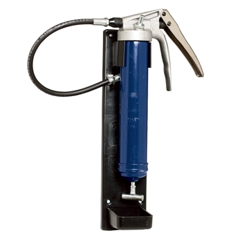

I want a couple of these for the garage.
Grease Gun Caddy
Photo from Gemplers
NMuzj100,
Thanks for the good info. Btw, I'm going to have to get one of those grease gun holders... that's the exact same Lincoln grease gun that I have too... love it!
