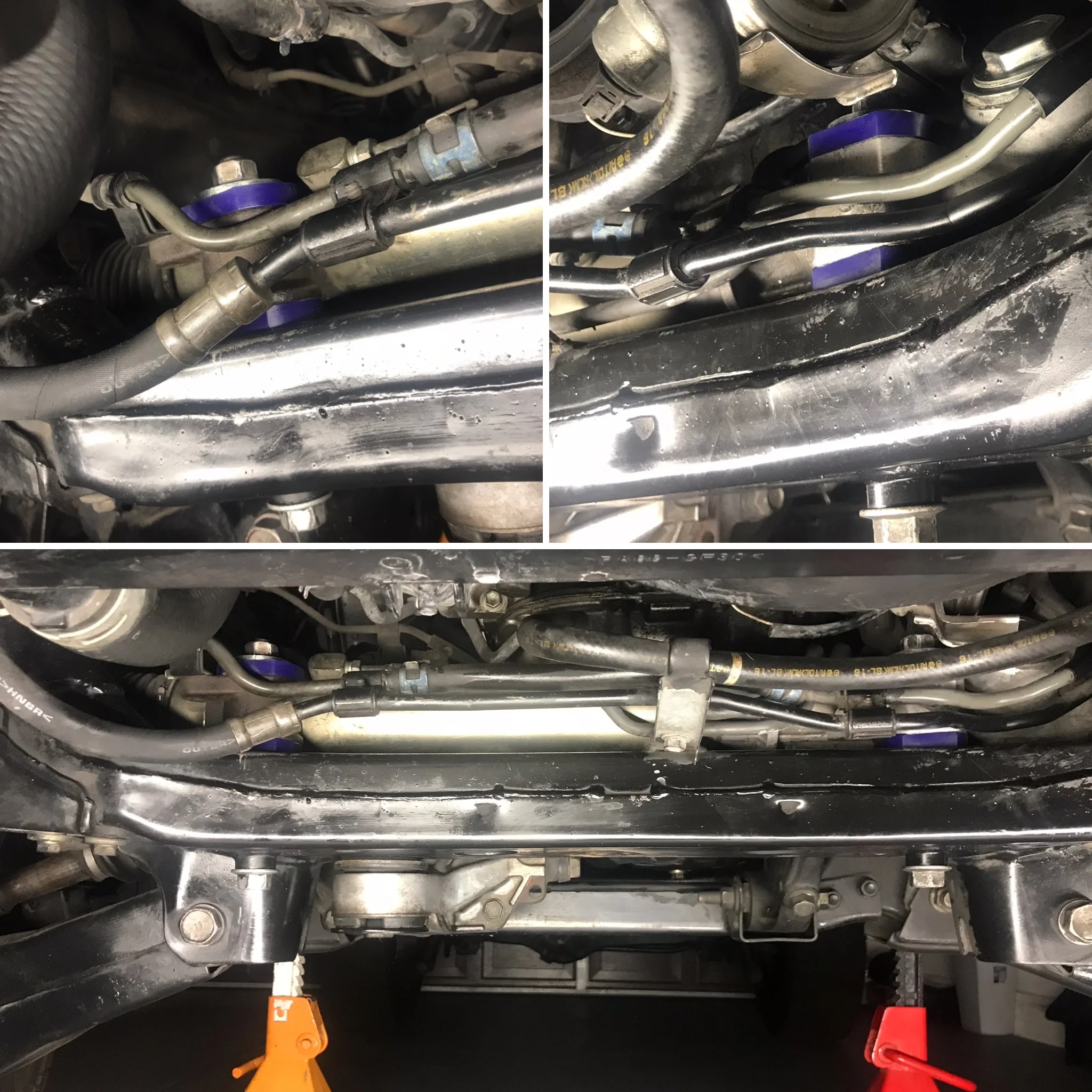

Watched video, I would say yes the lateral movement is excessive. I have an 06 and I went with polyurethane bushings and so far no issues with vgrs.
I did experience a “popping sound” as well when I turn the wheel after a few months I had it installed so I went back investigated more and it turned out I did not torqued the steering rack bushing bolts enough. After re-tightening it, popping sound disappeared. 5 yrs now on the poly bushings. Hope this helps.

Watched video, I would say yes the lateral movement is excessive. I have an 06 and I went with polyurethane bushings and so far no issues with vgrs.View attachment 3885782
