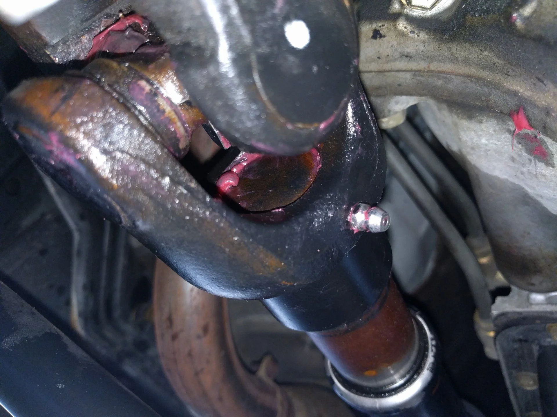

Hello all,
I am looking for some advice. I have been greasing my drive line every few hundred miles to try and get grease to pass the seal. Today while greasing the front drive line i had grease pass through the front of the drive line and not the seal. How bad is this and what does it mean. Any advice or information is greatly appreciated.
PS not sure if this is how to upload pictures got this to work though...
Lexus Dealer would drill a hole in that plate your grease is seeping out of now, to stop clunk. So don't worry about it. It will allow the internal pressure to equalize. But you may want to remove grease zerk for a minute just to make sure pressure has dropped.
I've had that exact thing happen before as well. I didn't get too concerned because of what 2001LC says. I'm thinking that's just a press-fit connection between the shaft and the u-shaped yoke itself...or whatever. I think more importantly, the FSM does not show this as a part that you disassemble to replace any seals on. A little weird, but I think it's ok. I think it's good policy to remove the zerk, and even drive around the block for a minute.

Hello all,
This is exactly what happened when I pumped some green grease into both front and rear slip joints. But it took care of the thunk in the driveline.
