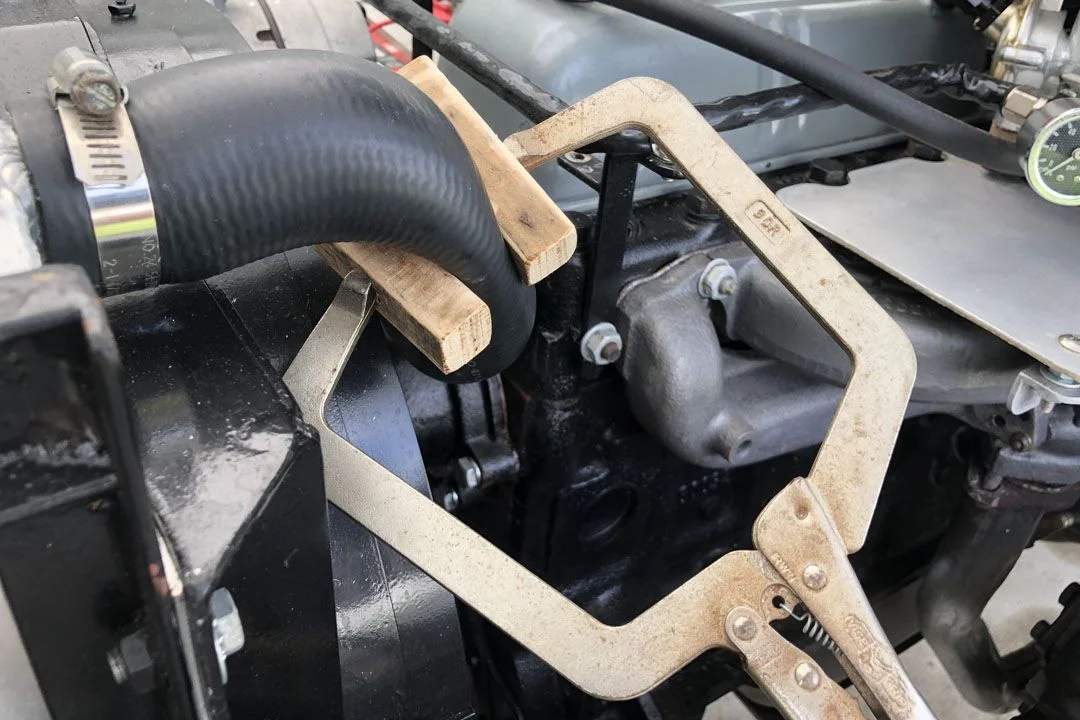

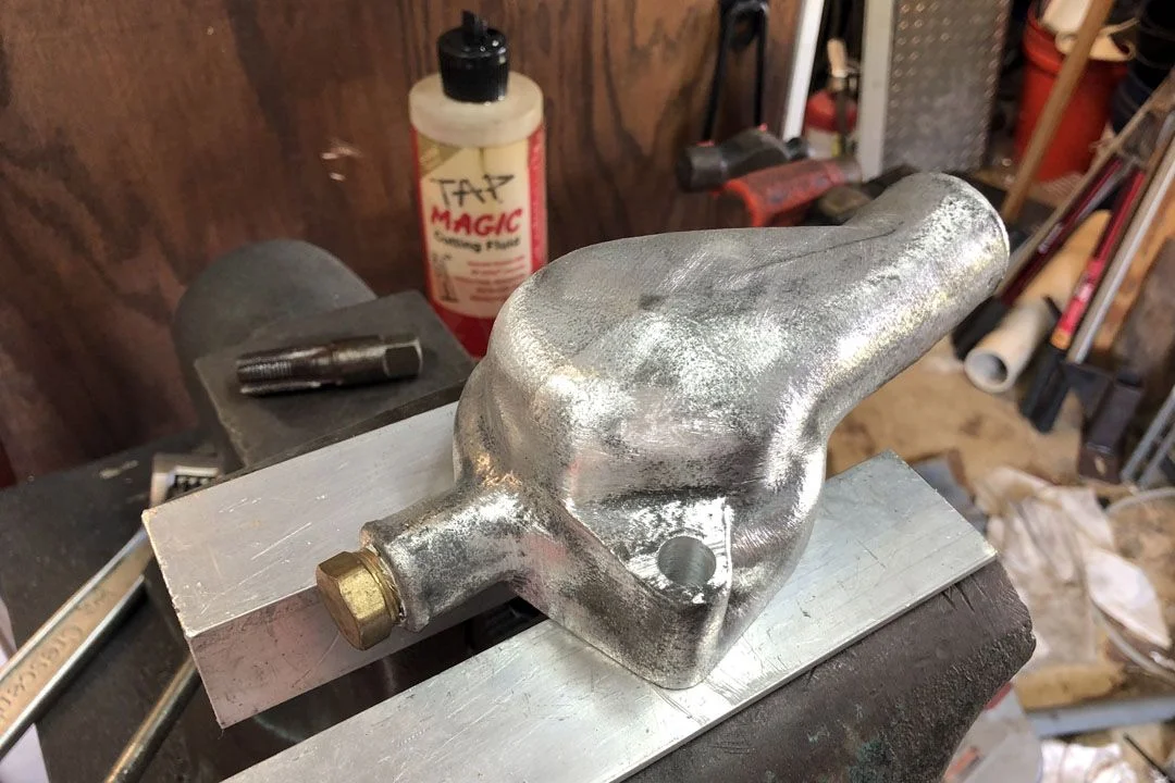

I have never seen the “flowing too fast to cool” theory demonstrated in any accurate or controlled comparison. My friend of a few decades who has done a lot of drag car, and swamp buggy building supports this theory and we often get in long heated debates over it. Not long ago I had a chance to test his theory while doing some flushing on my F.5.
To do a thorough flush with a garden hose in the radiator and the block and radiator drains open, the thermostat will not open with the steady flow of fresh water coming in, so I removed it. To block off the bypass I tapped and plugged a spare housing top and put the bypass hose back on. This way I got full flow through the engine & rad with nothing bypassing and no restriction from the thermostat. In his theory, without the restriction of the thermostat, I would not be cooling as well.
To test my friend’s theory, I got it up to a steady temperature and then restricted the flow by various amounts with a simple clamp on the hose only inches downstream from the T-stat housing. I went back and forth from restricted to non-restricted. I also had thermocouples going to a pair of Fluke meters on the inlet and outlet of the radiator. The Fluke readings and the dash mount VDO mechanical temp gauge all responded the same to the restriction change. Temps went up with more restriction and came down when the restriction was removed. This was no quickie test. It went on for hours leaving it run at a steady rpm both ways while I did other chores.
My friend still believes in his theory and that my test was an unexplained phenomenon. We're still friends but just don't discuss it anymore.
