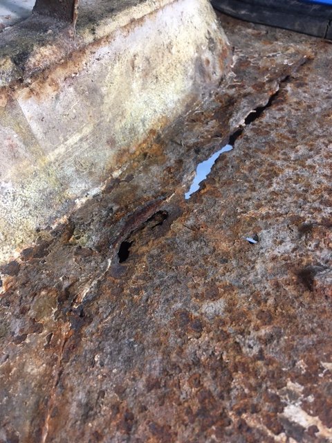

Today I lifted the cheap glued-down carpet and the photos show the floor after a putty scraper and vacuum. Next, I'll take a media blaster to it. The photos show some rot in the seam where the front/rear floor begins to roll up for the rear seat. The holes are clear on both sides but the buckle in the seam tells me it throughout.
What is the way to fix that seam. I'm thinking cut off the top layer of the seam below where the vertical angle turns horizontal (its width), then lay in new floor patch running a little proud from front to back under where the top piece was, then place new top piece to replicate the seam. Alternatively, the holes are all in the floor before it got seamed over. So does one cut flush with the top seam, grind flat from underneath, then go under with new floor patch. That would leave most diificult piece to replicate in place. But how does one reattach the floor patch to this piece. Ideas please. Thank you.
Theres no exact way to do it. What happens is because the flange is spotwelded on top of the floor pan, water from your boots and snow get trapped underneath! 2 ways to do it! Eliminate the flange and butt the pieces together, or apply a seam sealer inside and out. Remember it took 40+ years to get this way 😉🐷

I appreciate that. I think the way it would be easier for me to achieve a good result is to use the flange as a guide and cut off the floor just outside and keeping the flange. Then clean the underside. What if I drilled holes in the flange before the floor patch went on underlapping. Then I could "spot weld" through the flange. Does that sound like a good repair?

I need help to get me moving forward again. I can weld new metal but don't have any experience joining old to new so I'm stuck between what I see as two choices. The enclosed photo (and others above) show the rot at the edge of the passenger floor seam just as it rises up and backwards under the rear seat. That rot is on both sides.
I'm going to keep the flange at the rear (shown in the left side of photo) and go over (or under) it with new metal. I'm stuck with two general planning issues. What I'm stuck on is whether or not to run one large floor panel or weld in several small patches keeping and going around the stiffener ribs. If I put in one large panel, it would probably run forward to about the "6" on the tape measure. I would have to add ribs back in. Is that cleaner or easier than cutting a goofy abstract piece going around and keeping the existing ribs?
Another area where I have no practical knowledge. Whether I "go large or small", I'm worried about the weld seam if I were to butt the panels especially if I'm going to make small patches and weld more to the rear where one can see the metal, although not rotted through, is certainly "pock-marked". It seems that due to the condition of the old metal it would be a difficult butt weld to make without burning through, correct. The metal is cleaner farther forward if I were to make a large floor patch. Is that an easier weld to make correctly as the metal is cleaner there? Or does lapping the forward joint wherever it goes eliminate my concerns?
Do you have a full rear floorpan?? Most important thing welding old to new is that the metal is clean!! If you are concerned about burn through, use a piece of brass or copper on the back of the joint to prevent that. Start with a low setting on welder and tack pieces of scrap together of same thickness and adjust from there. I would use the whole floor pan if thats what you have. You'll go nuts piecing all that 💩 together. Capice 🤔😉
