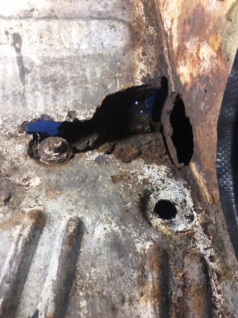

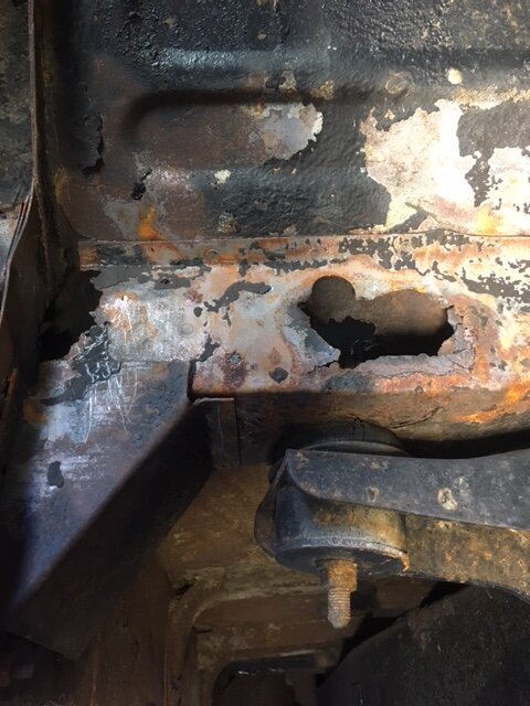

I need to finish the detour this floor has become. I'm happy with the rear floor repair. Here are photos of the next area I'm working on and could use some advice.
Both photos are of the passenger front body mount area. In the first photo, taken from above, one can view the totality of the damage- body mount, floor pan, and inner rocker wall below floor. Second photo is view from below.
There is no other damage in this area. My thinking is that I don't need to replace entire floor pan or body mount. Maybe buy a mount f I can, then cut to use a portion? The inner wall needs to be patched once access is provided. Access seems to be the hardest part. How would you go about fixing this area? Thanks for your help.

I realize I need to replace metal but what and how much? Entire floor pan? Seems like a lot of pan to replace for a relatively small area. But I will do what others in the know recommend. So, whole floor pan? What about body mount? Entire thing? Thanks
At the end of the day it’ll probably take less time and be easier to replace the whole panel than to trim and patch. Bonus will be all good metal and no need to go back in
