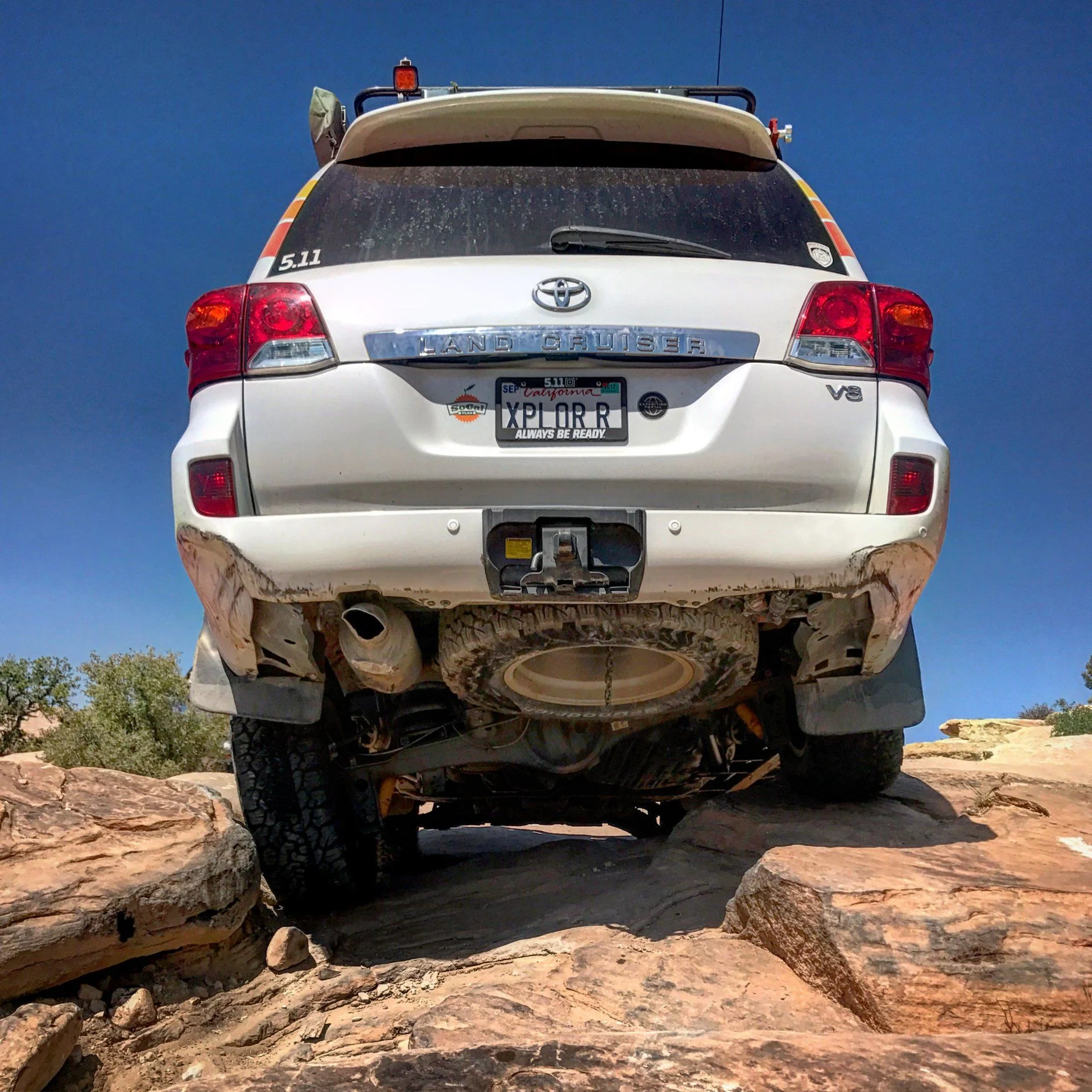

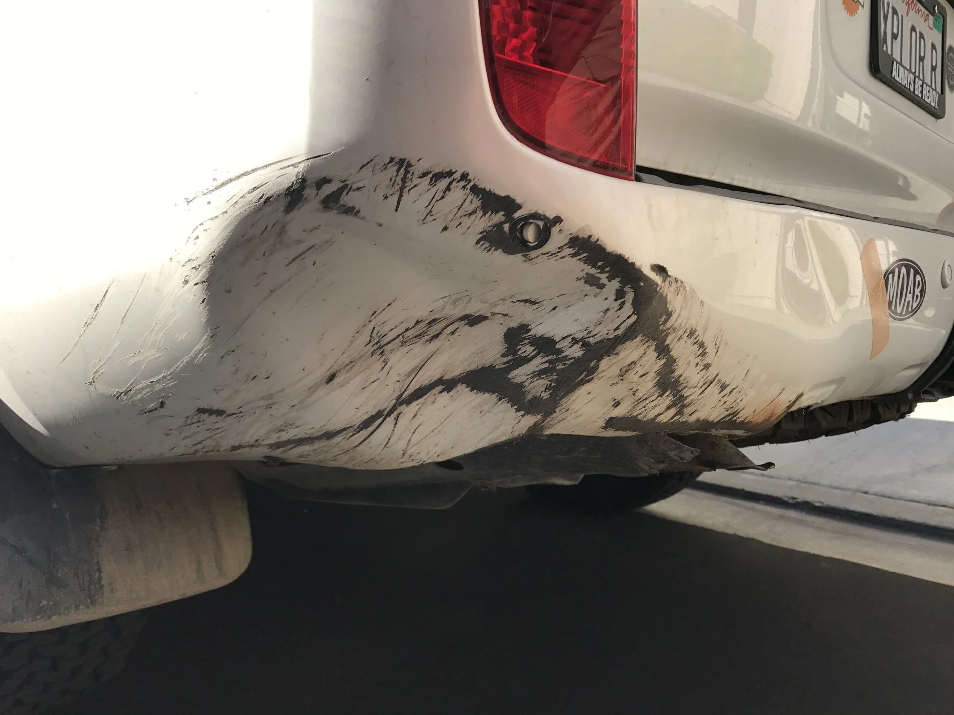

To @Canyonero's point, I also run 33s and did a lot of bumper scraping in Moab. Now, while that's nothing new for my bumpers, it's easy for the damage to add up for gnarly hits. I went into Moab with one goal regarding bumper damage: to salvage enough of my bumper to save for an aftermarket bumper. Well, I failed. I did just enough damage to basically need to replace my entire plastic bumper just to get an aftermarket one.
The rear corners are especially susceptible to damage. It's easy for the bumper to catch on rock and rip it completely off the vehicle. If you're lucky, you can snap it back in place easily. However, the plastic does not do well with repeated bashings. The most recent time mine came off it broke half of the plastic tabs that secure the bumper to the quarter panel. Mine is essentially glued to the truck at the moment.
Damage from not having rear armor can add up:
  • It's easy to break the rear side support, $45 each time, I've broken this three times
  • Movement in the plastic bumper also broke the mount on the rear tail light and the entire light must be replaced, $300
  • Replacing the entire bumper cover is $800-$1000 once you factor in the paint job (yeah, I'm probably getting hosed on that here in the Bay Area)
  • I've had to replace the trailer harness thing twice as well, forgot how much that costs
  • The plastic cover below the quarter panel was mangled... another $100 drop in the bucket
  • There's a crack in the center of the bumper and repairing that cost $1 in cable ties
All in all I'll probably have dropped close to $2k on fixing the plastic bumper just to prepare to get a rear bumper (unless I find a fabricator that does not require any of the OG bumper cover).
Moral of the story? Like everyone else has said, clearance, lift, tires, and sliders are good investments for Moab. However, I don't personally recommend expecting to still be able to use your stock bumper in conjunction with an aftermarket bumper if it's seen heavy abuse. I really did not expect it to break in the ways that it did.

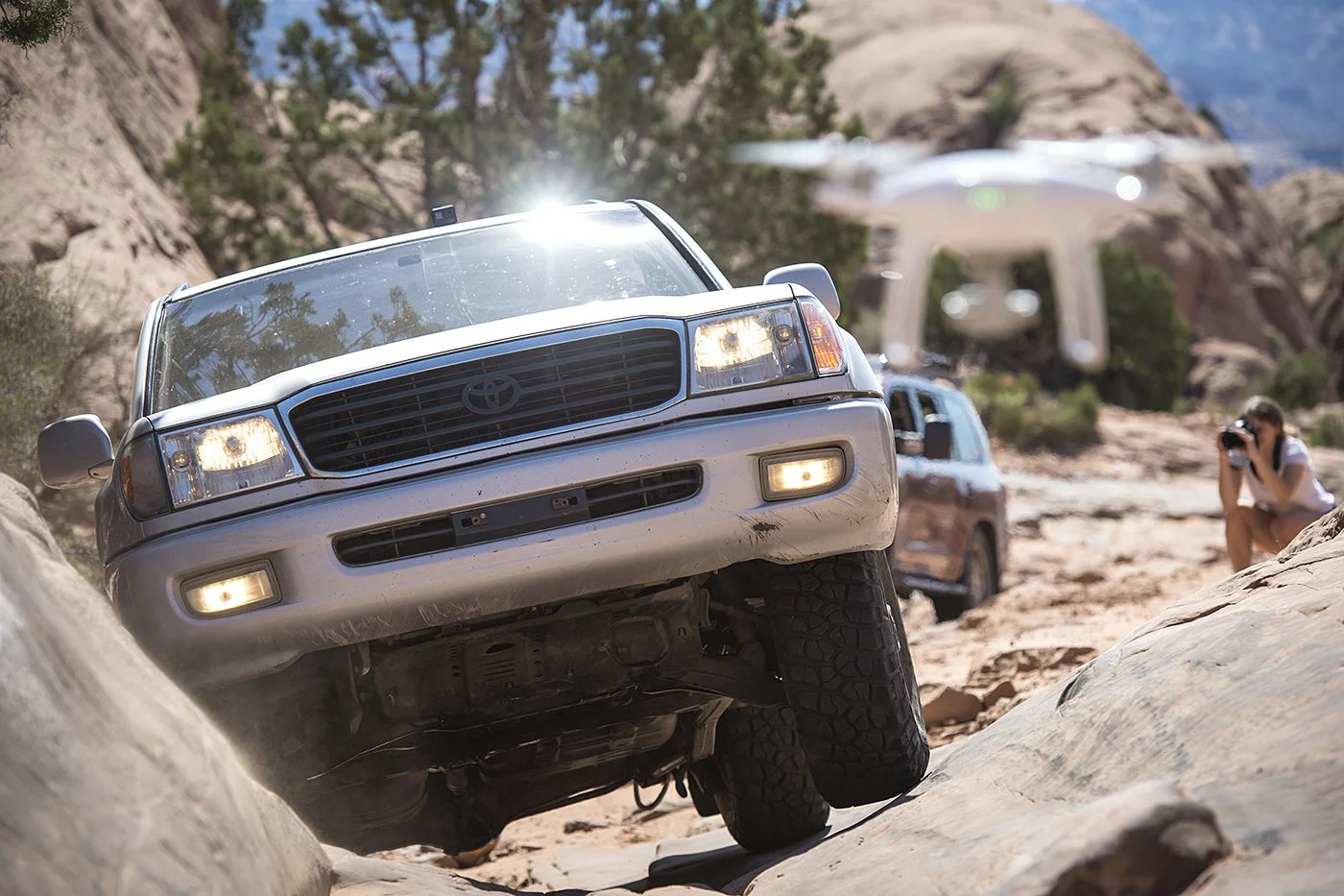

@ethernectar is a great driver, but his smaller (33" I think) tires vs. most of the group's 34/35" tires made an enormous difference in some of the big rock ledge sections.

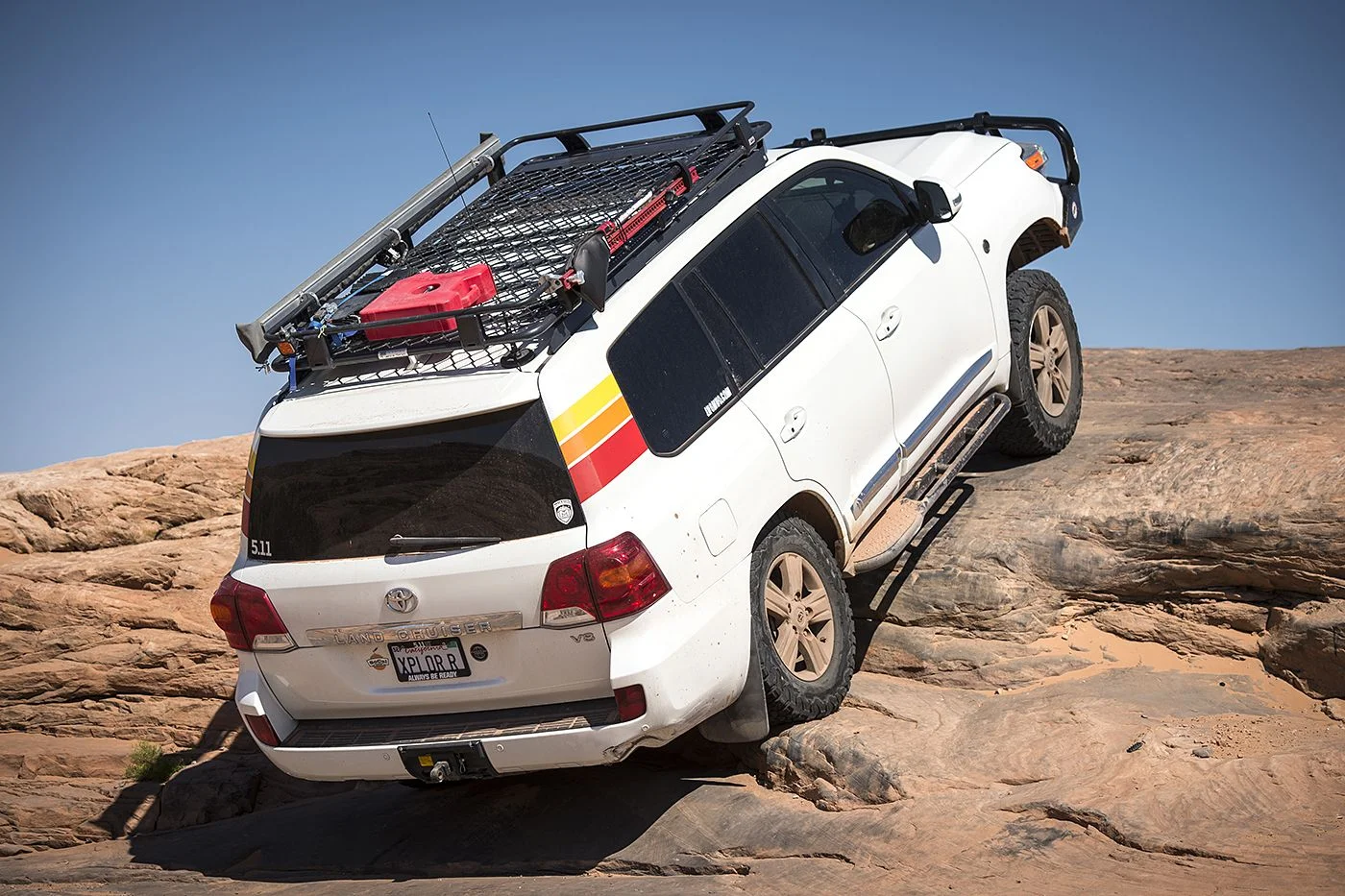

I'm running BFG 275/70/18, AT KO2's and they measured 32" height mounted when new (at street pressure). But hey, no tire rubbing... rear bumper on the other hand... seemed to rub itself all over every rock that was even close (that hussie)...
When these tires are done, I'll be moving up to 33's and perhaps different wheels with a touch of offset. If I can find 5 Rock Warriors I'll go that route, or aftermarket.
I'll be going with the simple one-piece ARB bumper shortly. Just don't want the swingouts.
Damage tally was about $500, excluding the bumper itself. Smashed the driver side radar sensor to smithereeeeeeens and that poorly placed trailer harness.

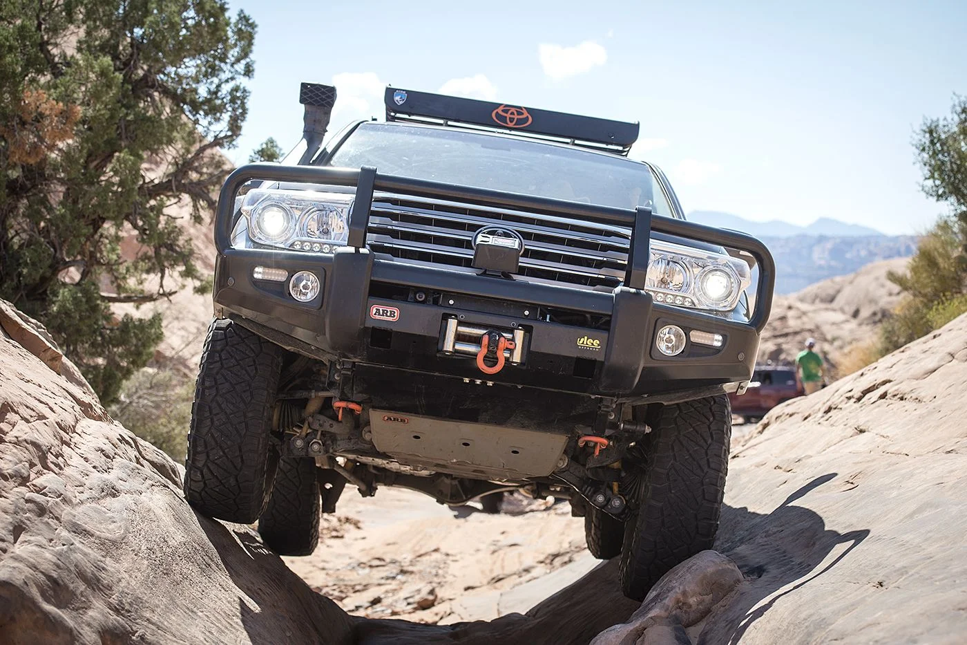

Obviously I'm not Mark, but here are a bunch of photos of his bumper. I will add that his TJM is awesome and I'd be glad to have one.
Wow, Cole! As usual, my favorite photos of my own truck are shots by others, and particularly by you! Thanks for posting. Haven't seen some of those. You and Kreiten are all over the scene with your photo skeeeells!!
Are you happy with the TJM overall? I never liked the ARB bars much curious what your experience has been like. A nice pic would be cool too.
I would absolutely do the TJM again. It has proven its strength several critical times already.
Only down-side of the TJM is that finding one available for purchase is tough, and requires patience.
If you want one, call Wes Carter at TJM USA, or Slee Offroad who often is the vendor with the few that arrive in the US.
