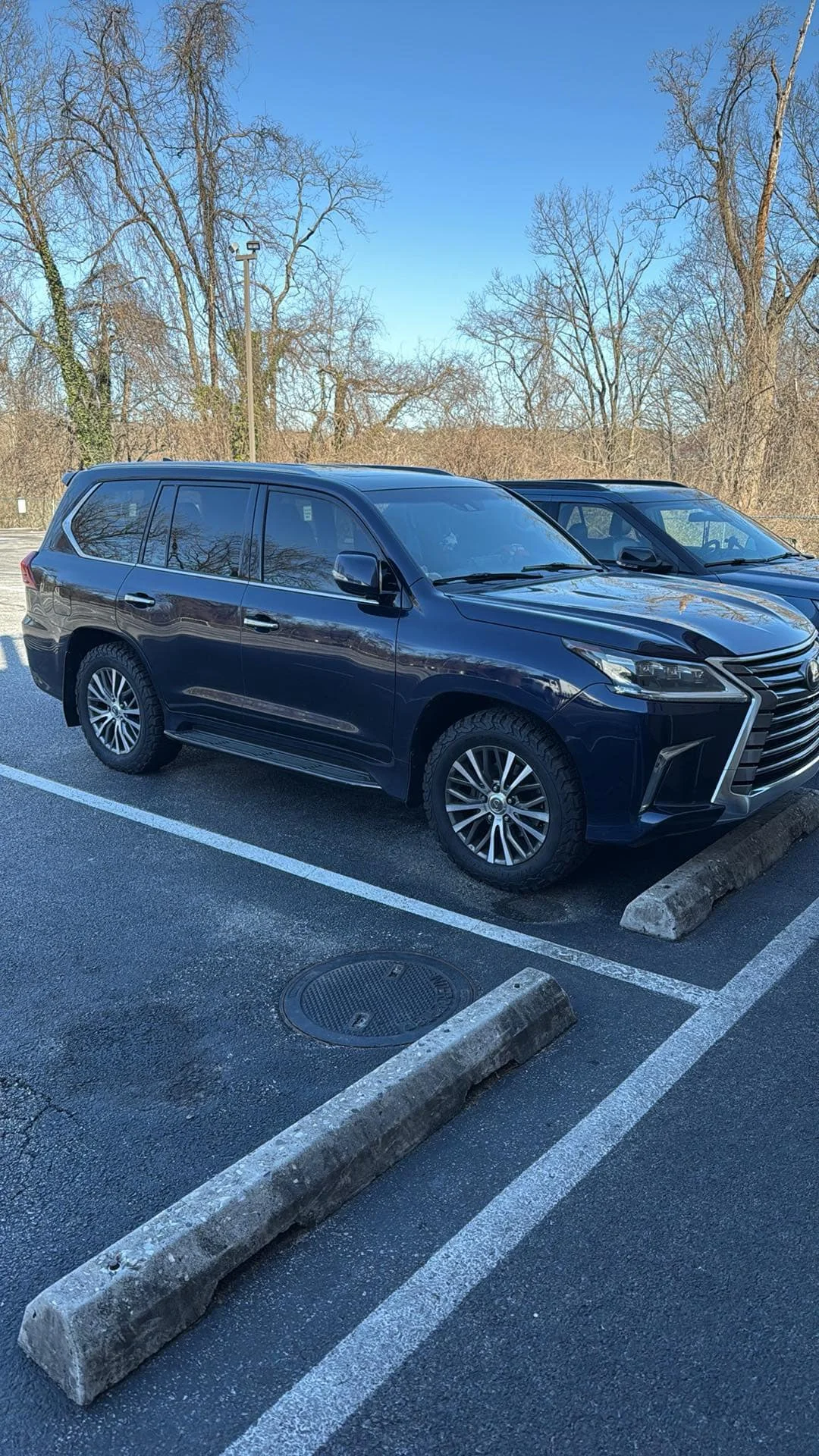

After upgrading to 33" K02s on my factory 20" wheels (2017 LX570) I noticed the added weight of the wheel/tire package.
I originally wanted to keep the factory 20s (which I may still) so I could upgrade to a bigger brake package from SOS Performance but the added weight of the current setup is felt around town and its a little annoying to be honest. Unless the Stoptech kit from SOS drops unsprung weight considerably, maybe the move is to get some lighter 18s and 33s to go back to stock weight wheel/tire setup.
Any input on what Volks or EvoCourse wheels weigh?
So far I am VERY happy with the performance of the K02s however, so at least theres that LOL
