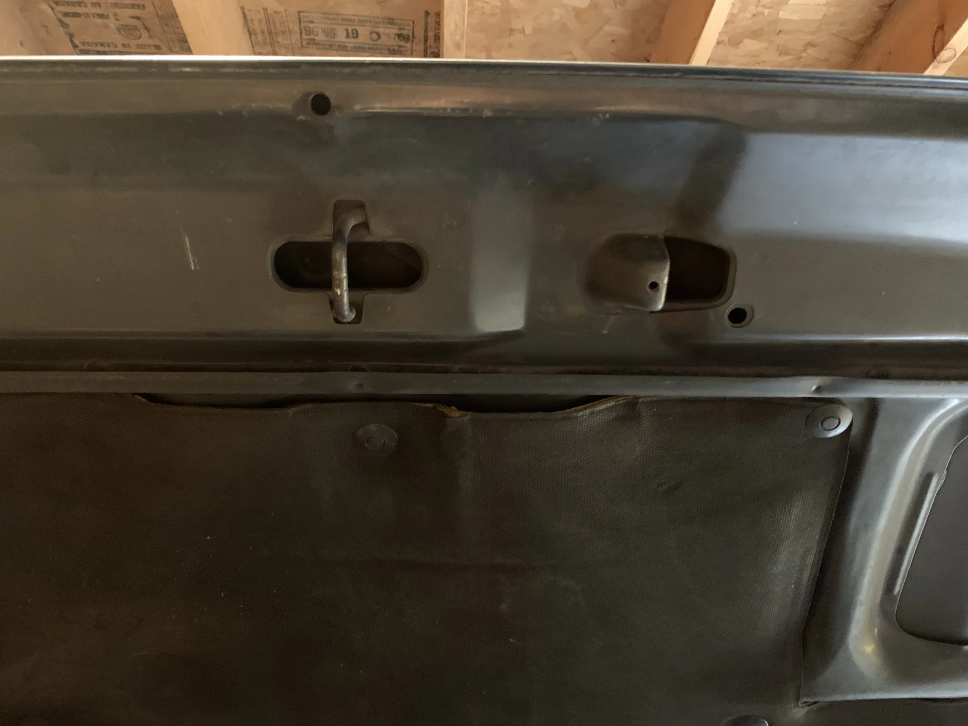

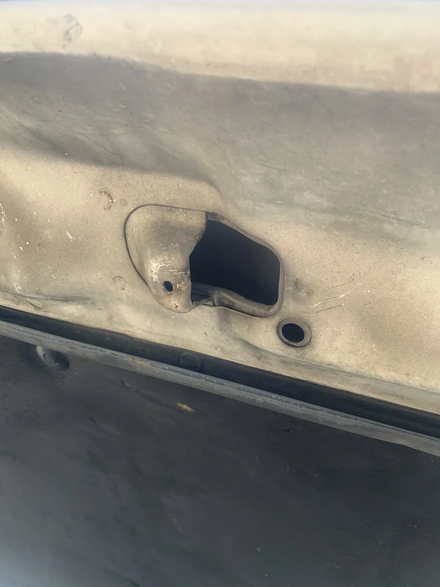

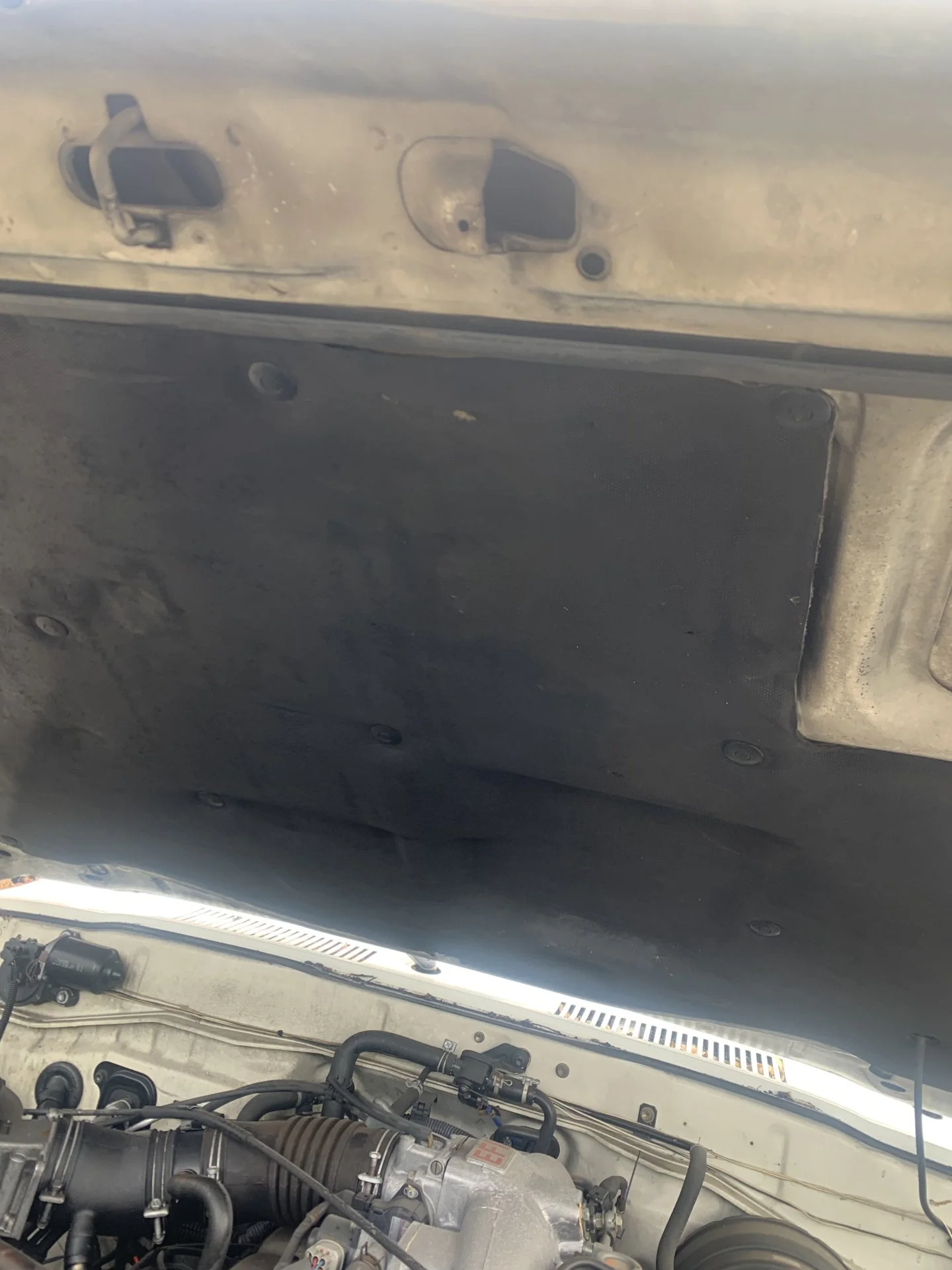

Is something missing on the inner hood area here?
Same on my 92
I suspect the hole in the hood would have held a light in foreign market cruisers.

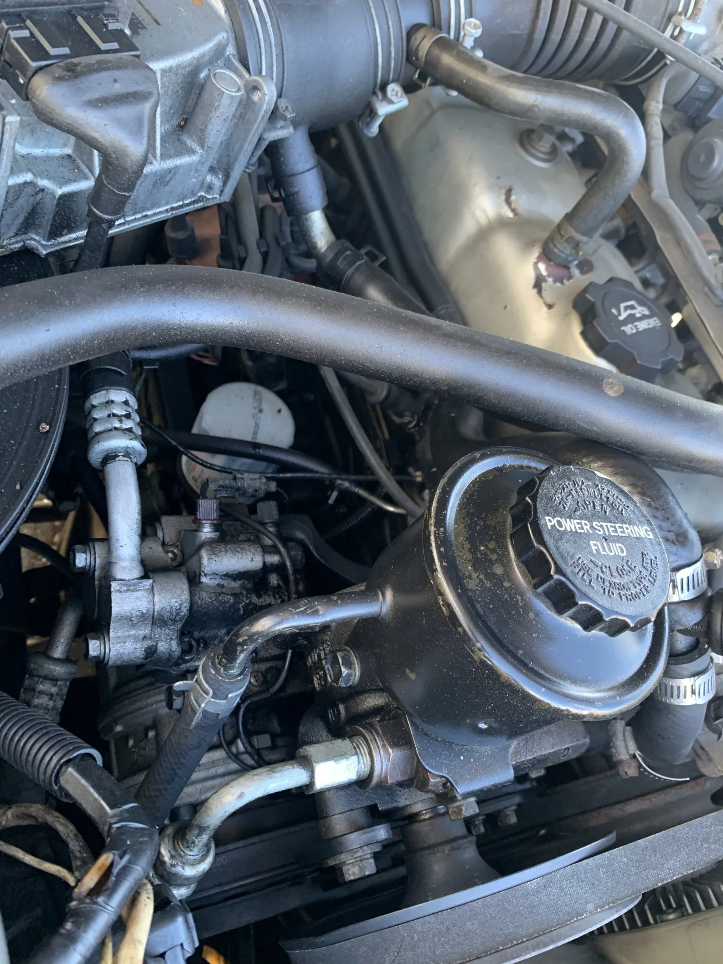

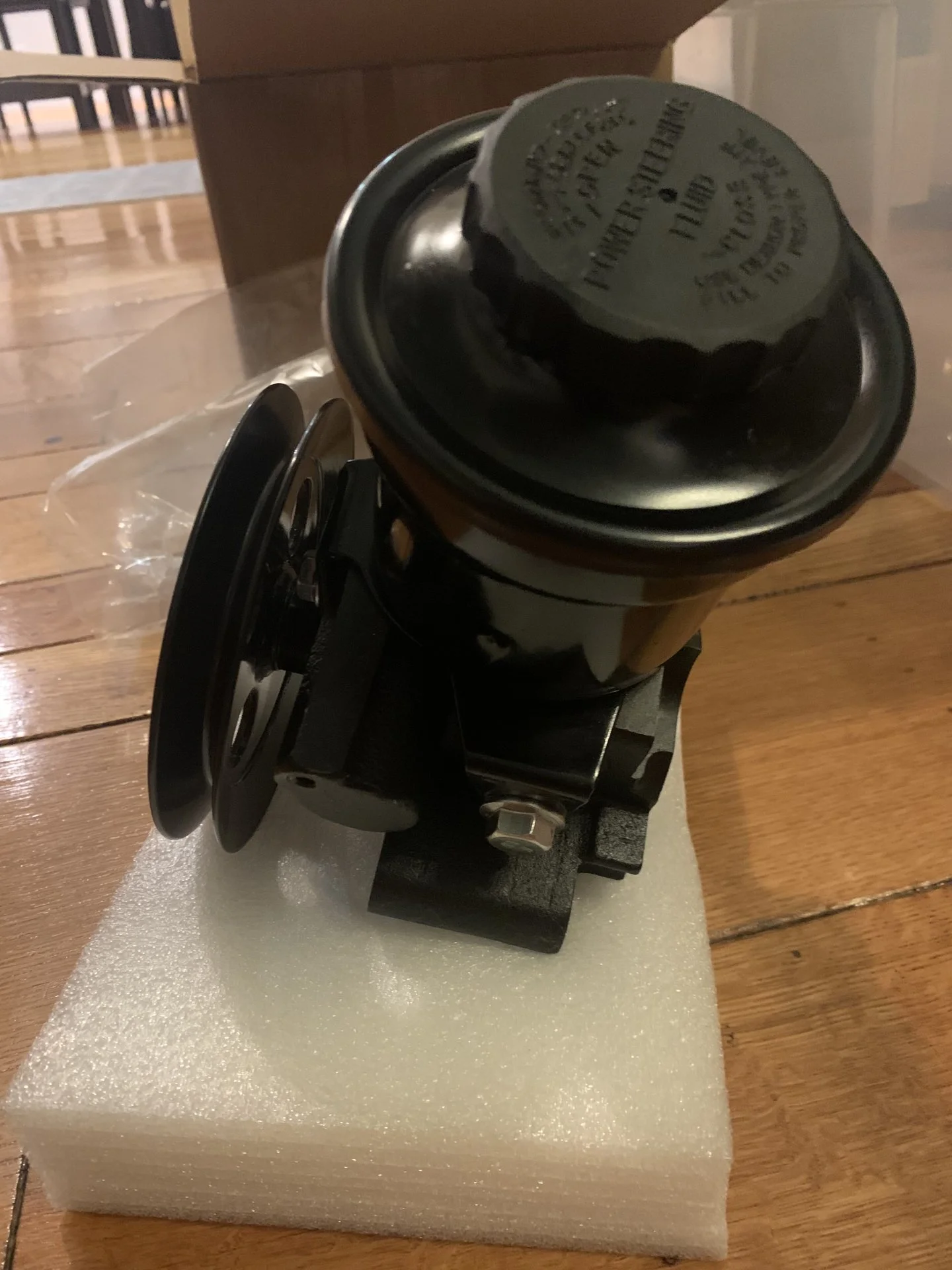

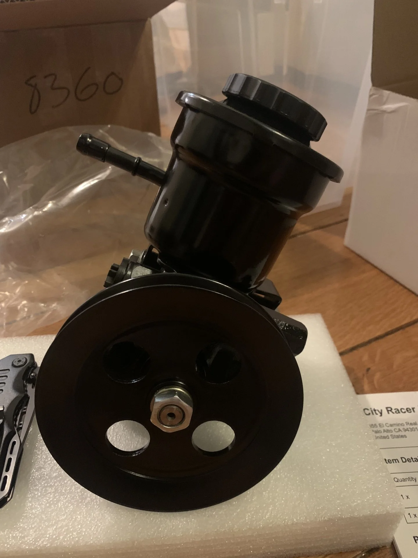

Can anyone verify that this PS pump above is correct for my ‘92 land cruiser? I noticed that the hard line coming off of the pump is not quite the same. The one in my car has a 90 degree down turn…?
That's how the aftermarket one is. You can swap your old reservoir to the new pump. Make sure you clean the old reservoir very well. Maybe let it sit in a bucket of degreaser of some kind.
Sounds good. Just making sure I didn’t receive the wrong part all together.
Looks like the old one has Peroni's and the new one is more of a teenager........
