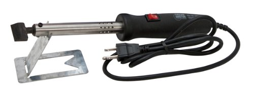

I would burn my house down with that thing.
