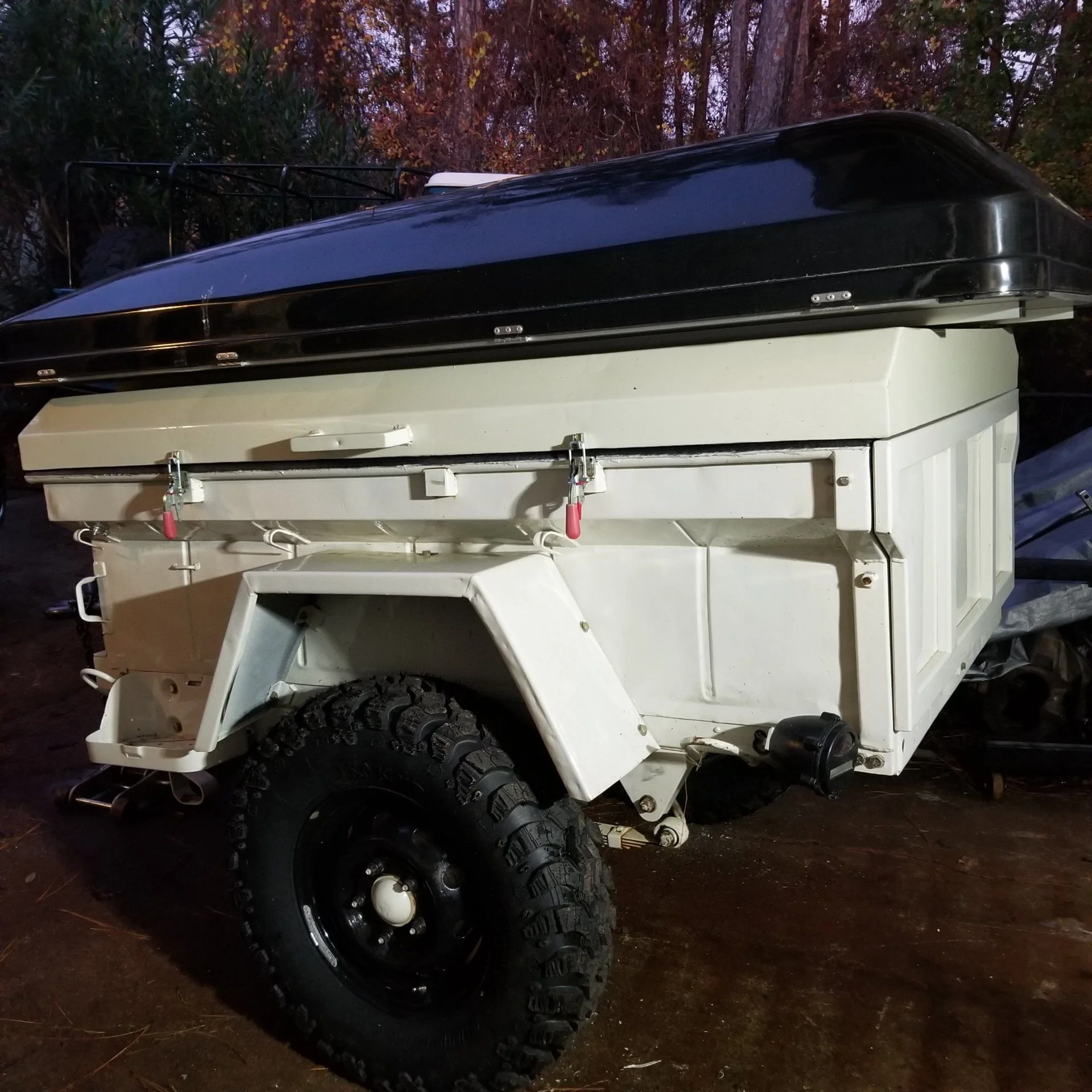

SOA my trailer today. Has 33 interco iroks....SNIP

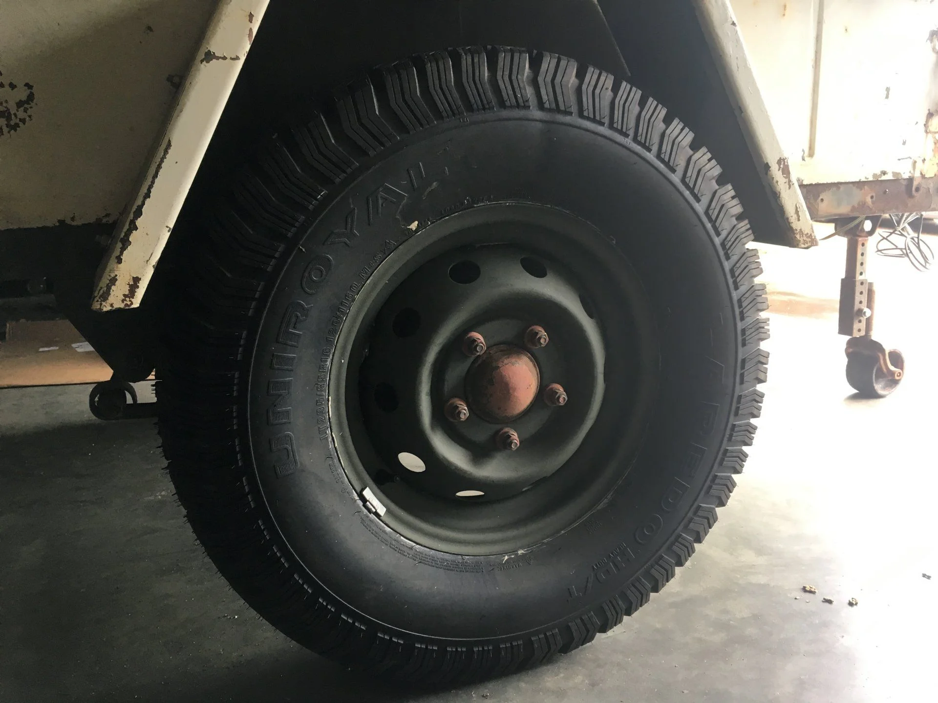

Decision has been made and wheels dropped off. 235 85 R16 Uniroyal Laredo HD/T is the winner. Specs say they measure 31.6” tall and 9.4” wide when mounted on 6.5” wide wheels. It will be interesting to see how they measure out on the M416 4.5” wheel.
Big thanks to Chris at 49 Tire Pros (& Cruisers). Pics on wheel to follow in a few days. Trailer is still under construction. I drove poor Chris @wct49 nuts looking for an old school look with smooth sidewall and chunky tread in a radial. Every tire I liked was discontinued. Chris found and recommended the Uniroyals.
Thats a great looking tire for a trailer.
I have that exact size on my M101Cnd. It's big tire but fit without mods. Only if I put gravel it or something really heavy that I might get rub on the fender.
I didn’t realize that Uniroyal is made by Michelin. These Laredo HD/Ts are a heavy duty commercial tire. I will never wear them out!

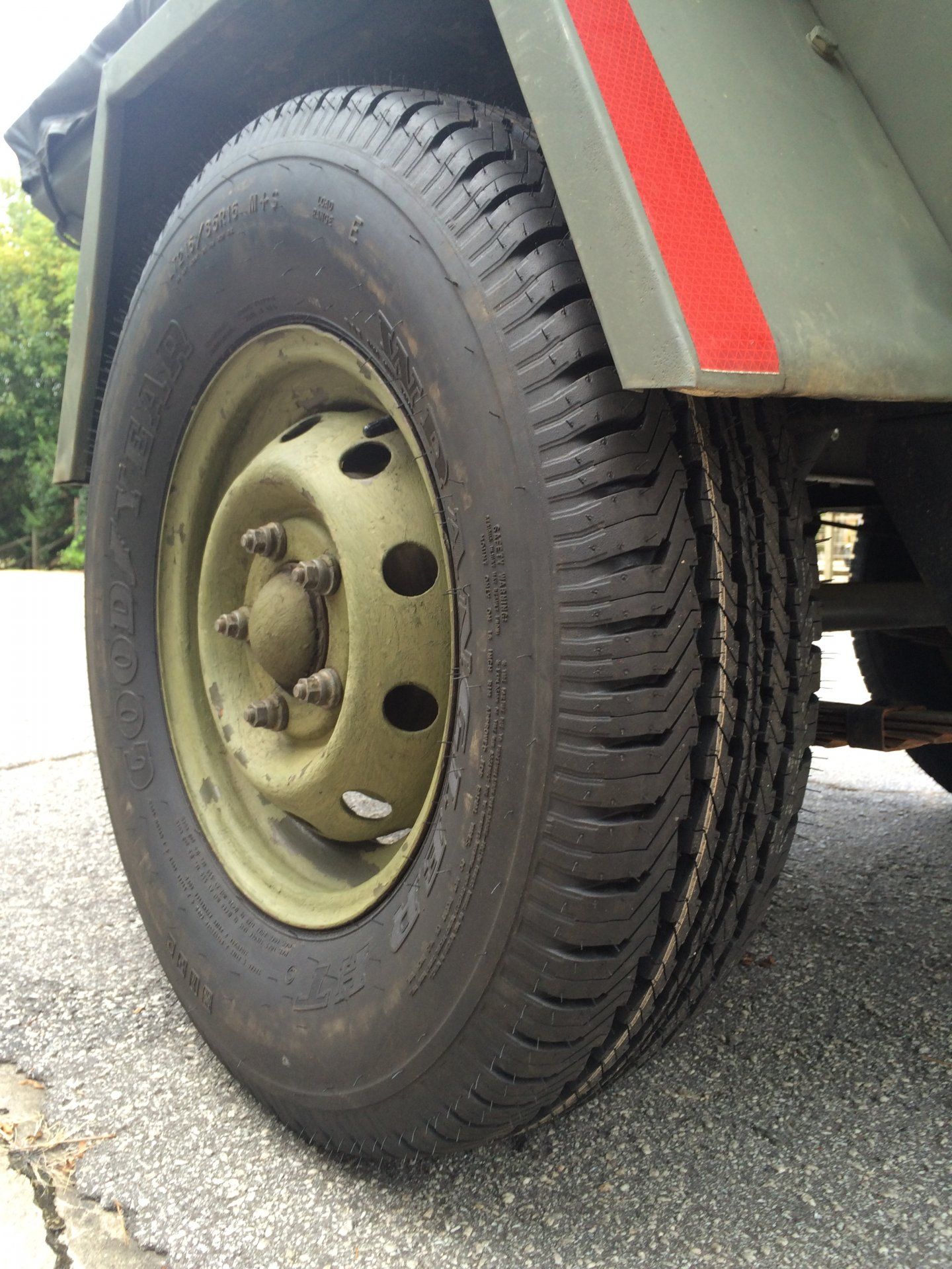

I ended up getting these. They are LT tires load rated E, but have worked well for me. I haven't dragged it across too many offroad trails, but it gets my gear across state lines smoothly. I'm still running the tubes on these radials.
Goodyear Wrangler HT Tire - 215/85R16

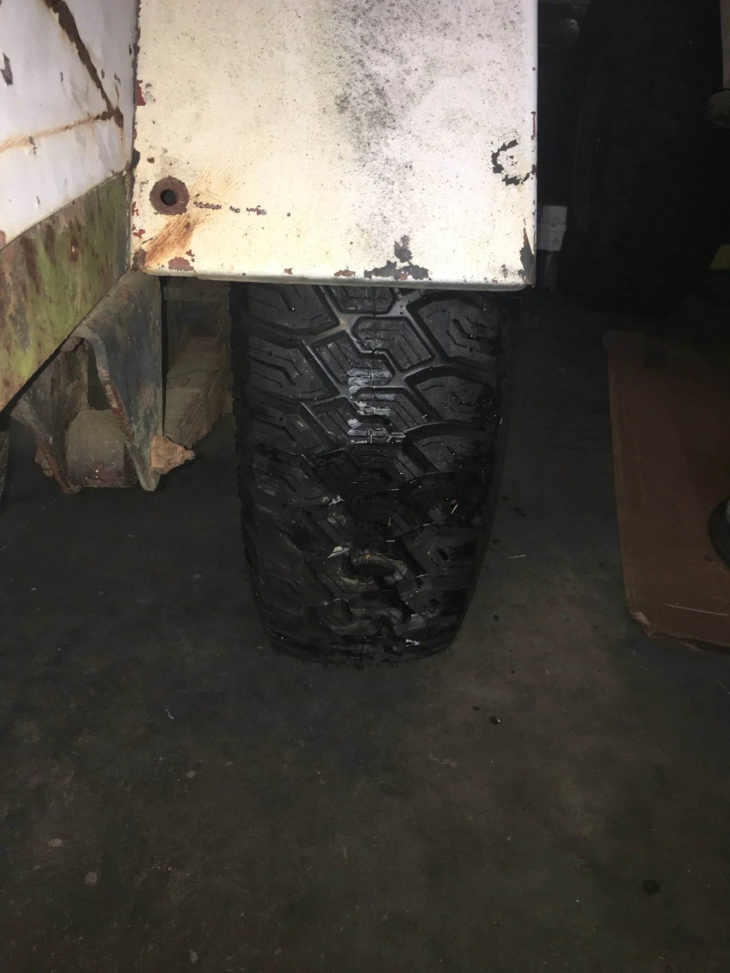

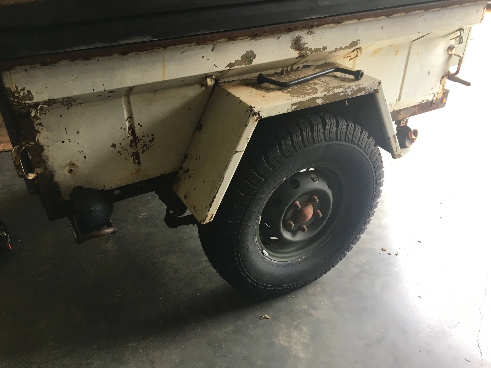

Would you mind posting a couple additional pics for me? Straight on from the side and then looking down the fender line from the back?

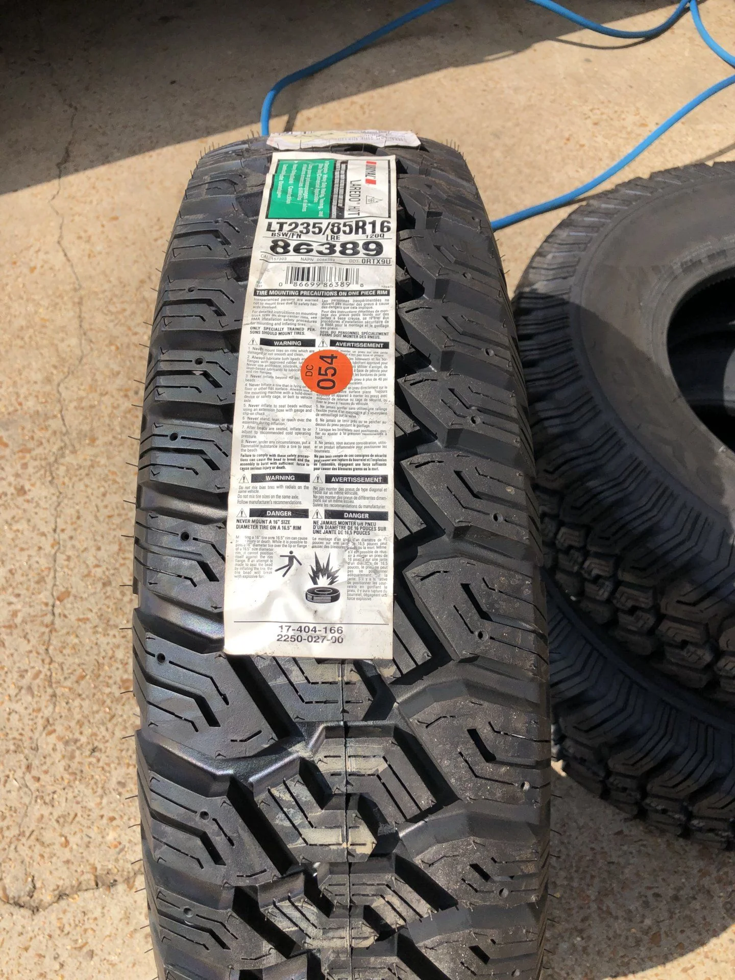

well seems like those uniroyals mentioned above are discontinued which it too bad. these wheels
are tough to find a proper tire for!! i want a chunky tire because it just looks right on these trailers. i can get a cooper discover stt pro in a 235/85r16 but they’re $350 a piece!!! that’s almost as much as i paid for the whole trailer!! i need the trailer later this month for a road trip so don’t have a ton of time to shop unfortunately. any other ideas you guys have for a tire that looks right that might actually be available 😂
