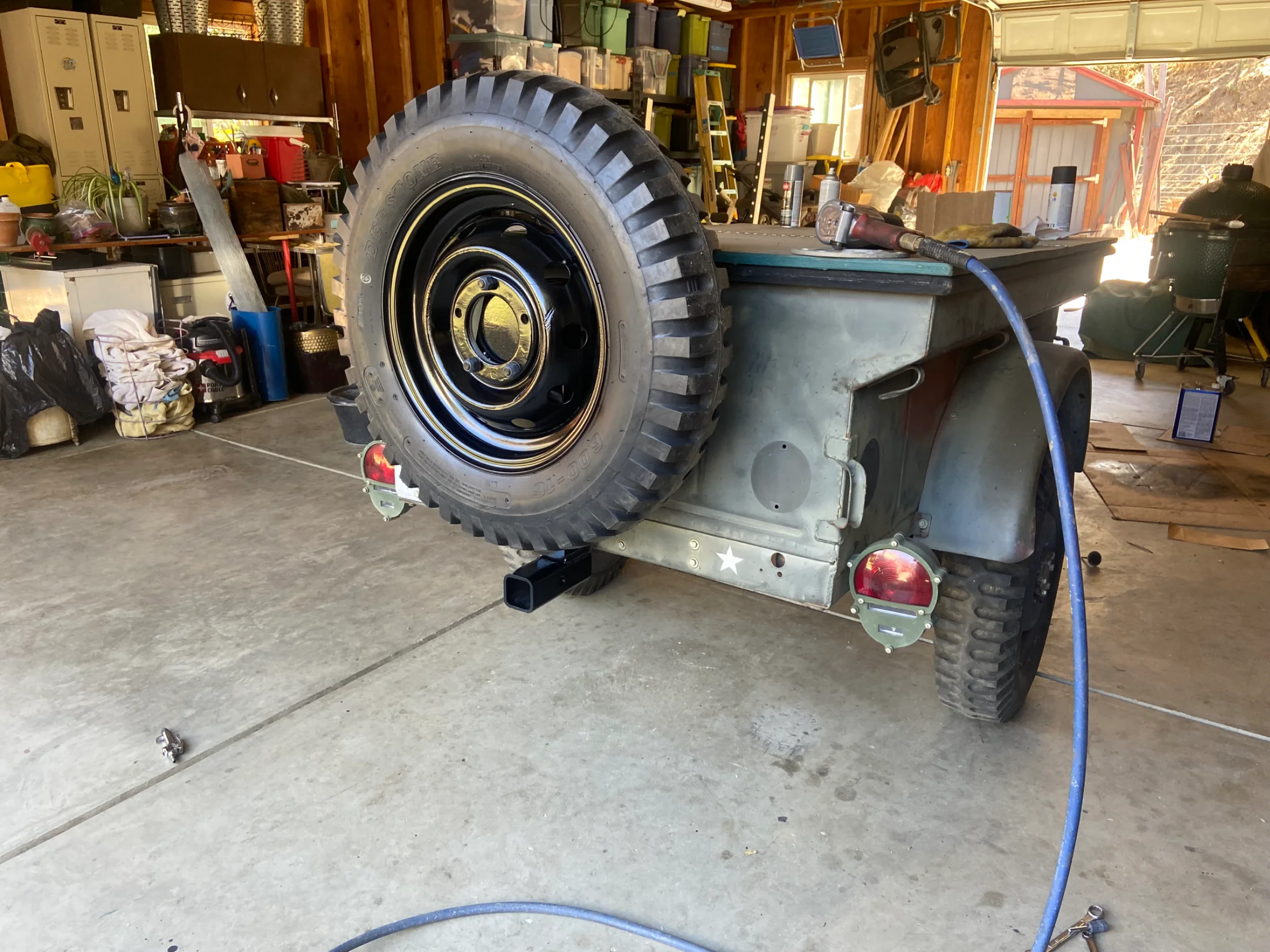

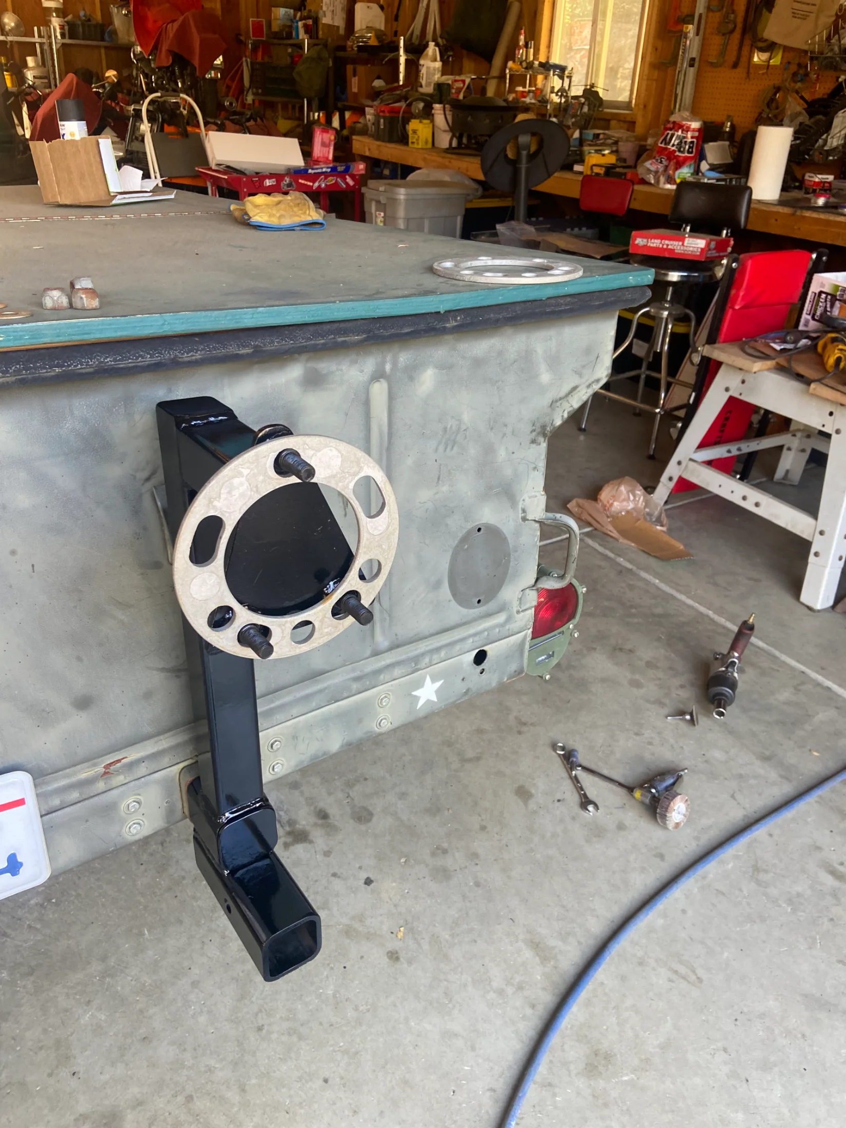

Years ago when I went through it I put a receiver in the back that pins up underneath for a bike rack or a spare mount. I even have another 416 wheel.

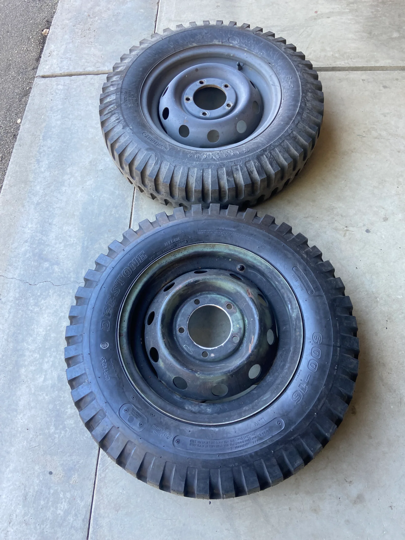

Found a knockoff 6.00 x 16 tire to match the others for a spare. It’s a Deestone, not a Firestone. Wonder where it comes from…
It’ll work as a spare and for less than half the cost of the Coker I figured it would be fine. I had the tire shop put in a heavy duty tube too.
Cleaned up the trailer hitch spare holder. It has a second receiver under it that will take a bike rack. Just make sure you have a couple hundred pounds of stuff in the trailer or it’s wagging all over the place.

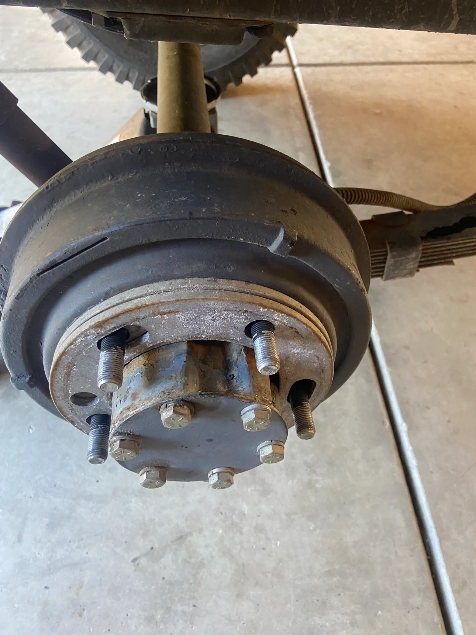

To use the M416 wheels I had to run a couple 1/4” spacers because the offset on the wheels is different. I think longer studs were needed too. That was 20ish years ago so I could be wrong…
