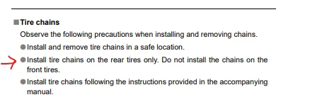

Officially no, Toyota does not recommend use of any chains (standard link or low profile cable) on the front. That's in the owners manual. You may or may not have luck if you try. I wouldn't risk it unless I was going slow and straight.

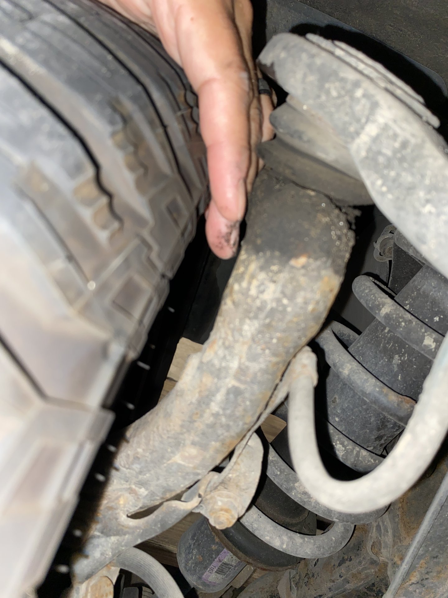

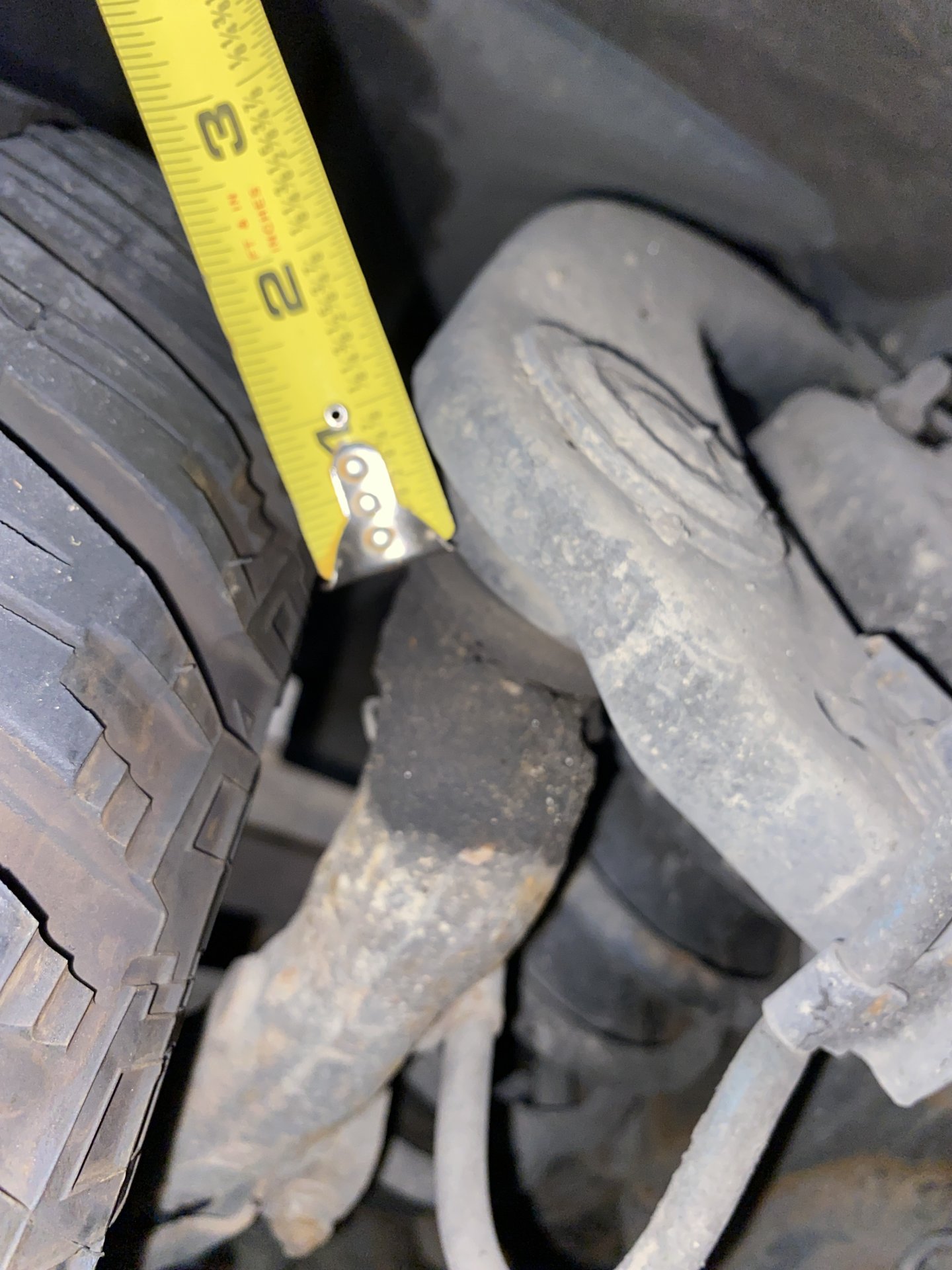

Forgot I took pictures of 285/65r18 per request in the past. These are KO2s which run small in most sizes. An LX has more room to the sway bar on account of no KDSS but will still have issues with the UCA and rear of the fender well. Even a /60r18 wouldn’t give enough room.
There was over an inch of clearance between the tire and the UCA (1st picture with the yellow tape). In the second picture, there was only about 5/8” of clearance between the sidewall of the tire and the arm (KDSS?). Too close that I don’t think the S-type chain would clear this, but I’m going to see if I could add a 1/2 spacer to the wheels add clearance. Does anyone have info on adding 1/2 spaced without changing the studs and just use the factory lug nuts?
Every chain I’ve ever seen will hit that UCA as you get up to the speed limit of the chains, probably even with 1/2” spacers.
Thinking back, my quote of room should be just the lateral clearance at the sidewall. Anything outboard of the tread will have to deal with the centrifugal force of the chain/cable being slung outward. And you DO NOT want that cable hitting that suspension stuff, breaking, and wrapping up in there.
