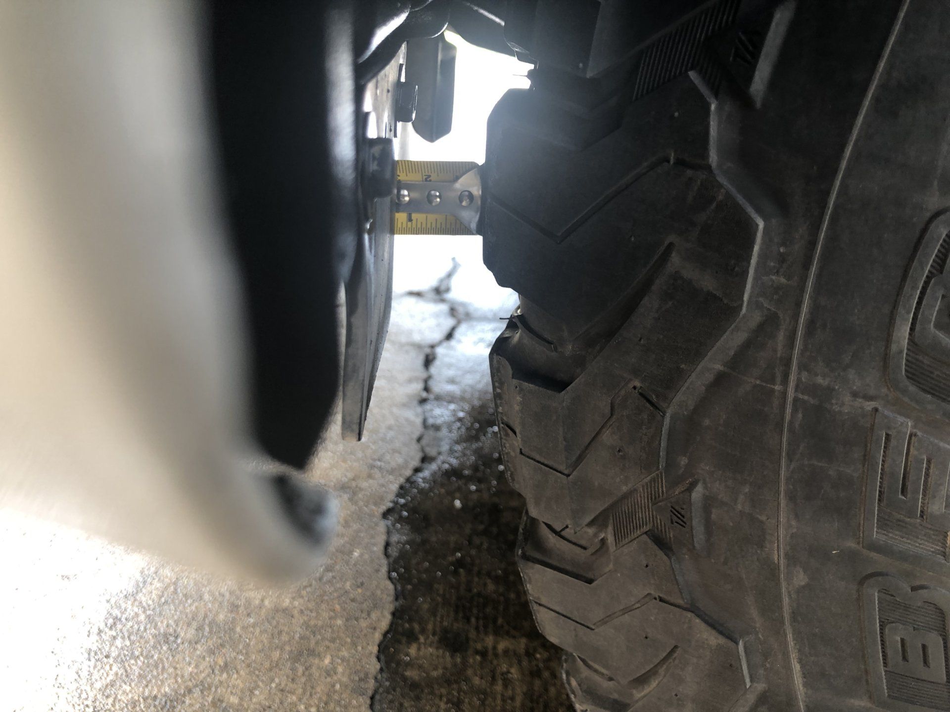

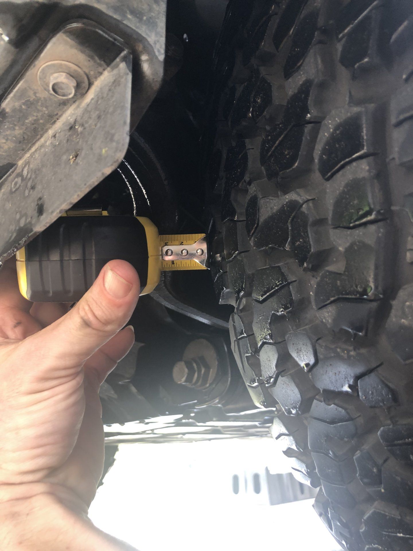

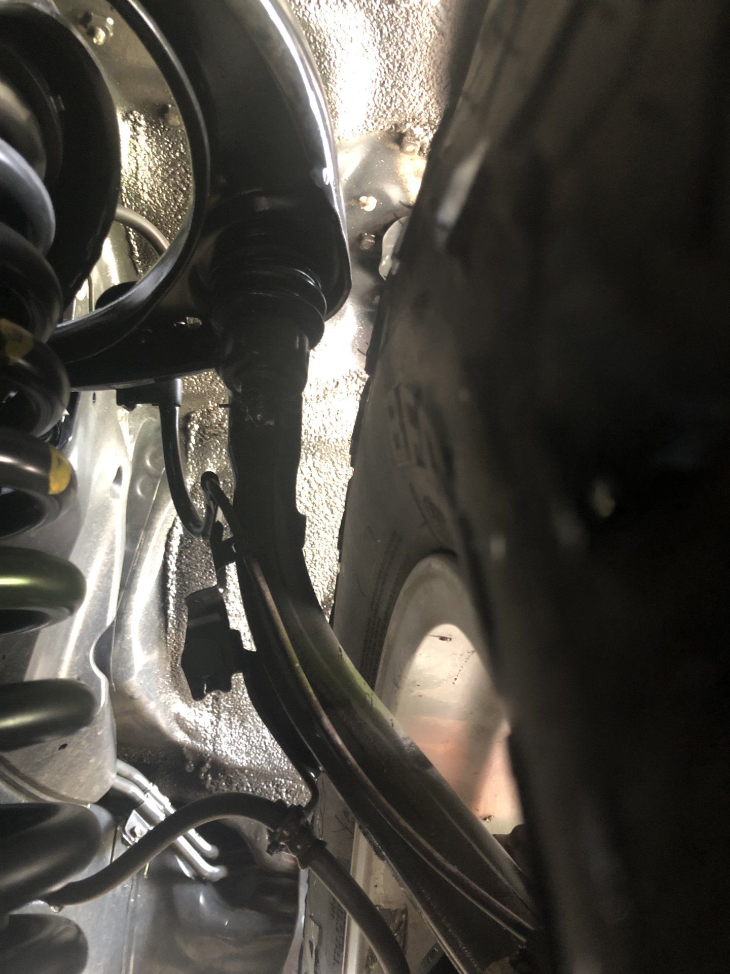

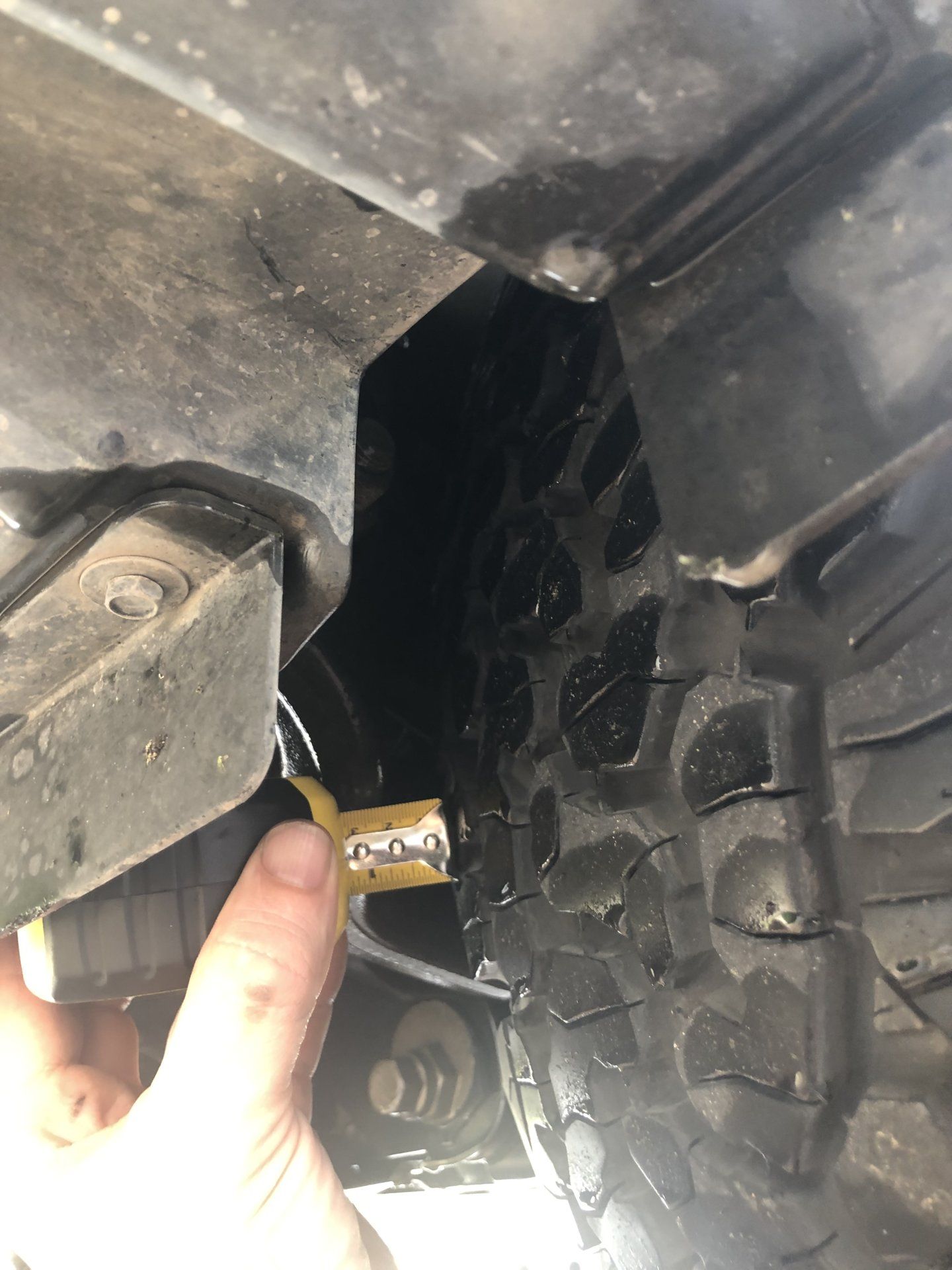

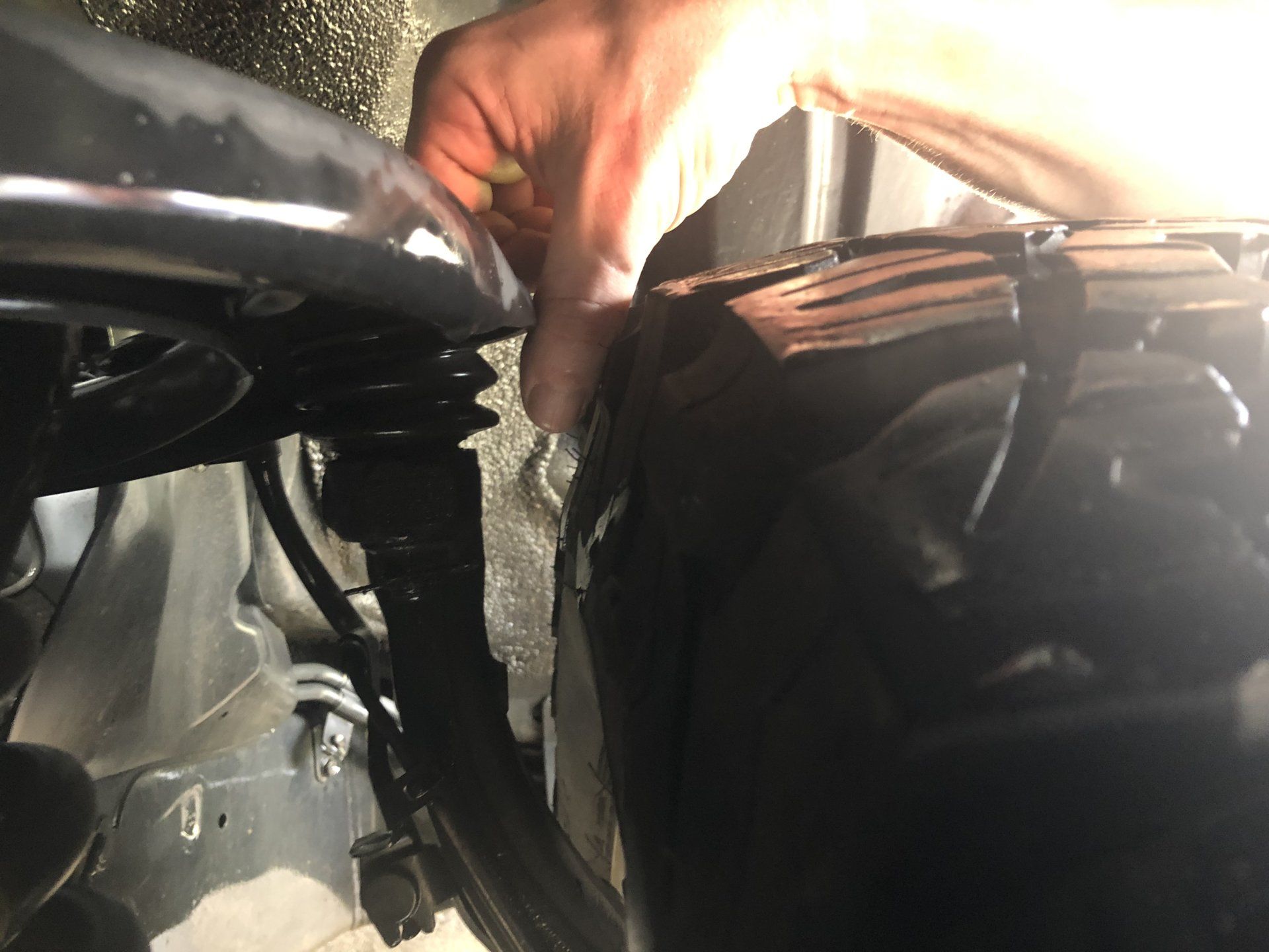

Not looking good for chains in the front. Problem areas would be near the UCA and KDSS arm, as well as the front and back of the tire when turned. and with limited driveway space to maneuver this isn’t even all the way against the steering stop. Harder to get a measuring tape into the relevant areas but I improvised where I could.
For the record I do have the 10mm toyota strut spaces installed. Don’t think it would make much of a difference.

These tires JUST fit without rubbing. I think chains are going to cause damage.

Looks way too tight. There's no chance for front chains given the clearances.
