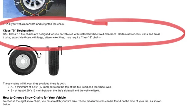

If you have stock tires you could probably run the Z8 on the front. I ran that one or something similar from SuperZ on my 3rd gen 4Runner on all 4 wheels without interference. They worked well on all 4 wheels when going up and down switchbacks on the (smallish) mountain we were on

Clearance is limited around the front tires with stock tires and no modifications. If you do think you may need to install chains on the front or rear, you must pre fit them before you find your self at the chain up area in blowing snow and feeling like you are in a hurry. Off road can be even worse when you only need to crawl out of a shallow ditch 3 feet to the left or right but the ground is covered with ice and a nice amount of snow on top.
OEM/stock diameter in the US is 31.2" I have only driven on stock tires to get the vehicle home and then to the tire shop to remove worn stock after I purchased with 20k mile and chains were not needed at that time of year.
My snow tires are P275/65-18 @ 32.2" and there is not enough clearance on my 200 for "S" rated limited clearance cables or light duty "S" chains around the front tire. There may be room for them if I don't have to turn...

That’s the issue. You need spacers to get the tire away from the upper knuckle to clear, but that makes chains/cables on the edge of the tread hit the front/rear of the wheel well. 200s aren’t designed with a ton of room in these areas and even low profile cables add a notable amount of effective diameter.. with huge consequences if things don’t clear, vs a mild buzz of tire tread hits.

Hi all, good thread here…Seems like “chains” might work up front but not the heavy types, they have to be class S Type??

I can say definitively with my cruiser on stock 285/60r18 tires there wasn’t enough clearance between the tire shoulder/sidewall and the knuckle to run even a class S cable. There just wasn’t enough room. Now if you ran different offset wheels you’d make room there, but start to interfere with the fender liner at full lock.

I ran them on my 3rd gen 4Runner. They're typically called "zero clearance" chains, though you will need a bit of clearance to run them. The clearance is small though, similar to stepping up one tire size in height and width.
If you have stock 31" tires and wheels, you might be able to use them. You'd want to fit them ahead of time and then check clearance in all sorts of directions (straight, full lock left and right, turning with one tire compressed into the wheel well, etc).
If you have larger tires or non-factory wheels then it's likely they will make contact somewhere.

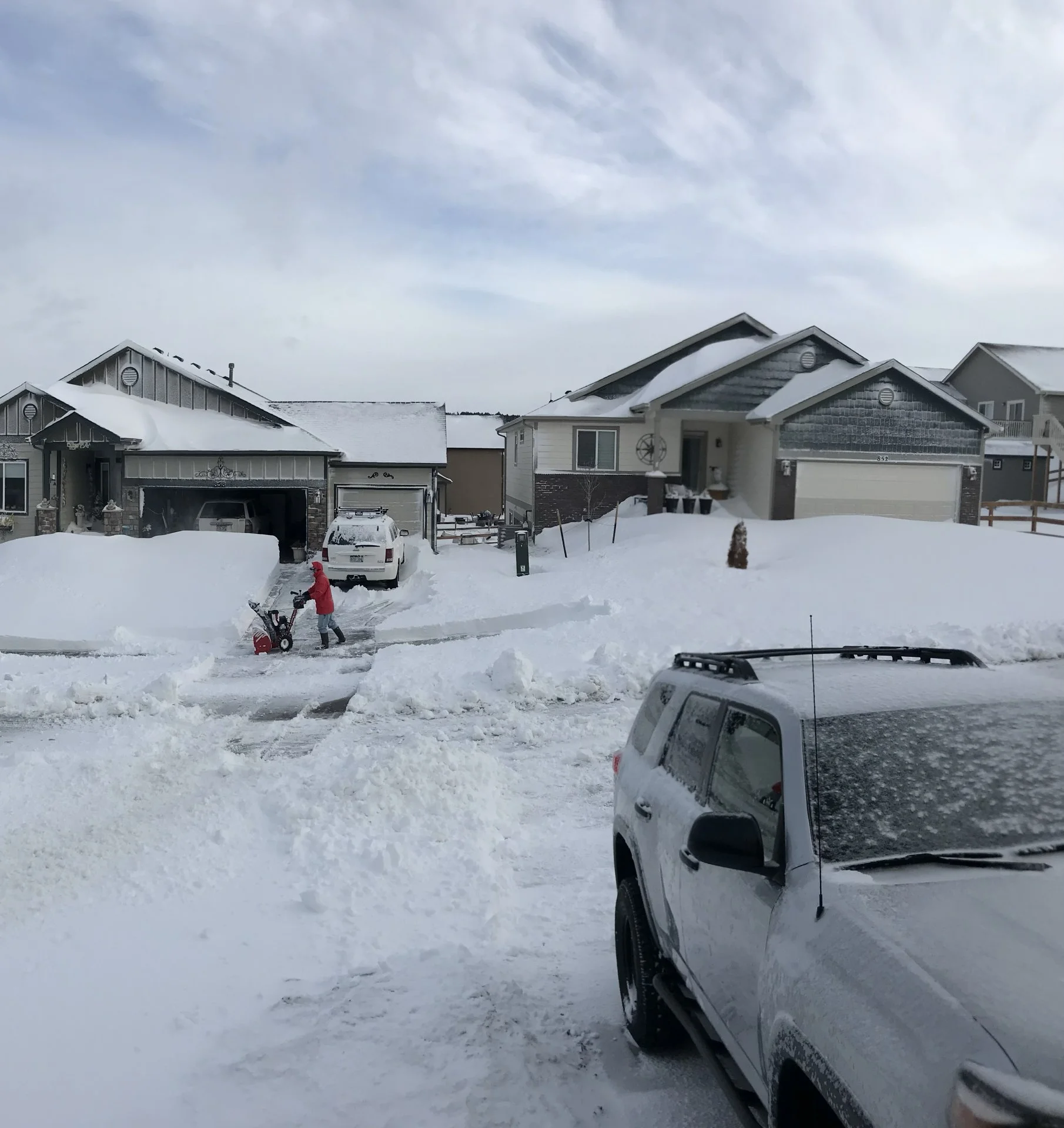

When we had rain that turned to snow in October, I was the only one in my neighborhood who made it all the way up the hill.
This is after the Dong Cyclone we had a few winters ago in Monument.
That’s just straight up ice with 1.5’ of snow on top of it.
I made it home before the snow plows came out.
