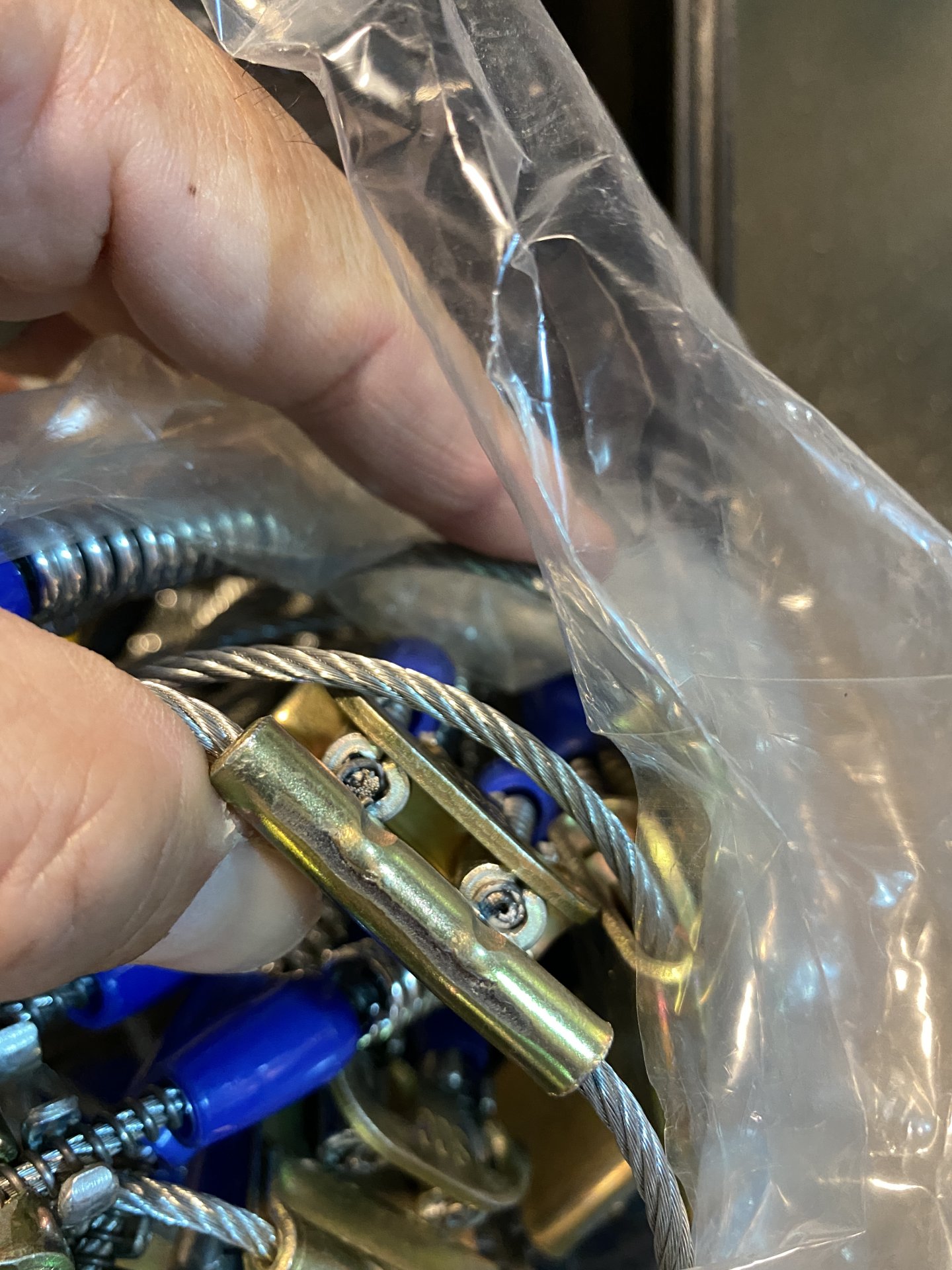

Quick comparison of the Peerless Z SUV/LT with S clearance (the bare cable wire on the right) to the Peerless Super Z6 (blue covered cable in the left). The difference in the clearance seem to be where the depth of the connector plate that holds the side cables to the tread cable holding the rollers. The first two pictures are the side by side comparison. The third pictures is the super z6 connector plate and the last picture is the Z SUV/LT connector plate. Notice how the super z6 plate was about 1/2 the thickness
