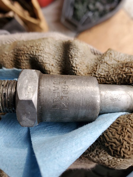

Anyone know if those early screw-in type pcv valves are still available?
From a ‘65 parts book. 12204-60010 doesn‘t show up or show a replacement. Maybe one of the parts hounds has one. Note the “ANTI-SMOG DEVICE (OPT for USA)”notation.
Yup, that's it. Here's what I pulled from my `69. (Cleaned and replaced).
I would try to repair that single barrel insulator. If you can't find the correct pcv, I would try making an adapter to add a grommet so you can run an available version.
i would be open to trying this little guy

I have a few NOS units on the shelf. I just keep cleaning and reusing my old ones. They’re very stout, almost bombproof.
They’re basically just a weight in a tube, right? So keep them clean so the weight moves up and down as needed based on pressure and gravity I guess. The only question with a non-stock valve that has the correct threads to fit is does it match the pressure/weight combo of the original design so it isn’t an ineffective valve for releasing overpressure or for being a vacuum leak, however slight? Wonder if any of those design specs are…well spec’d in any literature anywhere. 🤷‍♂️
