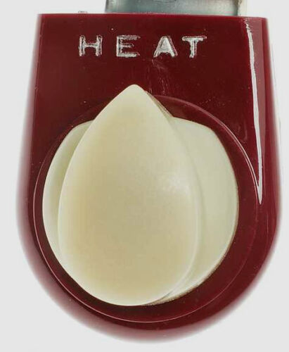

I think this switch is similar to what was used back in the day.
I found that one also after reading several threads. Ordered and on the way. Still blown away that the fan motor works.
