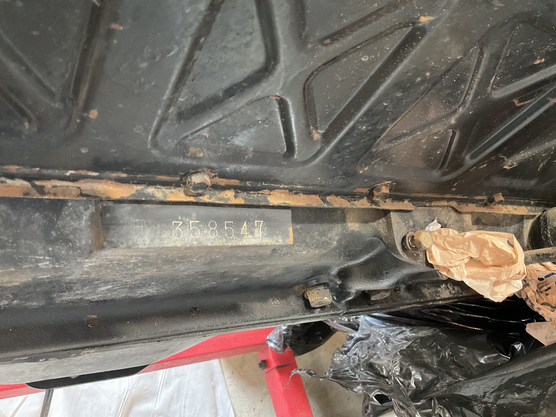

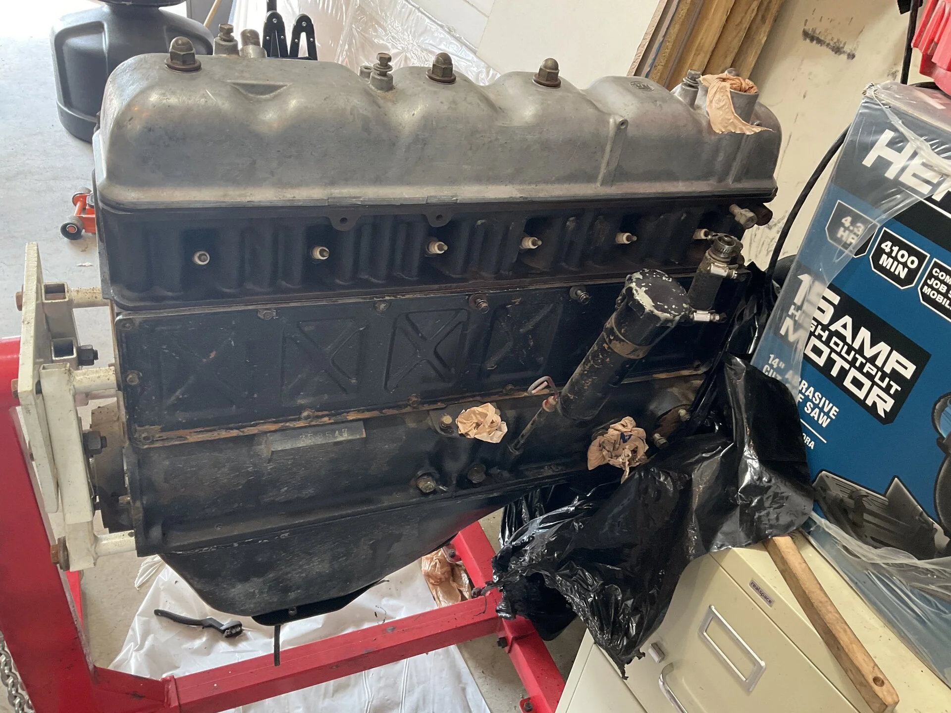

Hi all, I am getting rolling on my restoration on my 1977 fj40. But something looks off with the engine. Can someone tell me what this is (f maybe?) and would here have been a reason they swapped?

Absolutely. The only reason to keep an F engine is that it was original, which is wasn't in your '77.
it is an early F as it has the oil filler into the block
maybe an F145? mid/late 60's

Billings. My dad picked it up in Spearfish SD in 1989. At this point I think I’ll clean the engine up, test compression, and either try to find someone who wants to swap for a 2f or put it back in once I get the restoration complete (which is probably a few years down the road).
My 1971 had the F motor with the oil filler pipe like that.
