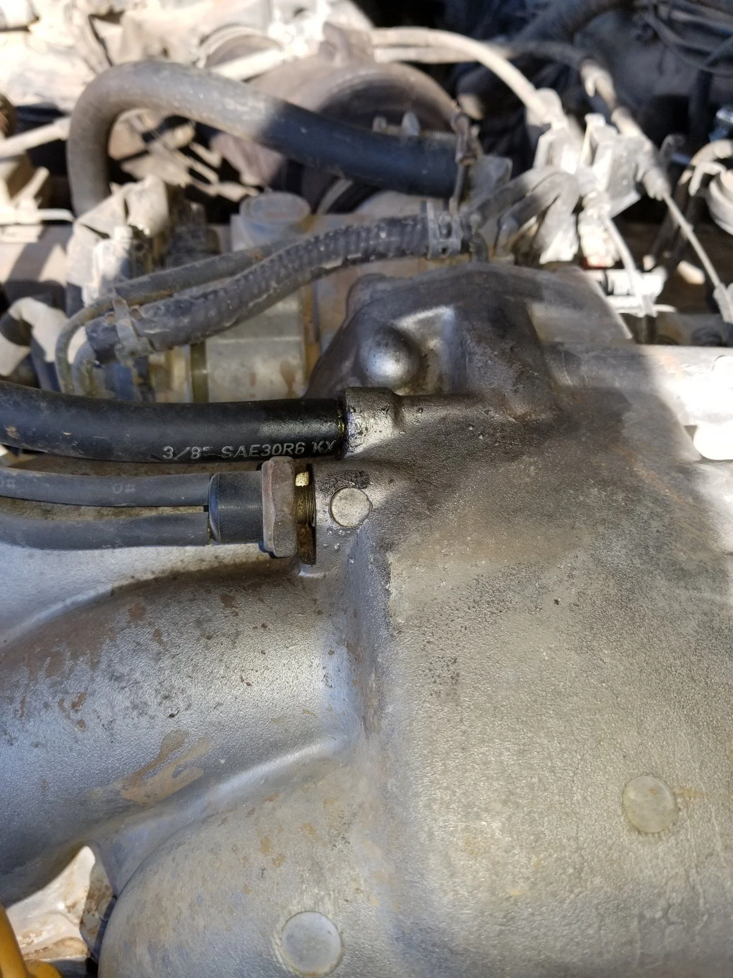

There have been multiple threads on the PHH, and the documentation is plentiful, but I liken this to sales training and inspiration books - they all say the same thing, and you have already heard it, yet we like to hear it said a different way.
My scenario - I have family in town for the holidays and two small kids (1 and 3). My wrenching time is in the evenings after everyone else is either in bed or comatose in front of the telly.
Started at 9pm, at 11pm when I am sitting under the wheel well with grime up to my elbows, my comes out and proclaims that our 1 year old has woken up 4 times and SHE needs to get sleep. Suffice to say, I was disgruntled. After instantly dropping everything it took a full 20 minutes of scrubbing before I was in a fit state to touch the baby and stay up until 2:30 am with him. (for the record, both he and my wife are very worth it.)
Finished in the morning. The brief rest was good to calm my anxieties and frustration of getting the PHH off. Installation of the new hose was EASY.
Here are my comments on the job:
- The designer of the OE clamp configuration and placement of the PHH is a bastard. The first (outside clamp) came off with much stress and a Dremel. Stress because I was scared of cutting too much. The second (inside) clamp is placed exactly in the hardest configuration to get to with pliers. Pure Evil. Finallly, got it off with combination of Dremel, pliers, screwdriver, and a crap nights sleep in between sessions.
-The difficulty of the job is ALL about removal of the old hose.
-Stress? YUP. Time and patience are your best allies.
-I ordered the Green hose from the PHH guy/ site listed in vendors, he accidentally sent the blue silicone - Thanks for that.
-Do yourself a favor and just buck up the extra $5 for the silicone. I have heard that the Gates Green is stiff. The Blue is very flexible and there is not a lot of give to the upper tube. Flexibility is key for the ease of installation.
-If replacement of the new hose with the self adjusting clamps were necessary, it could be done it 20 min easy. They are easy to install and would be easy to remove.
-DO YOURSELF A FAVOR: unbolt the two 12mm bolts holding the upper Transmission dipstick tube and move it out of the way. I figured this out half way through, it was night and day for access. One by the top of tube, and one right by the starter / frame rail area. Both are very easy to access.
-I did not remove my starter (could not budge the 17mm bolt) but did disconnect the electrical to it to get the wires out of the way. Plenty of room for this 6'1'' 240 lbs man to work. (after moving the trans dipstick tube).
-I installed new constant pressure clamps pointing down and to the front. Ratcheting box end wrench (8mm) made their installation easy.
SO, with my right of passage completed,
here is a picture of my OE PHH after removal.
