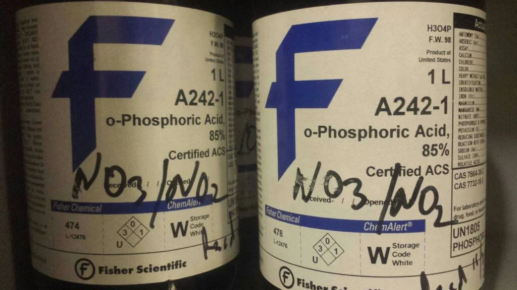

Exactly. I have some 25N HCl in the lab I could test on some spare glass I have. I could also test Nitric Acid, Boric Acid, Sulfuric Acid, Phosphoric acid (as in the Coke)
Disclaimer: Im hoping Coke works, I won't be doing anything with any HCl!
A bath of Hydroflouric Acid was used to remove the CVD film from our equipment. Nasty stuff...goes through the skin to the bone...and not available over the counter in high concentrations, though it is a component in rust stain remover gels.
I don't have any hydrofluoric. I do have hydrofluorasilicic I could test. Of course, Coke is easiest if it gives even results. Phosphoric should do it since Coke worked
85% may need to be diluted :D
