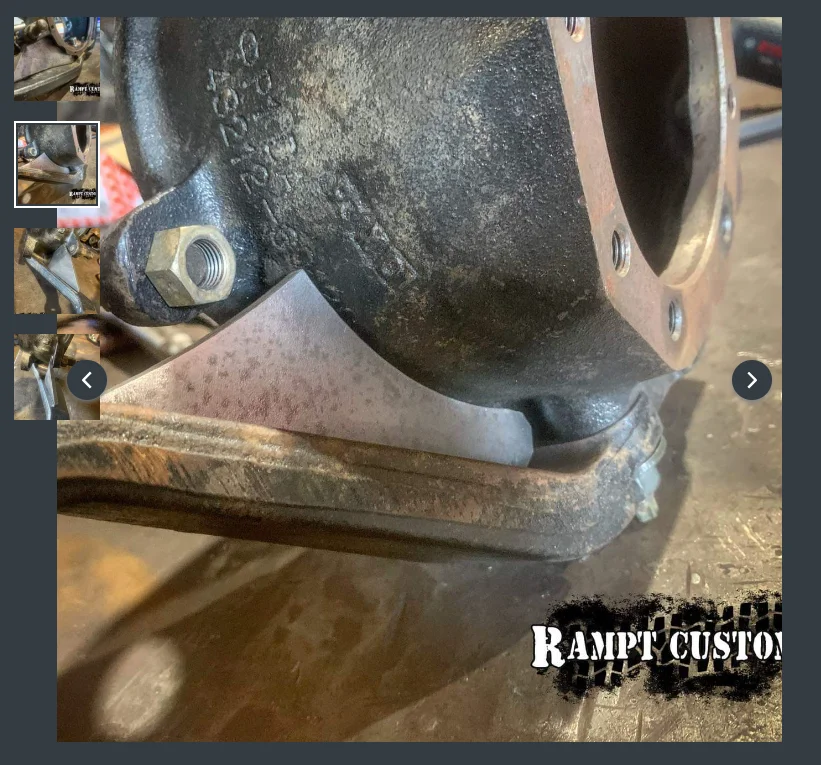

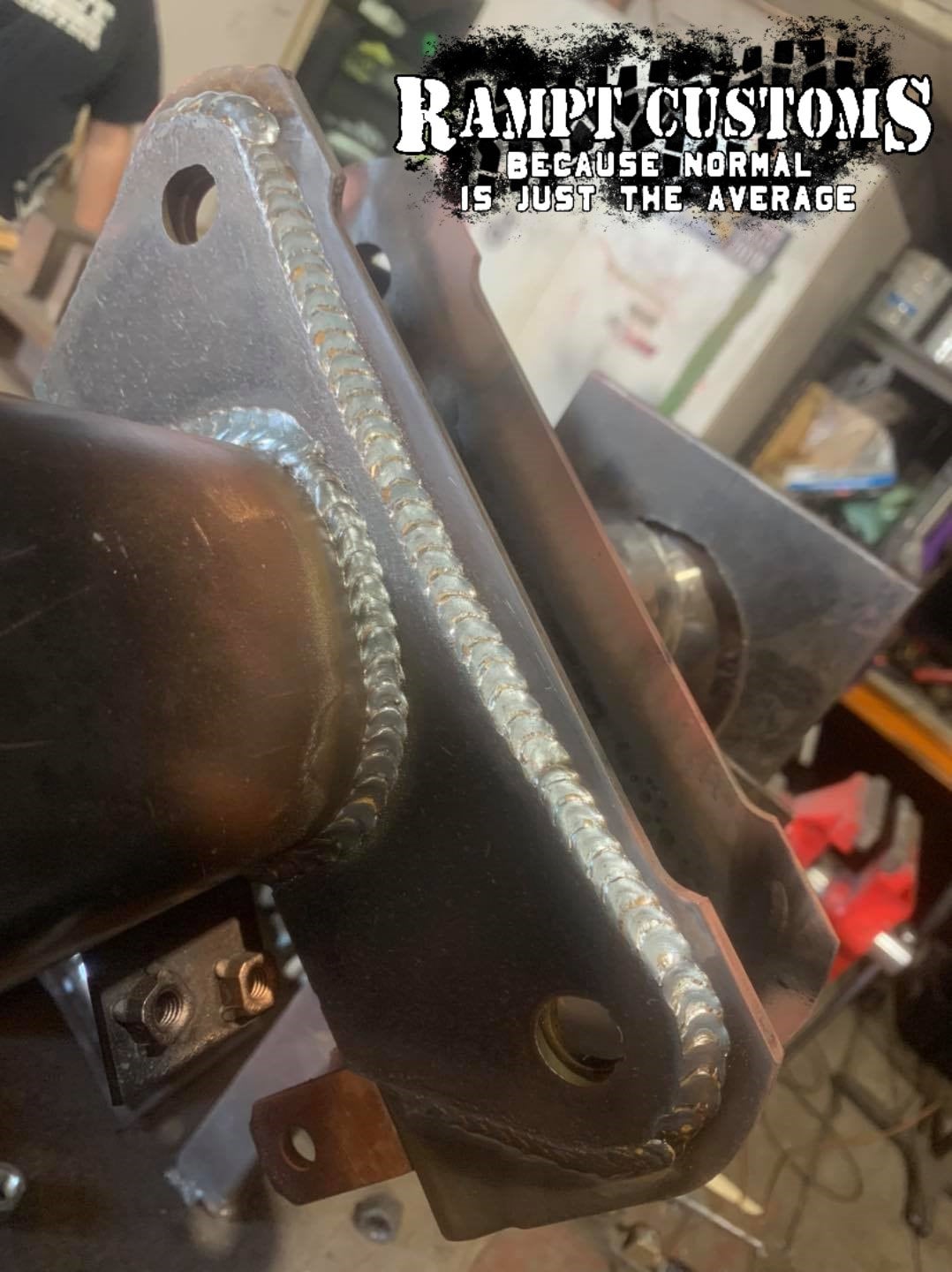

I would use these two products from Rampt.
And sometimes the time saved is worth it for me to. especially when all 4 Control arm plates are different.
At the very least I would copy the design of there knuck-gusset, I really like the way it runs all the way over to the radius arm mount and ties in.

That's exactly my plan, copy Rampt for the truss and the steering gusset.

Anyway, the mini truck guys usually fab similar knuckle gussets out of angle iron. Looks like Rampt is trying for a two piece design with an angle a little tighter than 90, but I don't know why angle wouldn't work.
I like the Rampt brackets. I probably would have used their knuckle gussets if I found them before the front range version.

they're the first one who has a steering bracket, thought it was quite interesting. This is for racing applications but why not just do that "while I"m in there"?

If I was going to add reinforcements like pictured I think I would Use two overlapping plates like pictured. One welded to the arm and the other welded to the knuckle. Then drill 2-3 bolt holes thought them, so they could be bolted together. That way you can disassemble the knuckle and arm with out having to cut them apart.
I was of course assuming that the gusset was intended to be welded in?

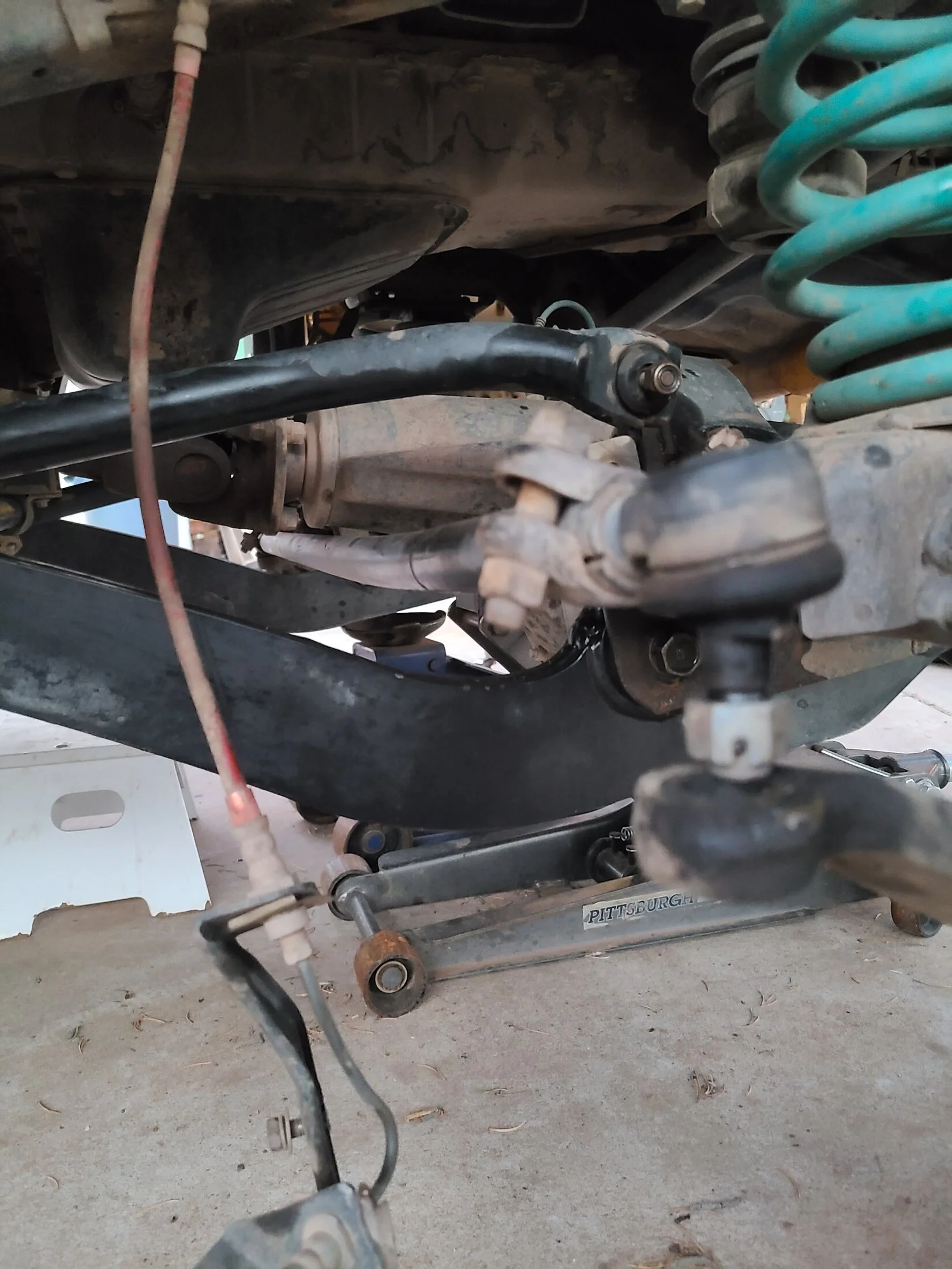

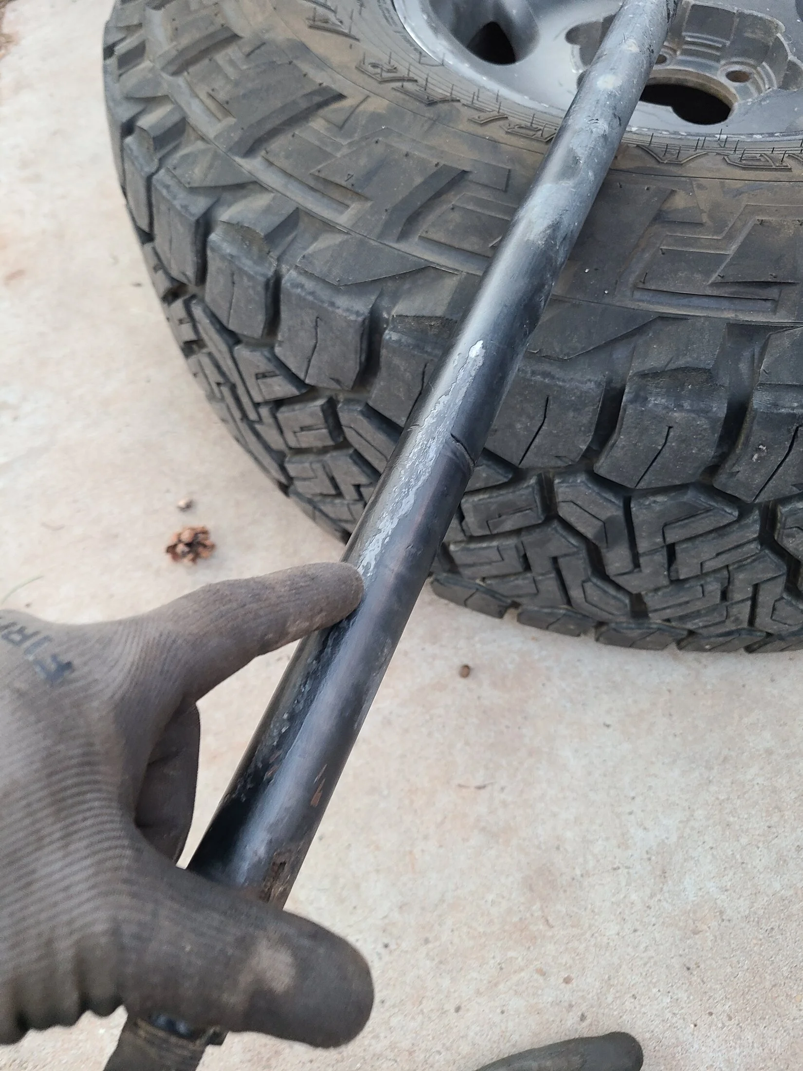

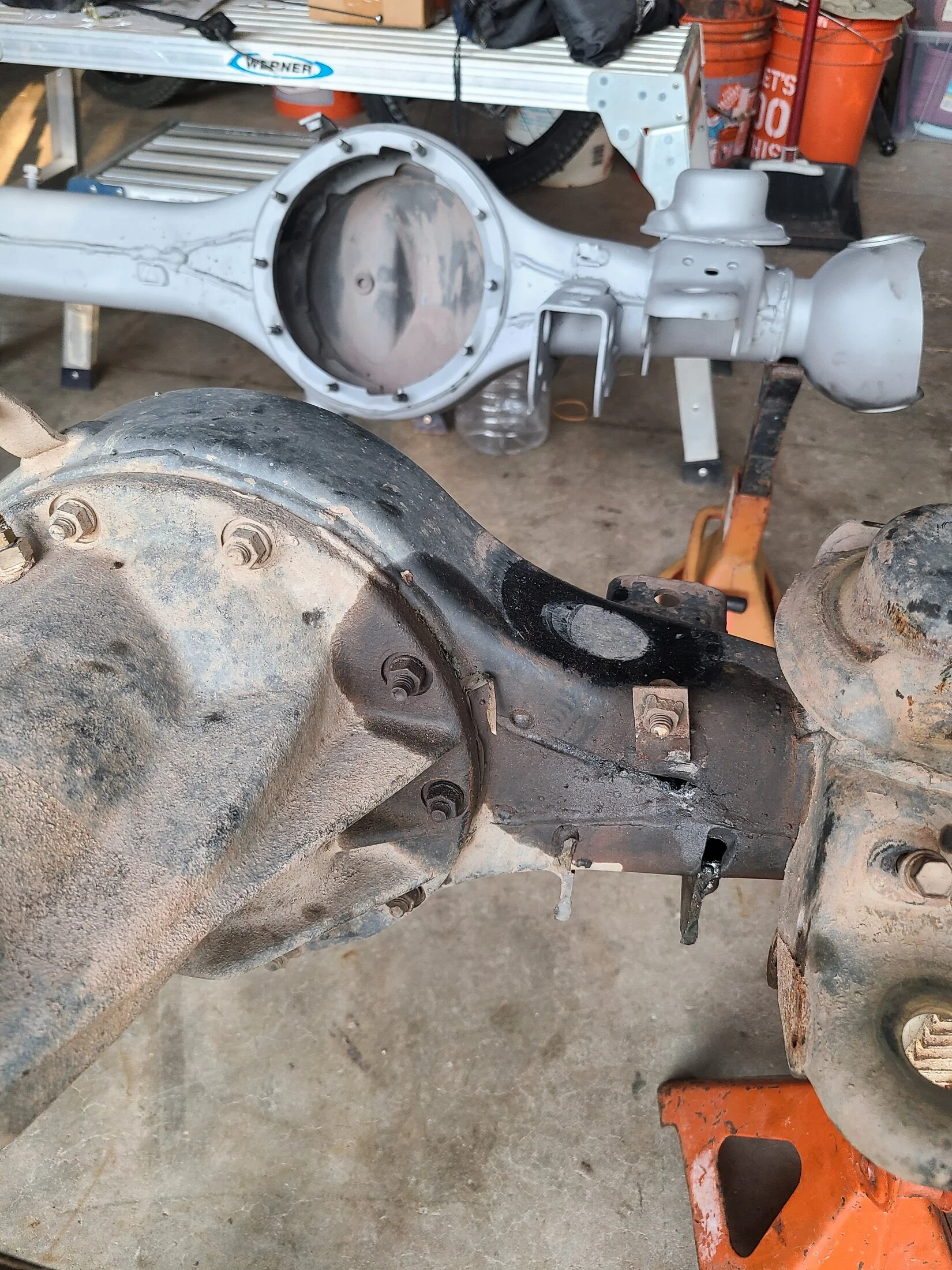

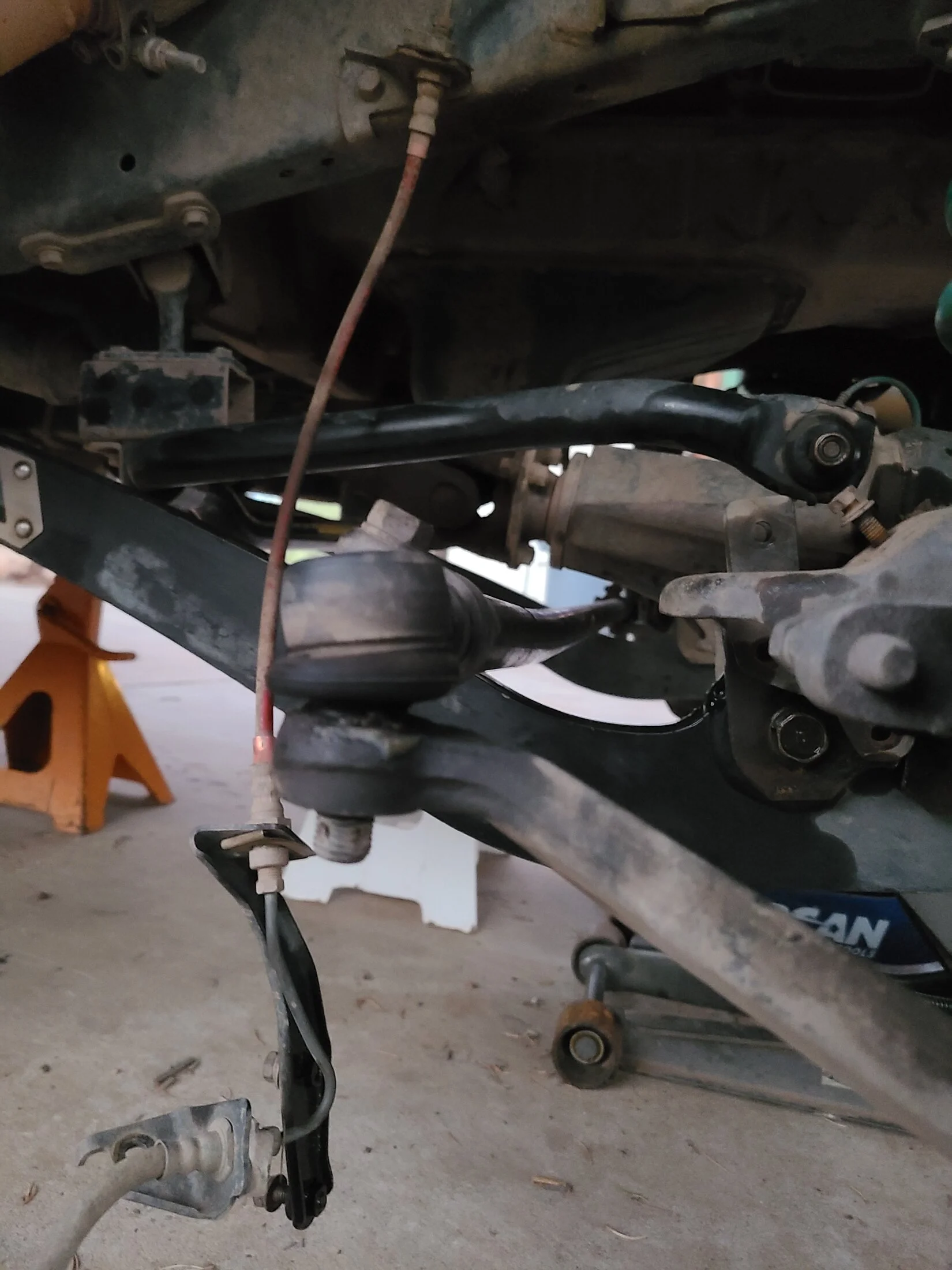

Snapped these shots of the tie road bend, would like to find out the cause!! I didn't see an obvious contact with rear diff but will inspect it closely once out of the vehicle. I know it was straight before going to UT on the first week of Sept.
Is that an upgrade tie rod? If so it took quite a bit of force to put a permanent bend in it like that. I wouldn’t invest much time in concocting a story to satisfy your need to know why or how. Fix or replace and move on.
How’s that axle repair welding coming along?
Edit: I took a closer look at the photos and in all my experience, I can tell you, that’s not an upgrade tie rod. Haha
Correct, that's an OEM tie rod. New one will be OEM also. No work has been done, busy with daughter's 3.4L with a blown HG 🤬
I think she's dead, Jim 😞

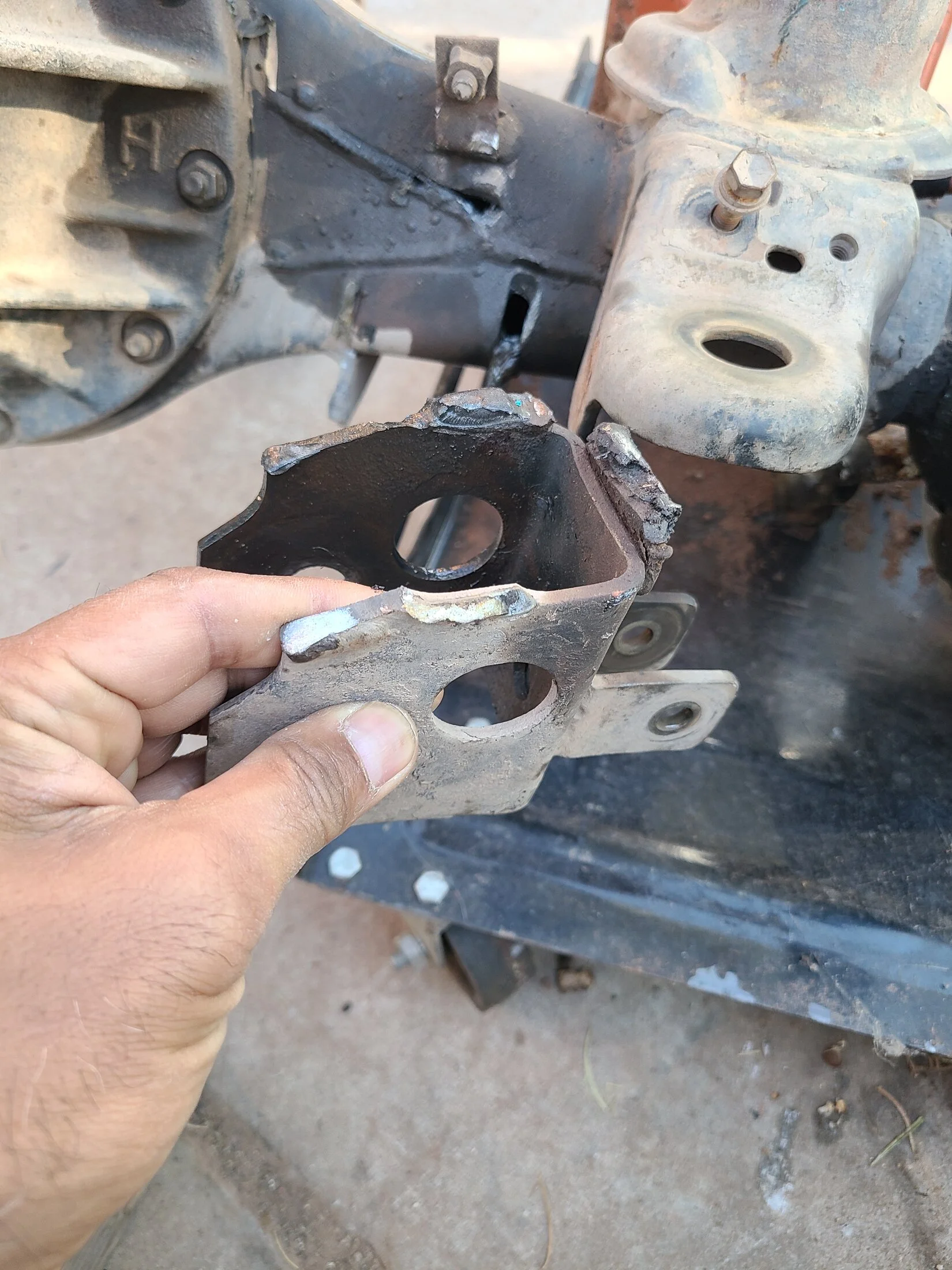

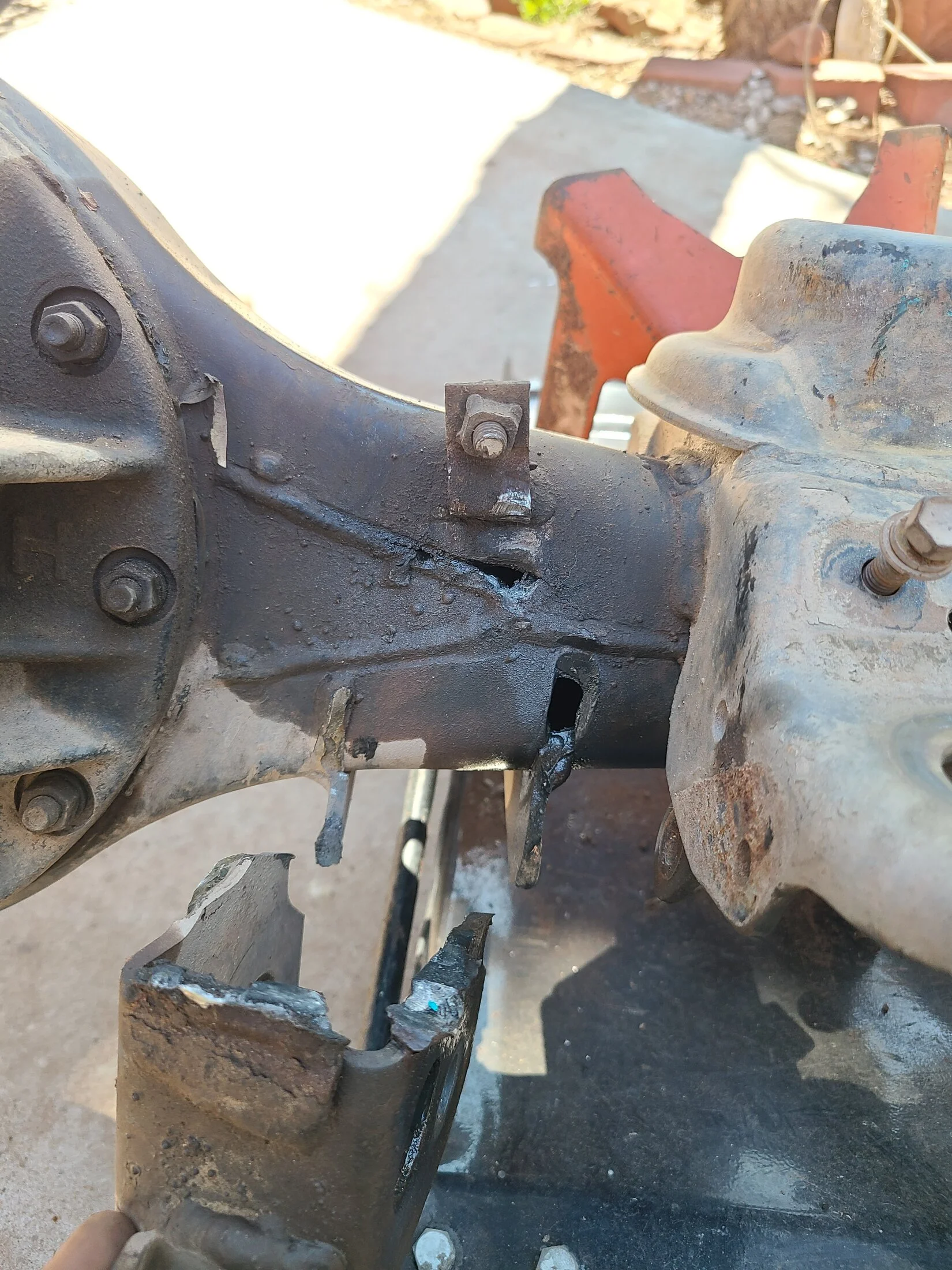

The broken half of bracket fell off as soon as the bolt through it and the radius arm was removed. 😮

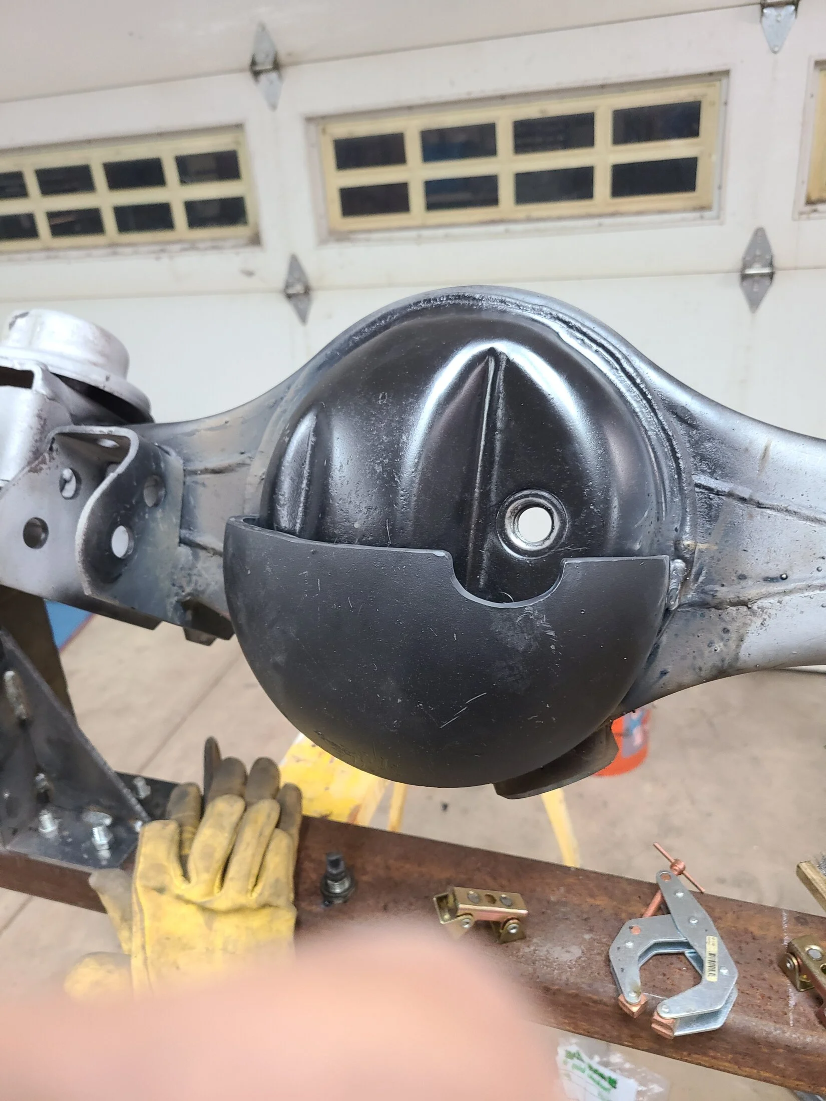

I think I figured out why my tie rod end got bent. When this side of the axle bracket let go, there was fair amount of contact on top and also under the tie rod. Here is the picture of both sides.

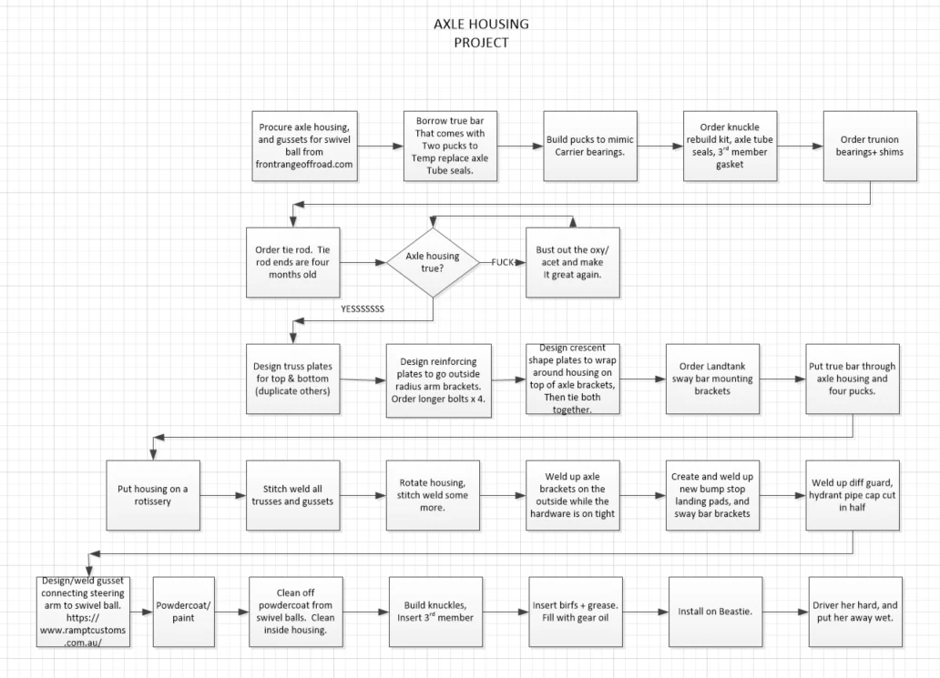

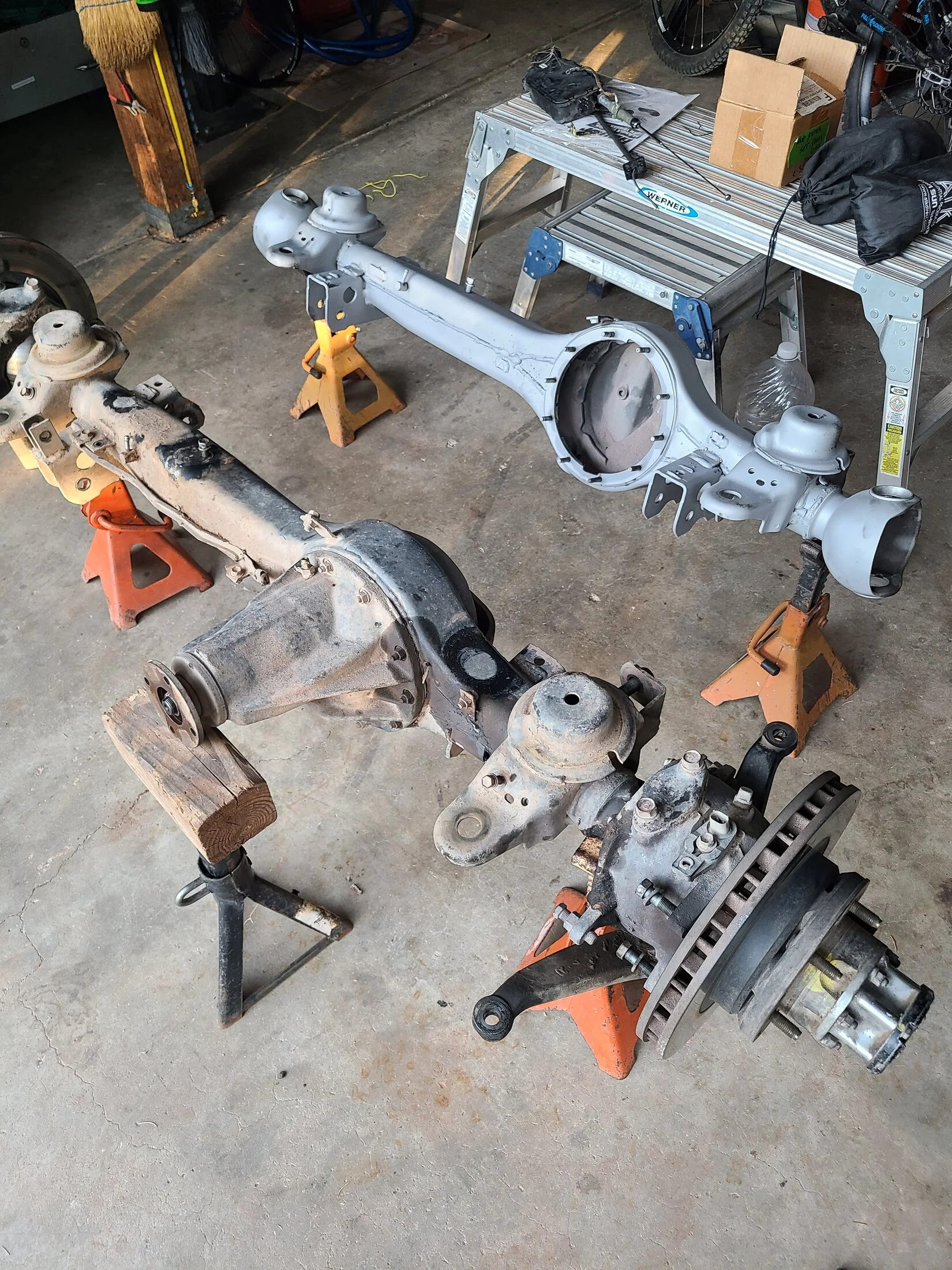

Axle housing modifications

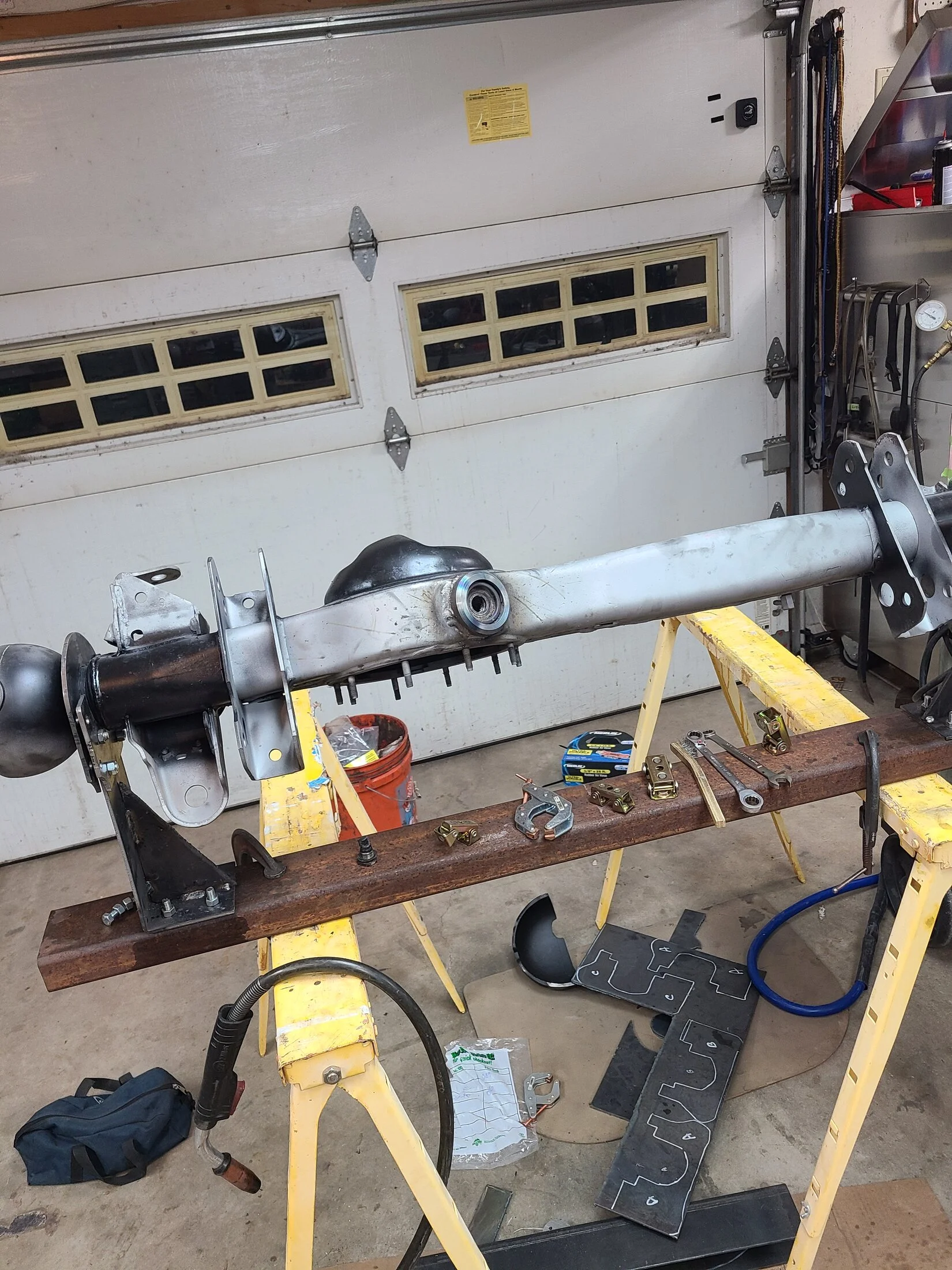

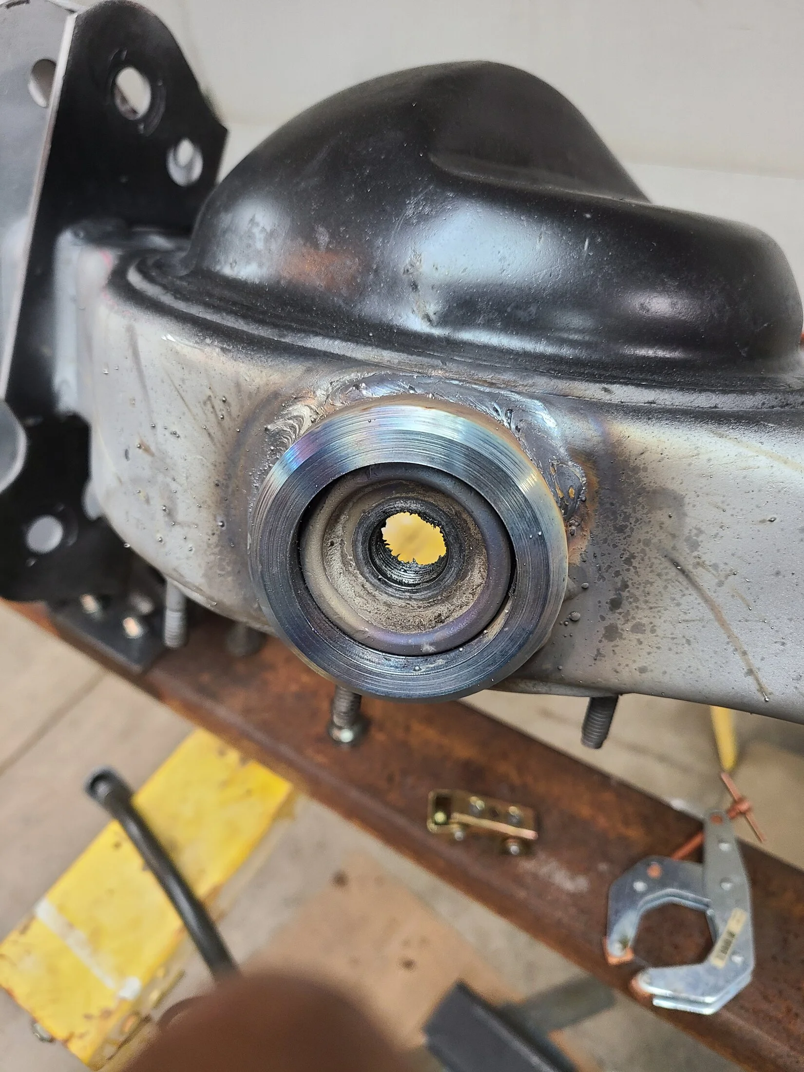

The jig is complete, and minor welding has begun. It's so nice to be able to rotate the housing as needed for welding and mock-ups. The jig was built with flexibility in mind. If I ever want to do the rear axle housing, all I have to do is come up with a couple of simple collars. I guess even a non Toyota axle housing could work on this jig.
Right now the collars are loose which makes it easier to rotate the housing as needed. After I'm done mocking up the trusses and the ball gussets, everything will be tightened down, and a jack will be placed under the differential to give it some tension while welding.
