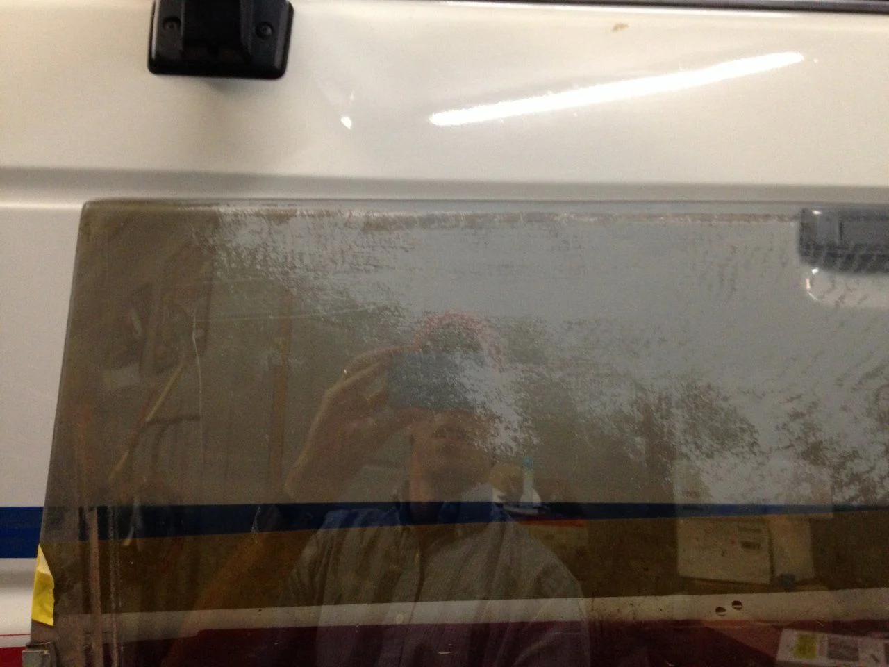

This is the inside of glass, where the reflective/tint coating is.....
Outside of glass....
Outside of the glass in front of white cruiser......
How long did you have to leave it on for? And did you simply wipe it off? I'll be doing this to all my windows if this really works.

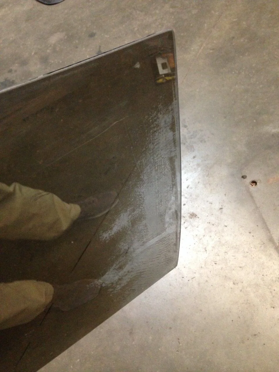

I sprayed it on and let it sit for a few minutes, then used a scrub pad for a few minutes and this is what I got, very little effort. Im going to verify that there is no damage or scarring to the glass, so check back here and ill post further results....
I first wanted to verify that it can in fact be removed.

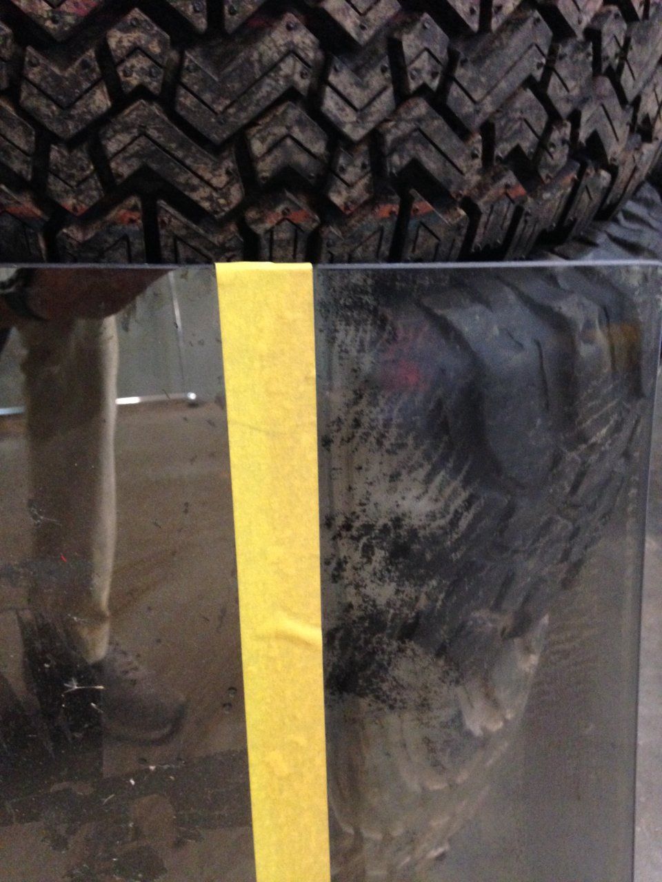

So it looks like the area where I sprayed and scrubbed, the glass is cloudy. But the area where I just sprayed and kind of rubbed it in with my rubber-gloved-hand and let sit for a while, the glass is clear.
Obviously the pad I used is too abrasive.

You can see the remnants of the coating on the right lower edge and lower edge of the glass. Some areas of the glass are now a little cloudy, so Im going to look into a glass polish to take care of that. (there is some clear packing tape still on the outside of the glass)
