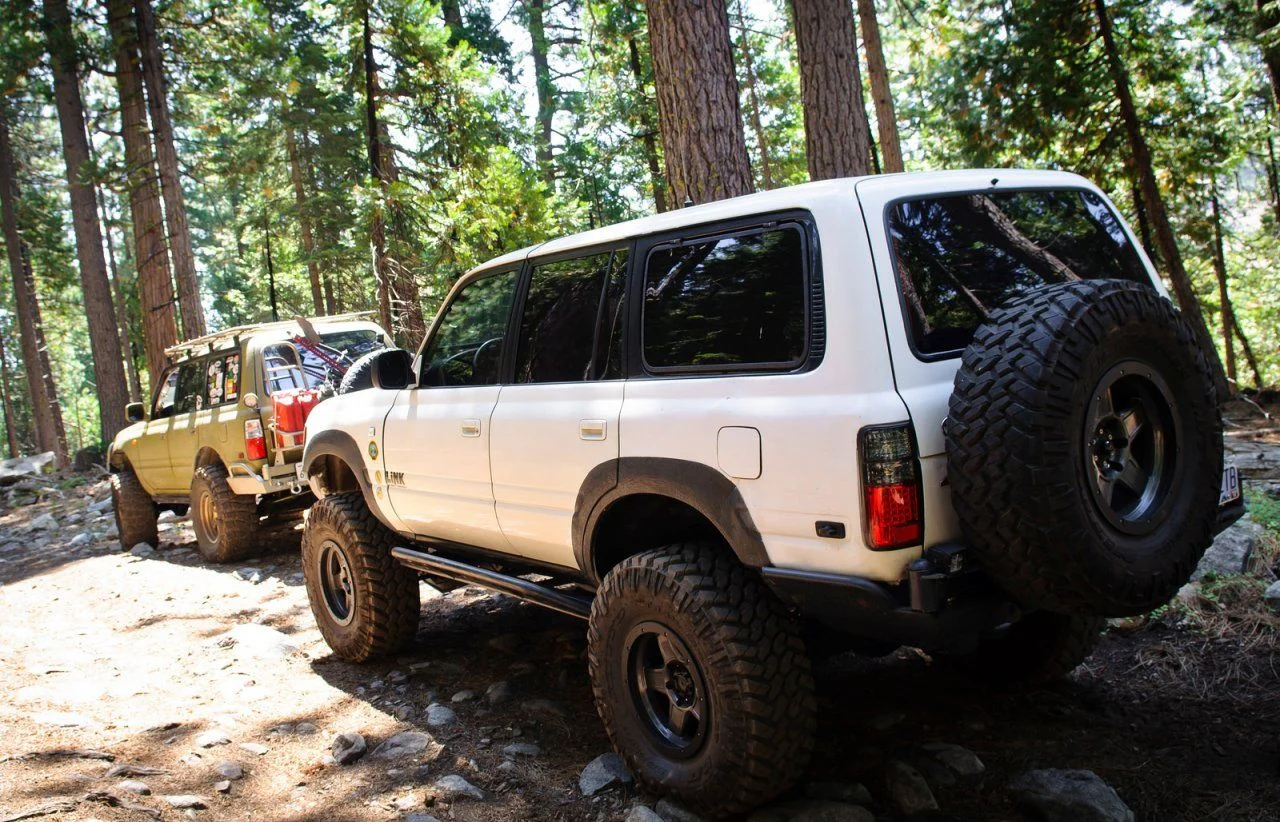

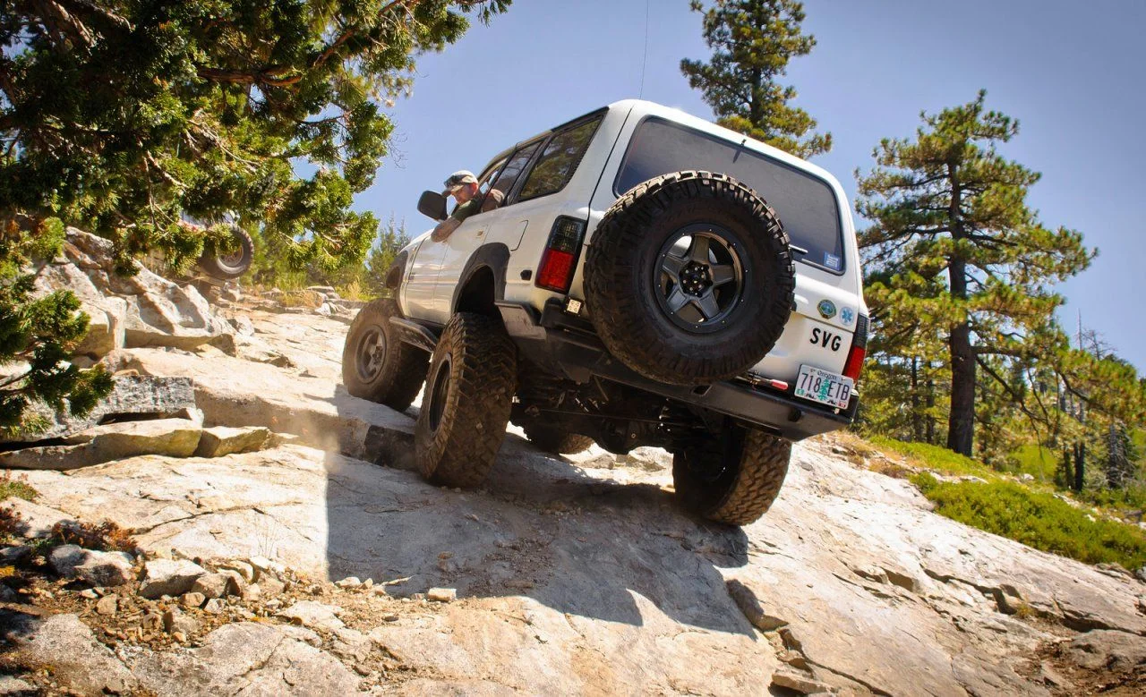

Here's my finished product...

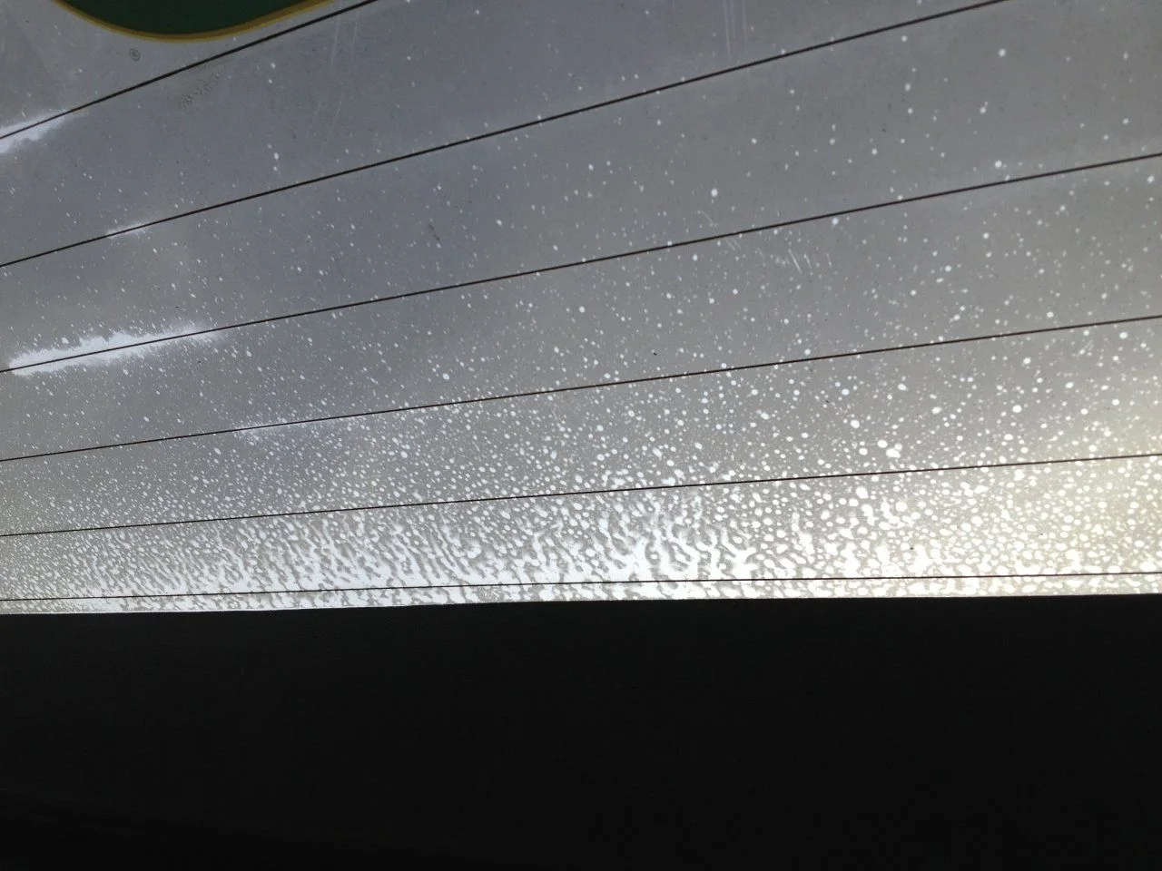

I found a junked 80 series Ina pick and pull that had a spray type pattern on the back tint that was "clear".
I bought the glass and uses a acid solution and was able to remove all of the factory tint...

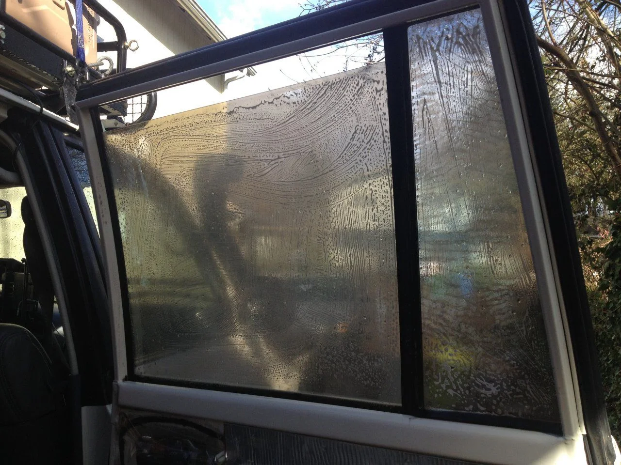

When I tried the same process on my side back windows it "frosted" the glass making impossible to see through...
I had to buy factory clear for the sides but now I have all matching clear that has since been tinted black.

What product exactly did you wind up using to remove the rear factory tint? Did your defroster remain in tact?
that is interesting... The rear hatch glass tint came off, but the side widows etched?
It must be a different film on the glass that moves compared to the glass that doesn't move...

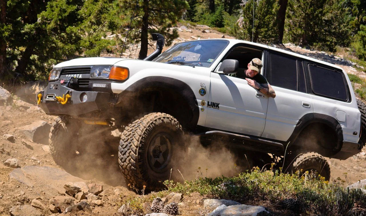

Looks so much better with black tint on there. I really dont like the oem mirror tint on my 80. Doesn't match with the front tint I put on. I brought it to a tint shop and they said they can't match the oem stuff.
Just last week I came across pictures of the process on my computer. I'll see if I can find them again and post up.
As for product... A buddy gave it to me, he used it at his detail shop to clean wheels.... It was an acid solution from what I recall...

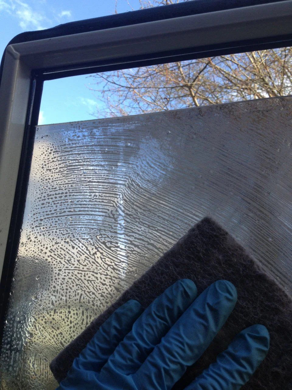

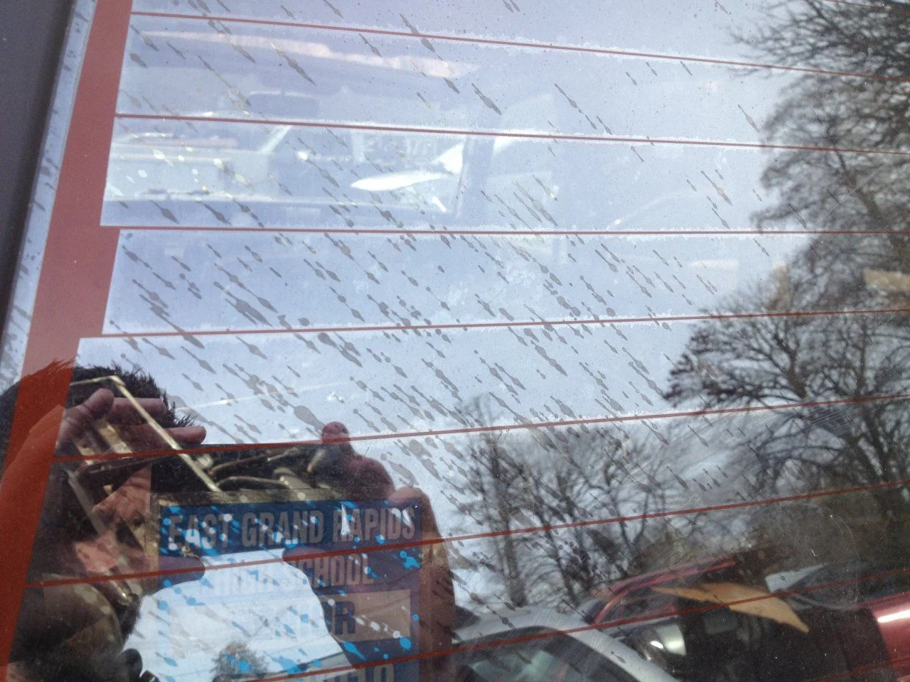

Here are pics of the back glass i found in the junk yard that started me wondering....
And here is the side glass with the same acid process... Needless to say it didn't work.
Unless your going for frosted glass... Don't wast your time and money. Buy clear factory glass for the sides. It's pretty cost effective in the scope of things.
The back rear glass is the expensive one, so if focus attention on that vis various methods to return to clear to retint like I did.
-A
But from the pics I posted, a simple sticker left on the glass for a long time and then peeled away left clear glass. So there has to be a way to "detint" the sides, without frosting it.
Dude if you can find a way, best of luck. I hope you find it.
Just posting my findings, you will notice in the last picture with my (blue glove hand) a "clear J" that was the only place on all 4 sides that came somewhat "clear". And even then the glass was frosted, you couldn't see out of it.
Again, hope you prove me wrong. However I did spend 13yrs in the window business and learned a few things about glass manufacturing. Not to say I couldn't be wrong, but don't want to see folks waste money when you can order factory clear and not worry about it. The back glass is the $$$ glass so if you can remove the tint there, your saving some serious $$$.
