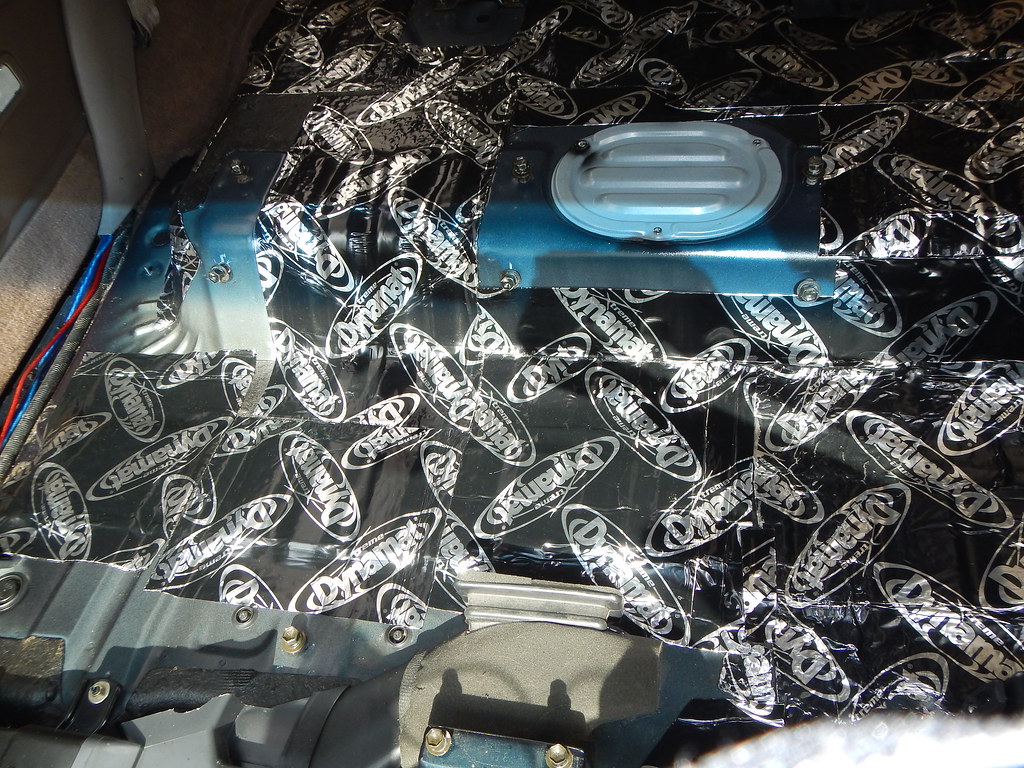

Yesterday - took out all the seats, and the original carpet (blech!). I've already finished Dynamatting the rear cargo area, and now that the front carpet is out, and the final prep work is done on the floor areas will finish with the Dynamat.

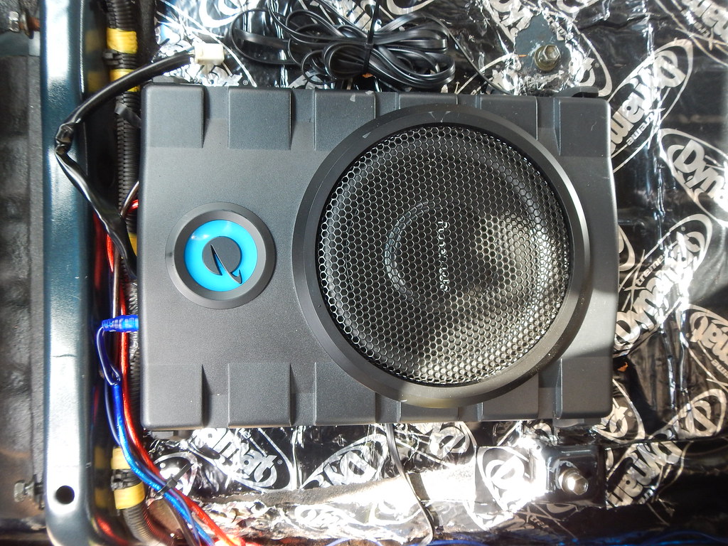

Planet Audio P8UAW Powered Subwoofer
(installed under the driver's front seat)

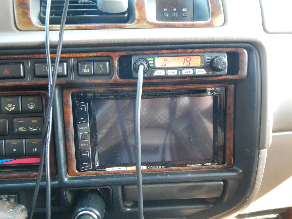

AnyTone Smart CB Mobile Radio/transceiver 10Meter with FM/AM mode, Frequency Range:28.000-29.695MHz Power output 8Watts FM/AM Radios Mobile Transceiver (Fits just right in the slot that's reserved for a cup holder) (comes out of the box set for Germany's freqs on 11 meters, and what a coincidence - it's the same CB channels we use!) (with a simple solder mob output can be easily switched between 4 watts, and 8 watts)

Did you use the bracket to secure the CB radio in that location, or is it so tight of a fit that there is no need to worry about securing it in?
I used a plastic epoxy, and created a ridge to keep the radio from sliding forward. Once it's in the slot, and installed back in the dash - it's a nice solid/snug fit. Wish I had taken a photo...RATS!
Here's some interesting information for a MOD to increase the output power from 4 to 8 watts on 11 meters. I did the mod on mine, and it works great.
"This is a good radio for the price and will fit in any vehicle or atv. De-solder OP2 and solder OP1 to keep the high power. Use band D for 11 meter CB. This is great for a holiday road trip or for local traffic reports. If you want something loud and swings, get a galaxy. The direction that come with it are about useless. There is limited but helpful info on the net. I put mine on the meter and get 3.5w on low and 10w on high."
This is what I found on the net. He is saying both OP1 and 2 are closed from the factory.
Anytone Smart / AE-6110 Internal Jumper Configurations
One way to know for sure -- Amazon.com: AnyTone Smart CB Mobile Radio/transceiver 10Meter with FM/AM mode, Frequency Range:28.000-29.695MHz Power output 8Watts FM/AM Radios Mobile Transceiver: Sports & Outdoors
Read the reviews. Order one, and check it out. When I get a chance (right now I'm fighting a nasty spring cold) I'll put the SWR/PWR meter to it, and take a short video. Like I said - I did the OP Mod, and this little puppy cranks.

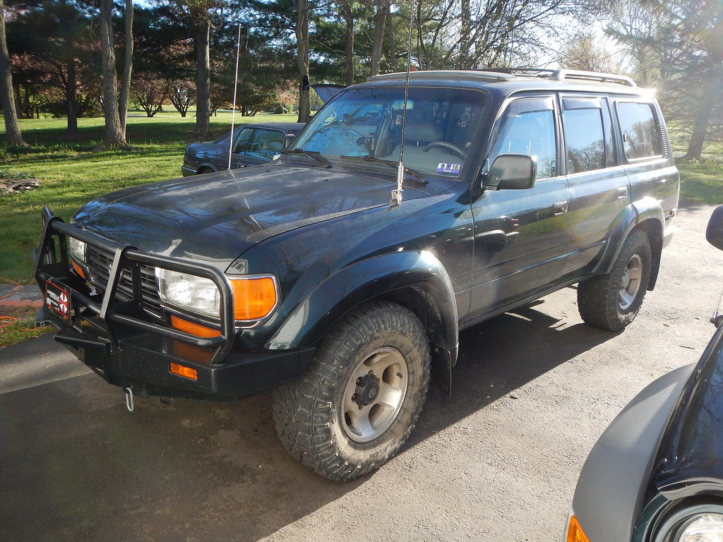

Also I mentioned a remote speaker for the AnyTone since I have it mounted in the dash. Here's the external speaker, antenna mount, and antenna I went with....
COMPACT 5-WATT SPEAKER
FIRESTIK FS CB ANTENNA (5 Foot)
ADJUSTABLE UNIVERSAL HOOD MOUNT
HEAVY-DUTY CB ANTENNA SPRING
Everything seems to be working and my SWR is less that 1.5 to 1 across 11 meters.
