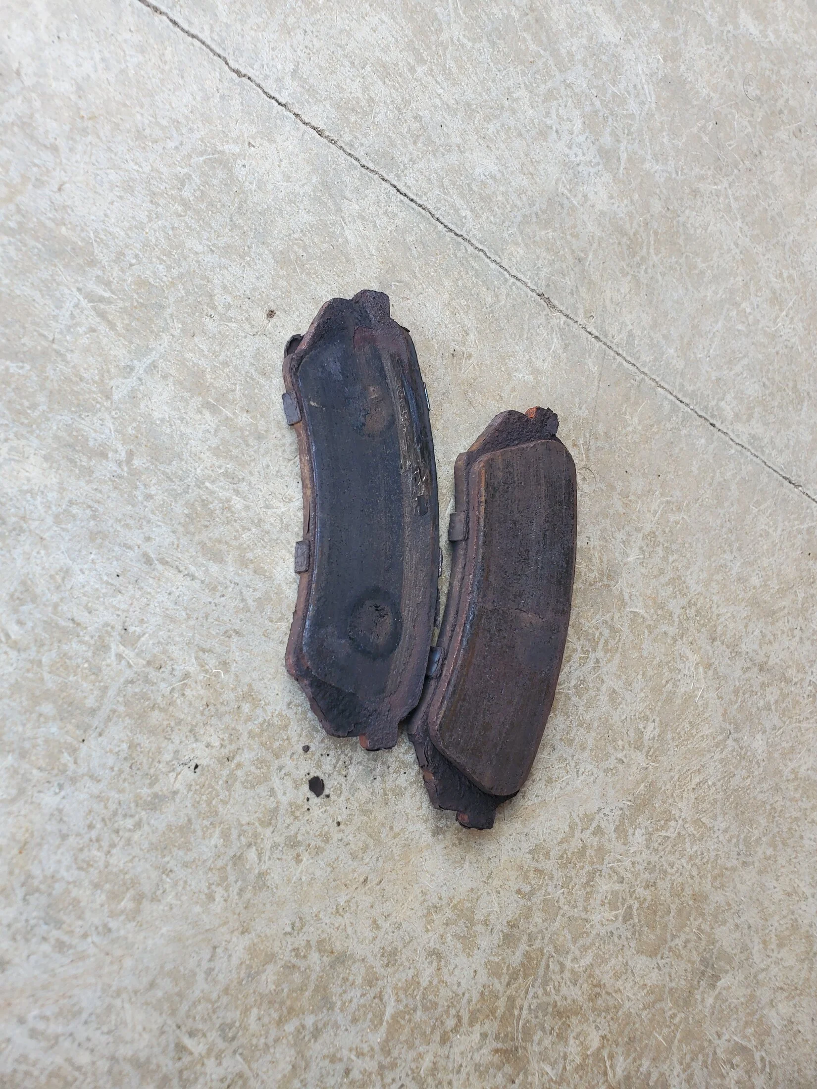

Nearly 2 years and 30K miles later, DBA pads are done and there is a nice groove in the disc too! Not sure if that is the usual life for " heavy duty" brakes.
I plan to switch back to Bosch Quiet cast disc and pads set this time around.

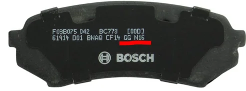

BOSCH: C773501249 Rotor & Brake Pad Kit $146.79 - hopefully they last longer than 30k miles.
Bosch seems to be the only pad with GG ratings - OEM Toyota has FG rating:

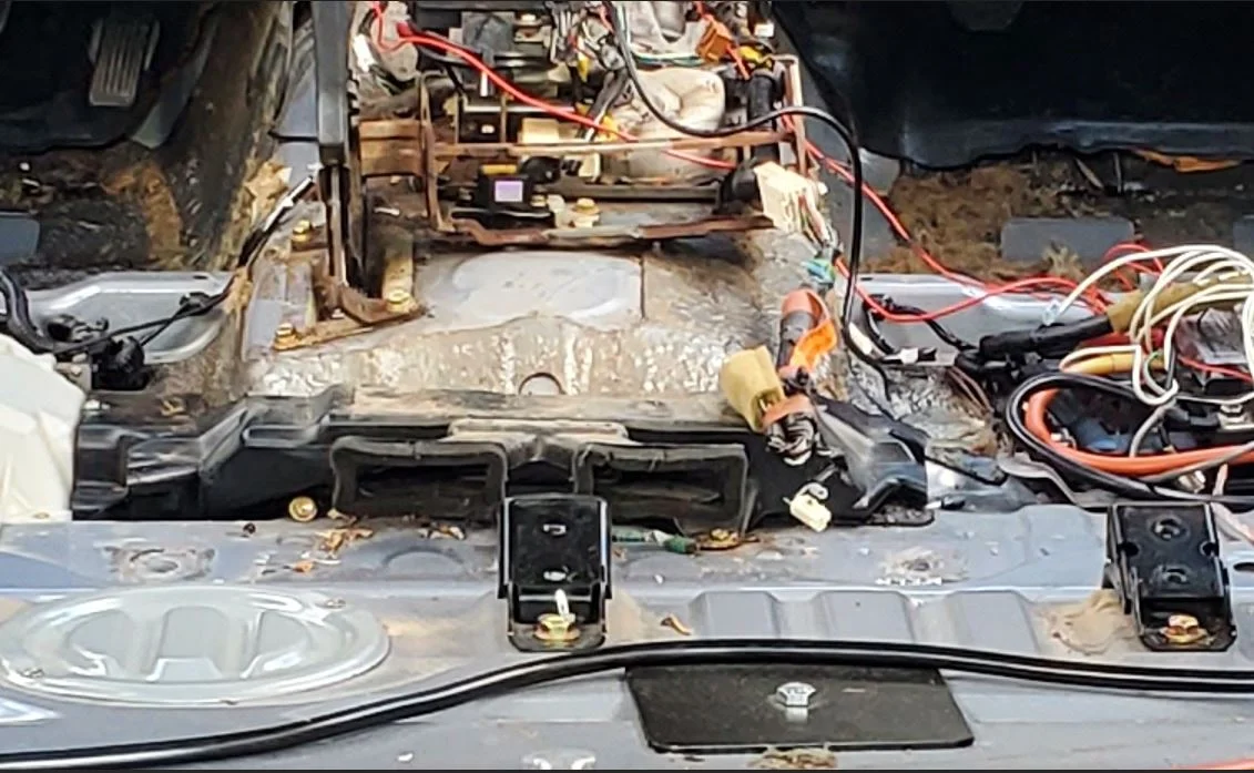

The rear heat vents in my truck are paritally blocked where they come out under the front seats. They were slightly raised from their usual place when I installed sound insulation to clear the extra padding under the carpet. Now the air flow coming out get's partially blocked by seat rails.
This results in two problems:
  1. The center outlet gets the lions share of heat, to the point of burning the feet of the center passenger
  2. The side openings send most of the heat up between the front seat and console, leaving the rear side passengers pretty cold.

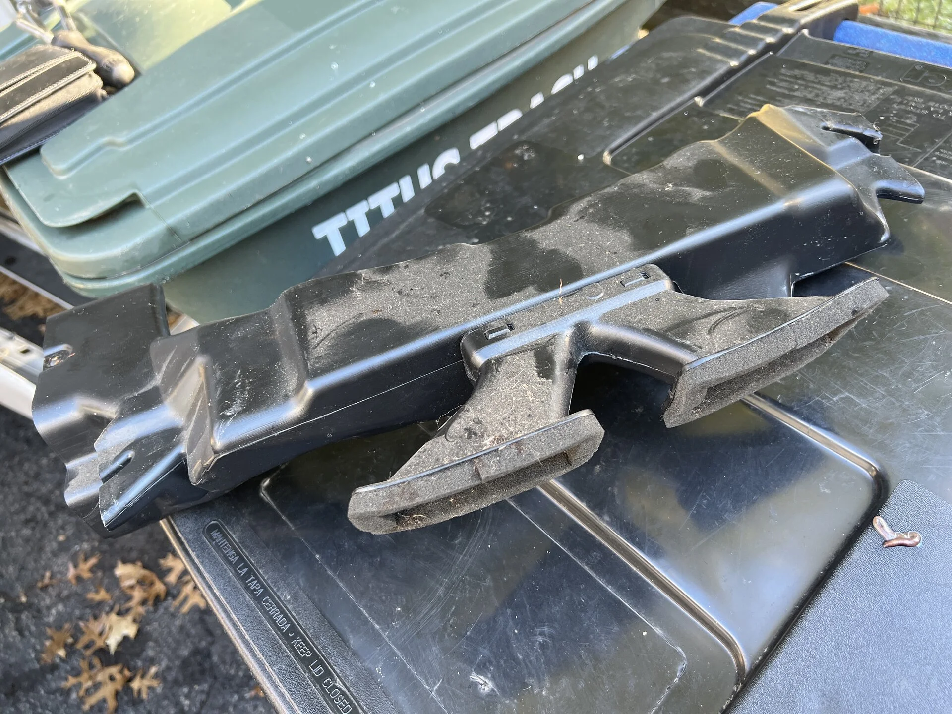

Here is what the rear vent looks like, installed and in hand:
I am looking for ways to make the air flow to the rear passengers better.

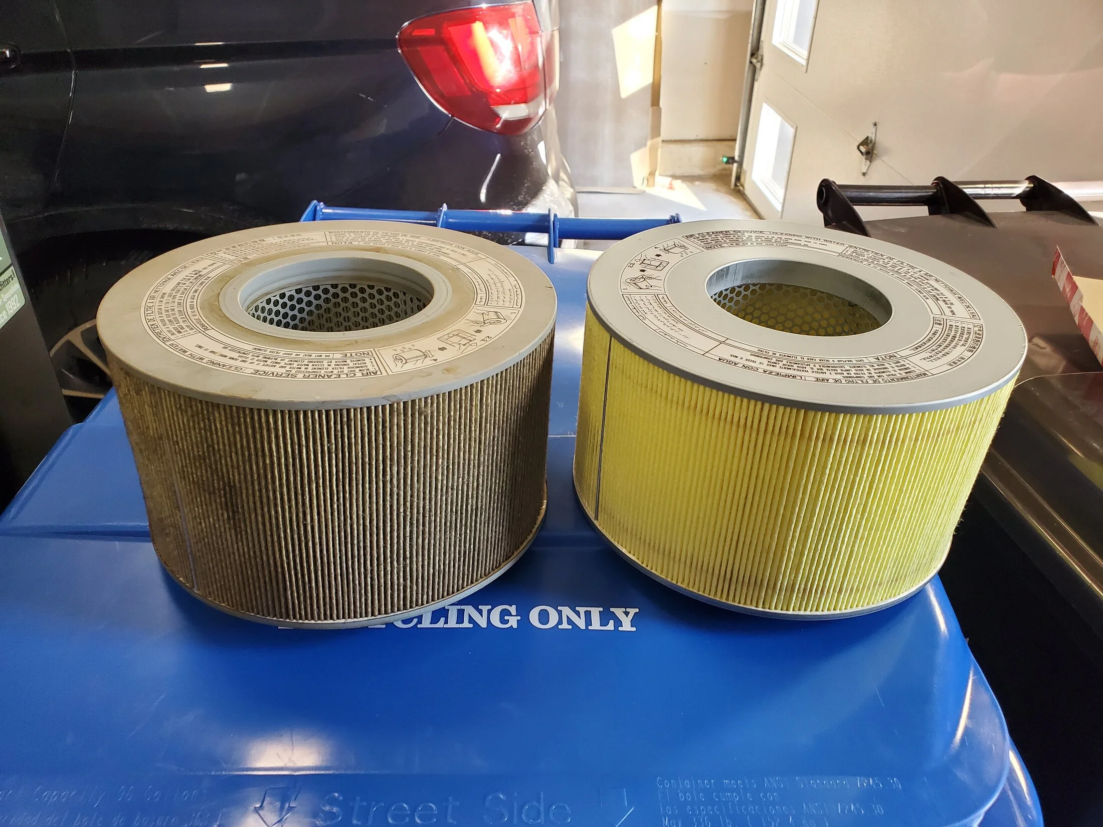

The main part I was waiting for was power steering pressure hose but it is too cold here in WI to do any serious wrenching. So I just replaced the cyclonic air filter. I will wash the old one and keep it as spare since these are re-usable!
Toyota 17801-17020
I bet @MongooseGA and myself can figure something out on that front - I know a lot of folks with Weathertech mats complain about the same thing. Can you post a picture of how the seat rails are blocking them?

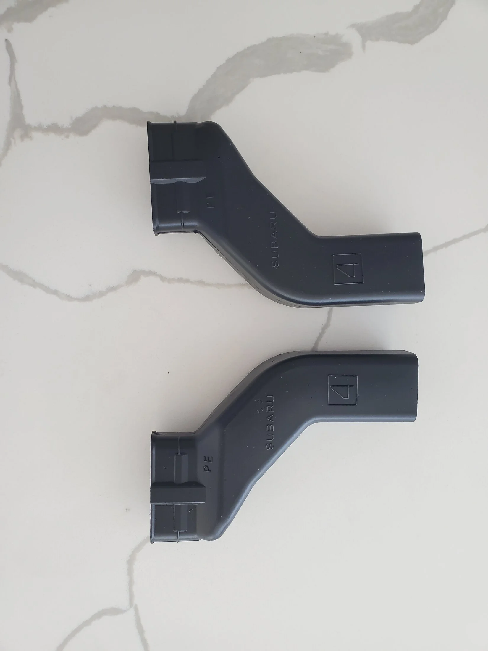

I have to get some better pics. In the meanwhile, I got these pieces from AliExpress for a few bucks and stuck them on the rear vents.
On yesterday's trip to Chicago (270 miles), my kids reported that the heat was actually coming to their feet now!
They don't fit perfectly but are a huge improvement on what I had before

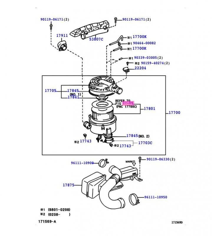

Found a cool pic for the cyclonic air cleaner so I am going to put it here>

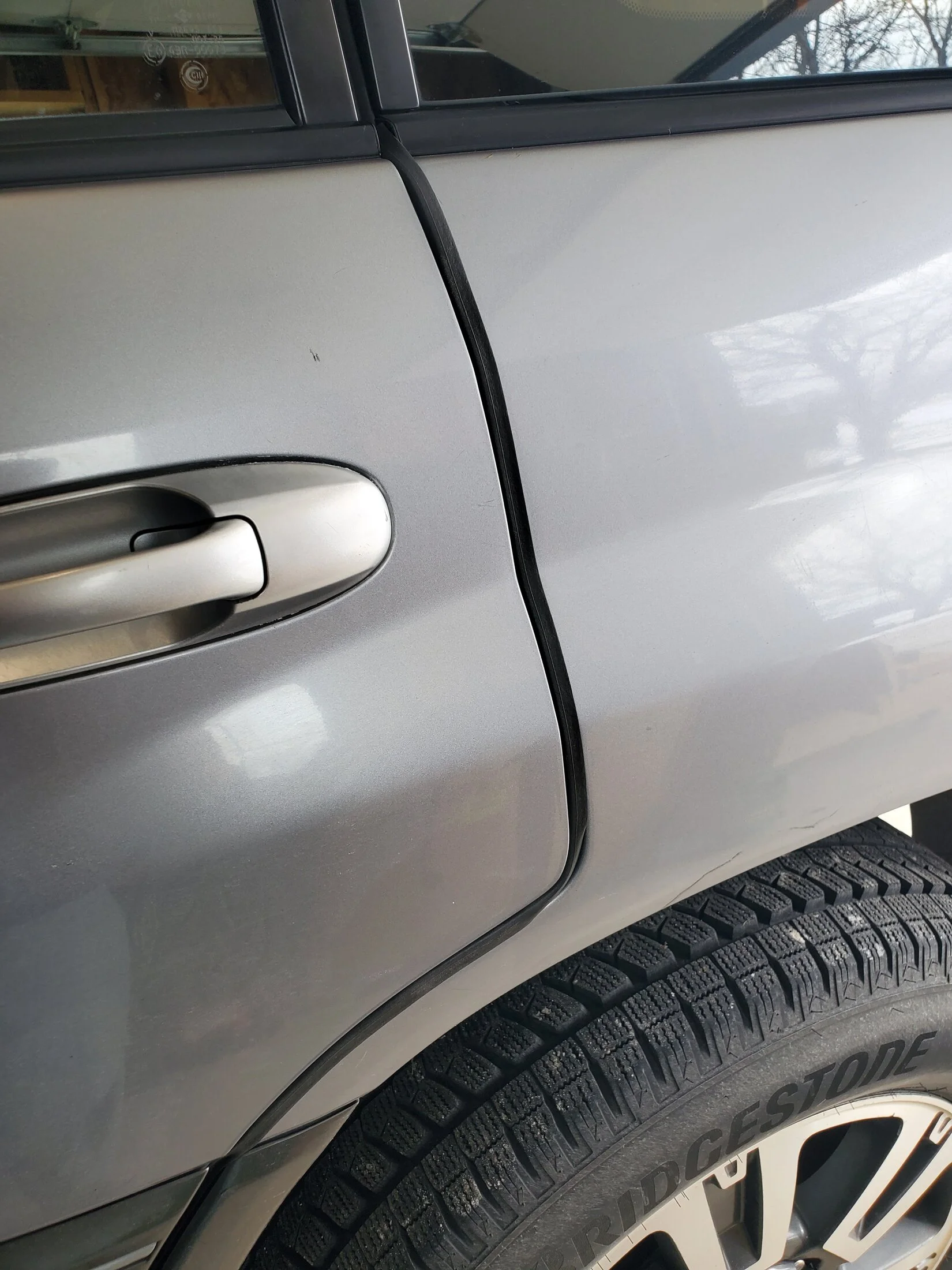

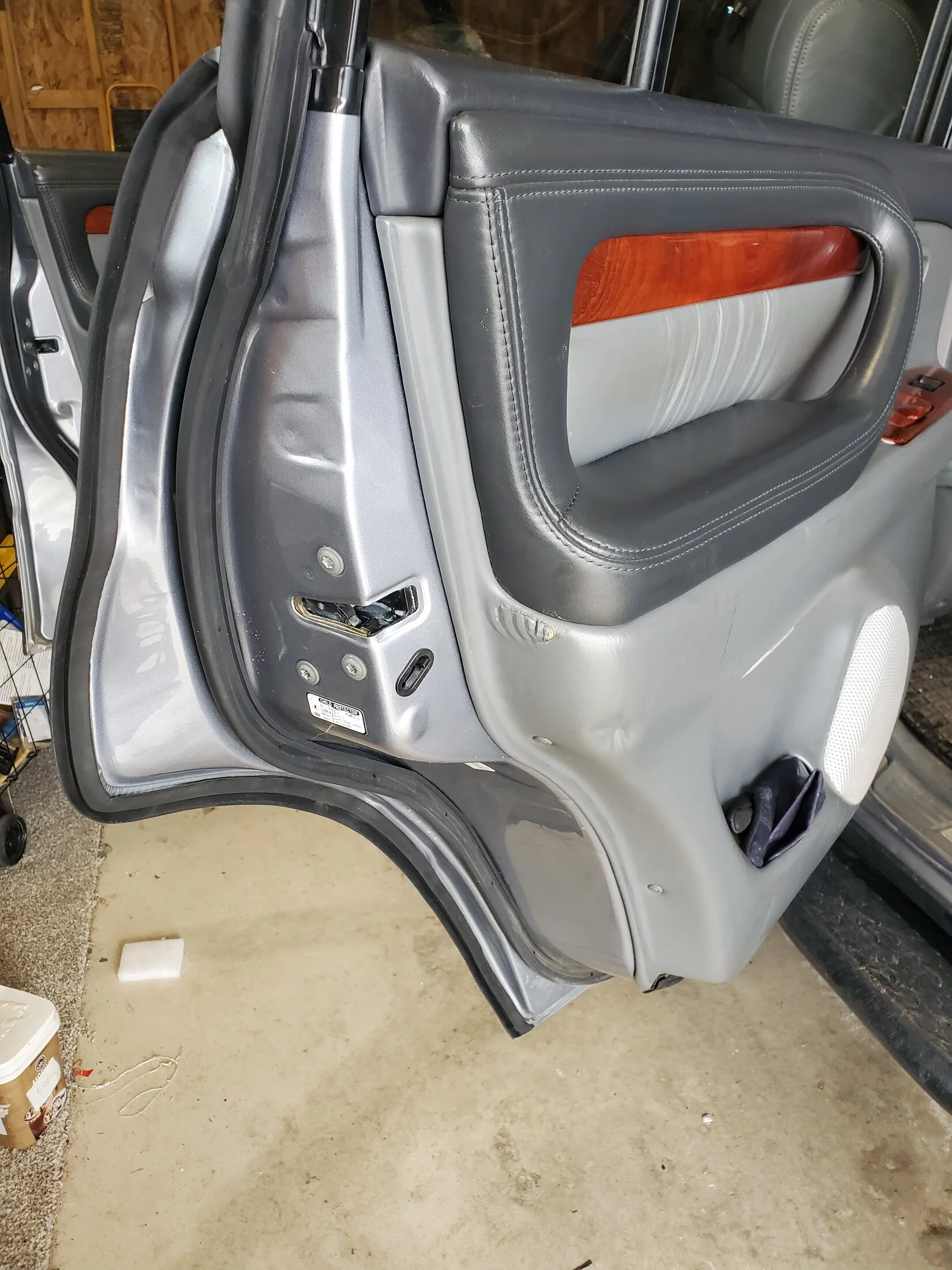

Added these little z-shaped strips to fill the gaps between front and rear doors, as well as the rear door rear edge. The idea/hope is that it will reduce the wind noise coming into the cabin
