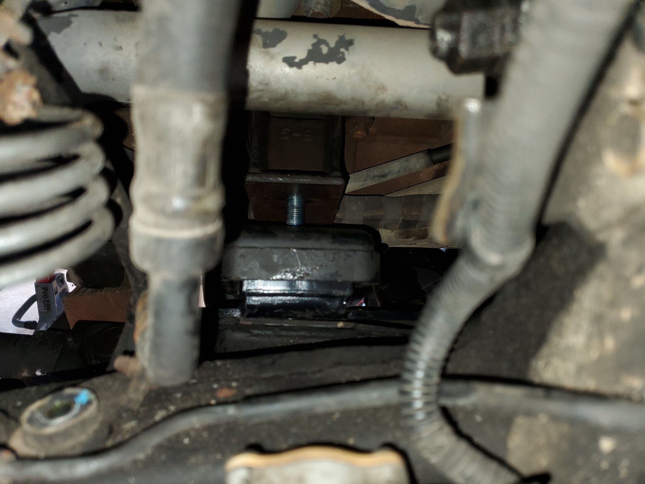

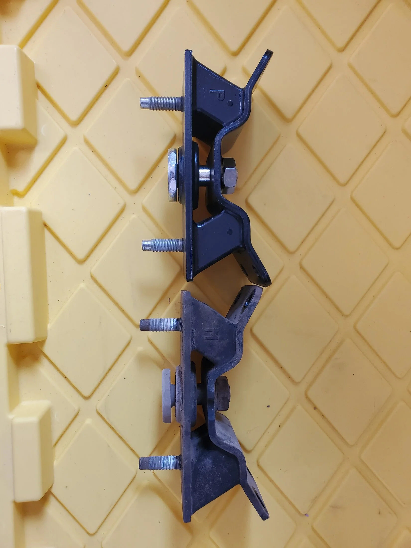

I started with replacing the transmission mount today. I had it at hand for may be 2 years but just never found motivation to replace it. Turns out it is a quick half banana 🍌 job!
Old one was a little compressed and rubber was hard but it wasn't broken. LOVE working on a rust free truck! Everything comes off intact and goes back together easier.

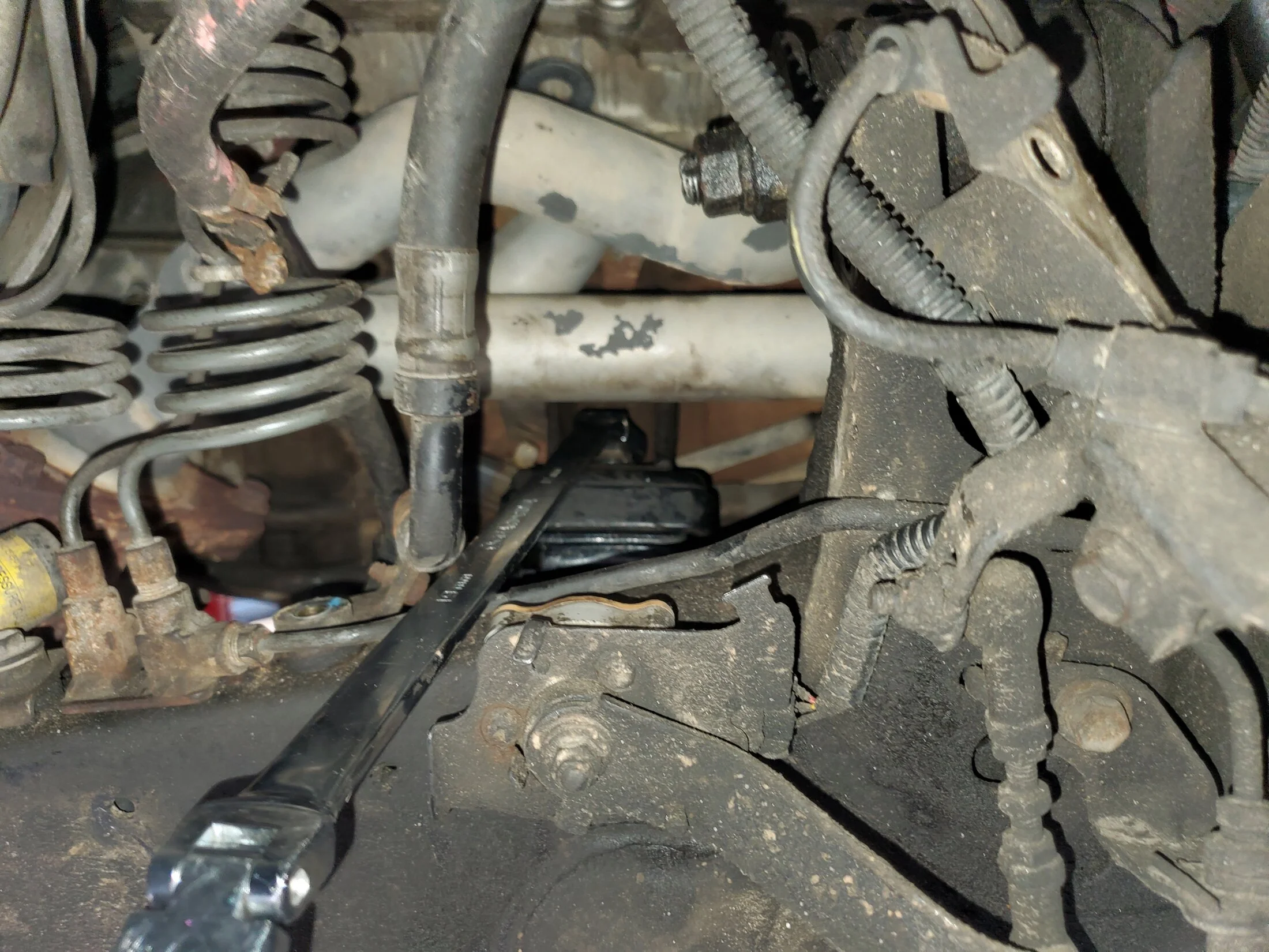

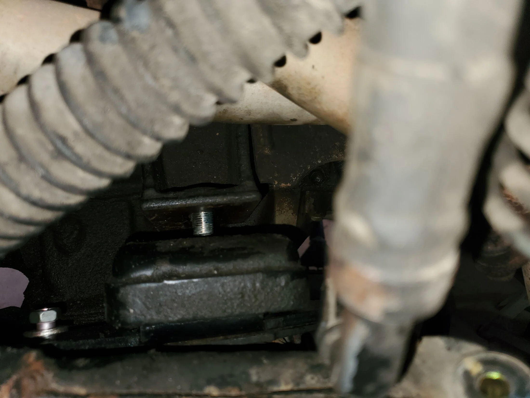

Got started with replacing the engine mounts. There are numerous warnings here on the forum abt how AHC lines restrict the access. We'll, they do. But the bigger issue is caused by the Doug Thorley headers.
The headers take up space than the stock ones and make access to the upper 17mm nut even harder..
I just finished installing the passenger side mount - not a fun job! I took lots of breaks and kept telling me that this is a big job it will take time and patience.
The old mount that came out is severely compressed but still intact.
I have loosened the driver side mount bolts and surprisingly found that side to have easier/better access!
A couple of pics

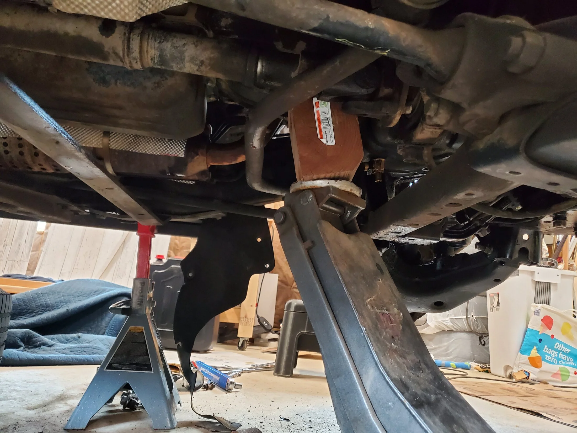

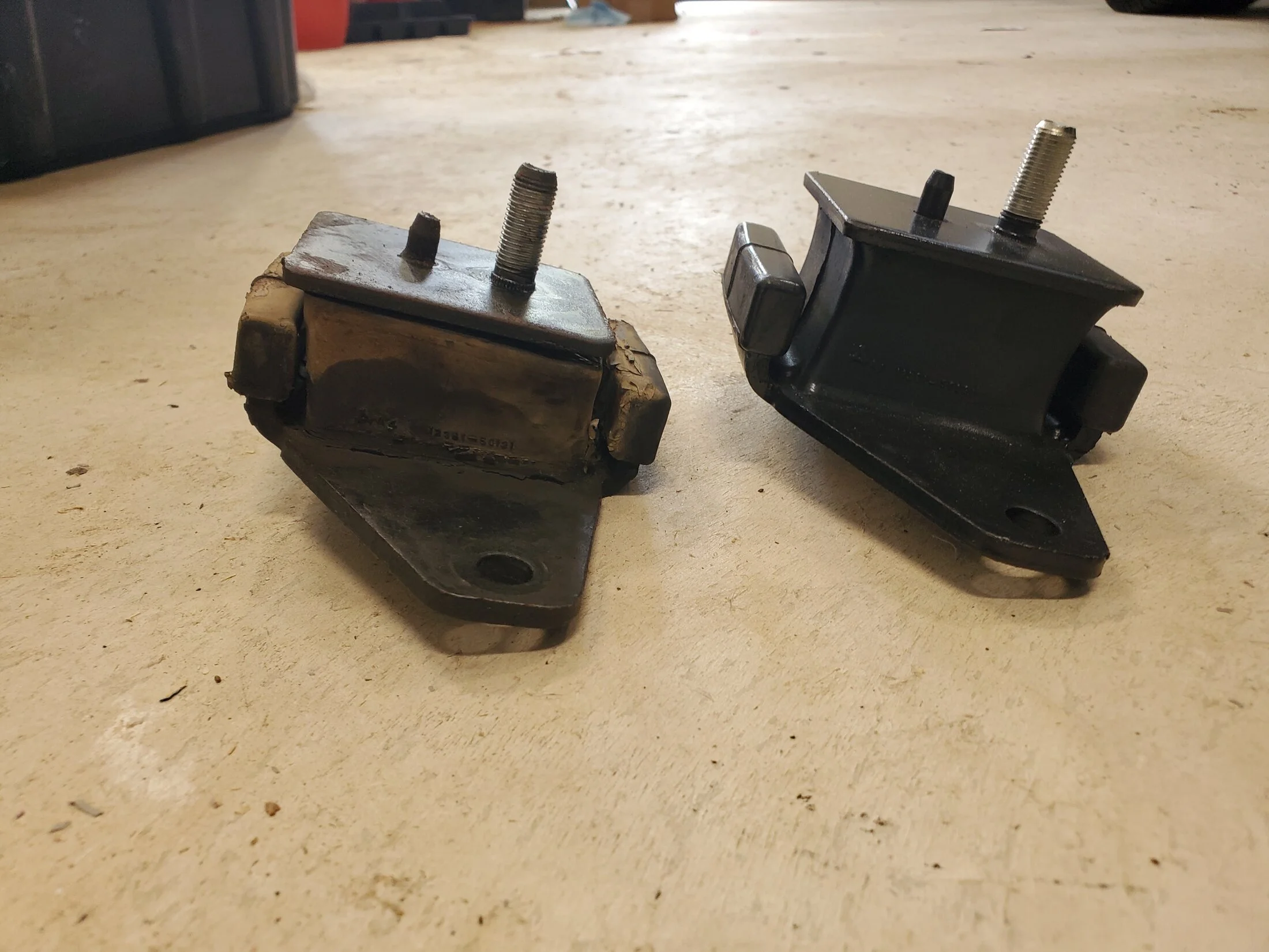

Got after the driver side today. I had loosened the bolts yesterday, before installing the passenger side mount.
The driver side mount was similarly compressed but also broken in two pieces. It was definitely time to replace it!
When I put the new mount in and let the engine down, there was still one inch gap left at the top of the mount 😳. WTAF?!? My engine was levitating 😀
At first I tried a pry bar to move engine back and forth to see if would come down. When that didn't work, I grabbed the top part of the engine and just shook it, it finally settled down.
I still need to connect the heater T hoses (disconnected them to avoid any stress when raising the engine), top up the coolant and go for a drive.

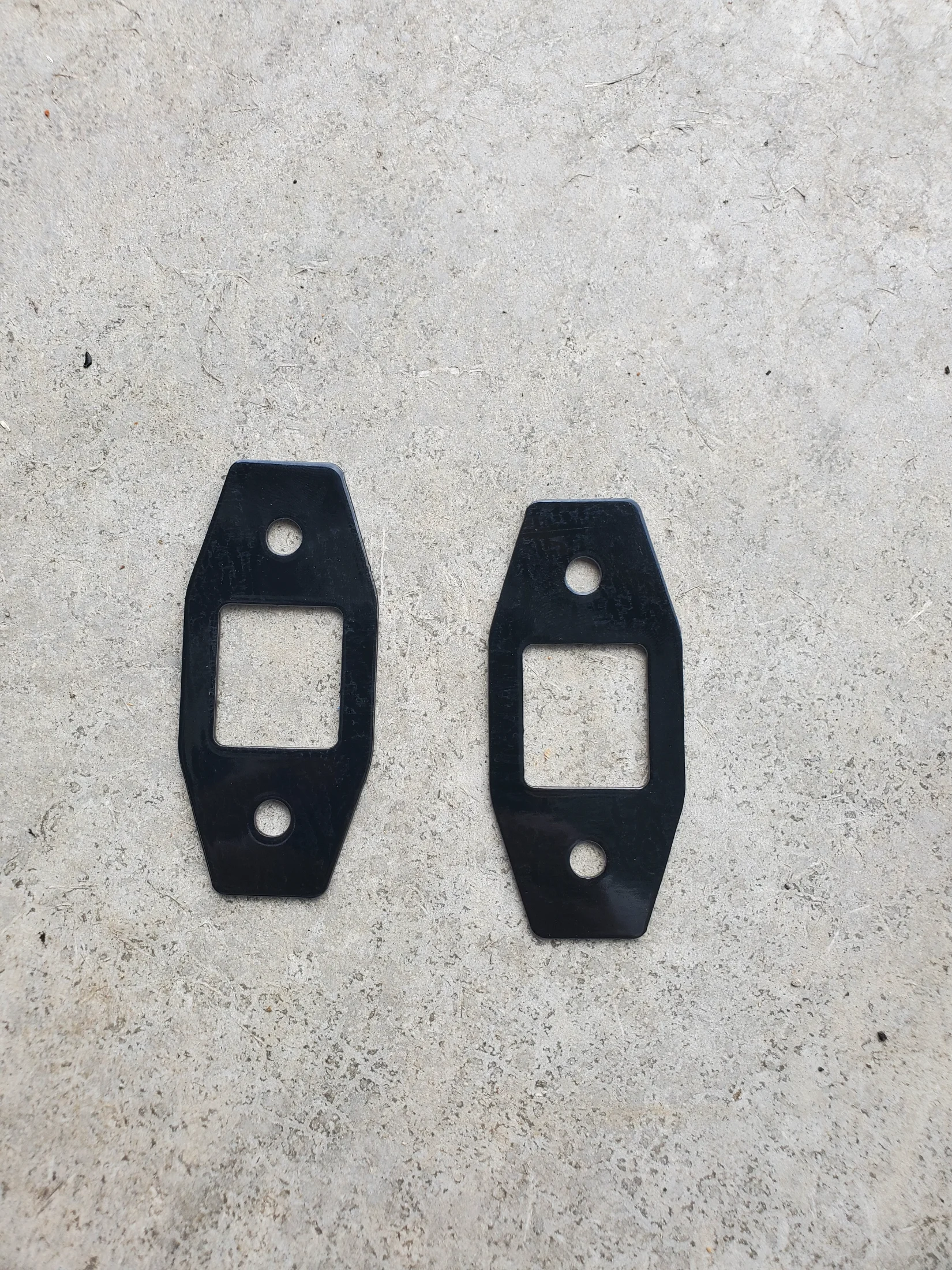

Replaced the door checks on rear doors and added @cruiserpatch sourced reinforcment plates.
A pretty quick job once you realize that you can just take the speaker off to reach the door check assembly and don't have to rip open the vapor barrier!
These are updated door checks with flatter ramps - will see if that makes any difference.
I've always wondered about these. I understand their purpose, I've seen the cases in which the metal tears but is it that common of a problem? I've personally never physically seen this happen on a 100 including my own and my rear doors see lots of use. What cases them to tear? Just being overly aggressive on the door? Were yours really stiff making the door hard to open? Idk just baffles me.
My rear ones were pretty stiff and the right rear was making pretty ugly screaching noises. I had lubricated it a couple of time without much improvement.
As for the mounting surface, it was solid on this truck but it did crack on my old 98. Not sure what causes them to crack or how common it is - Since I was replacing the door checks anyway, I figured it is cheap insurance against future failure.
