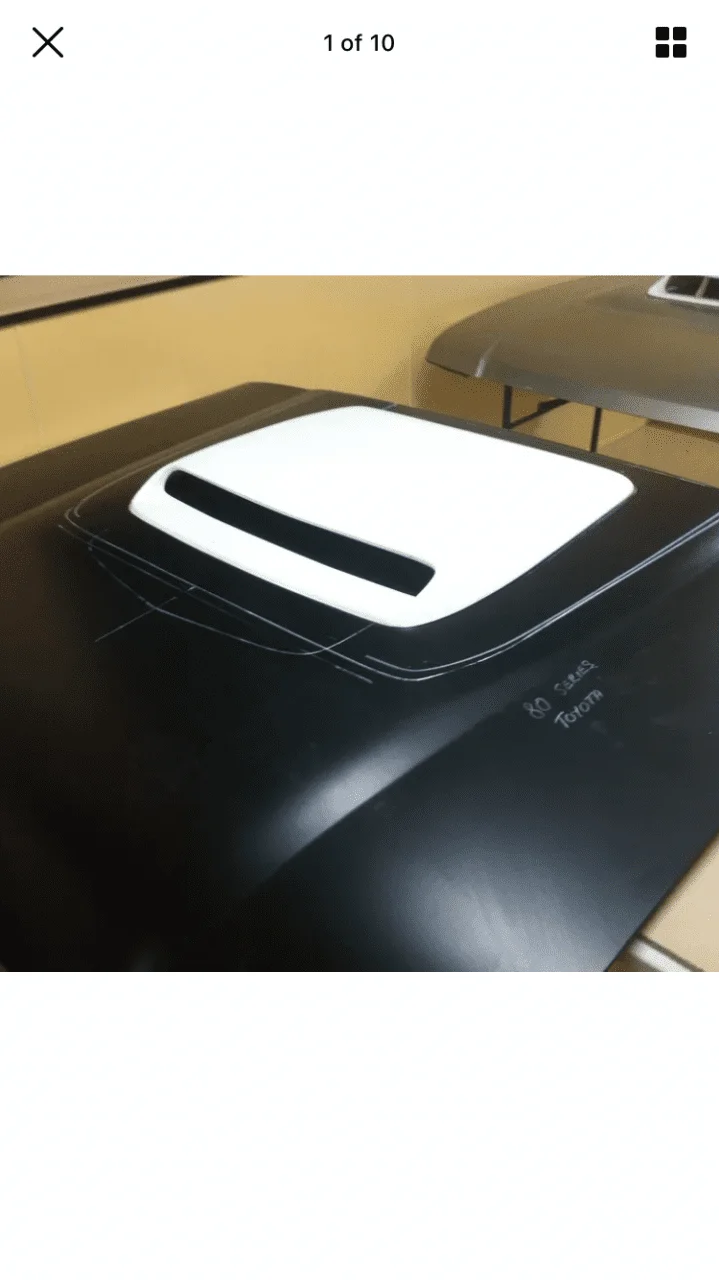

Is there any consensus on intercoolers? I'm running a Grunter Extreme @ 23Psi on my 1HD-T, don't do crazy mudding and more overland touring.
I was thinking the Safari is the best bet, any other suggestions? W2A seems like it could be risky, didn't the xxi system have some failures?
a2a would be fine for your application, got a mate with a FT and GX at 24 psi 21:1, 200rwhp, small top mount a2a with a scoop and he can tow his boat all day no drama

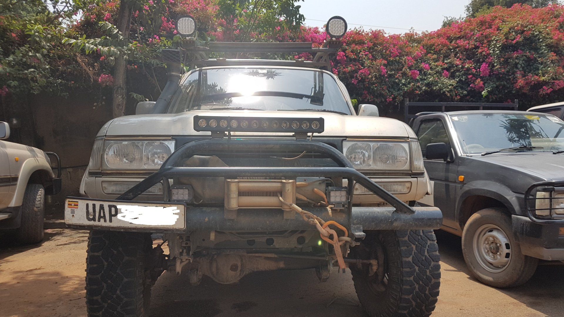

Hello guys,
was having a read through this trying to make up my mind in where I would like to go with the next step. I put a image of how the front end of my cruiser looks like and was wondering if I would actually benefit from a front mount seeing how cluttered it is.
Thoughts and opinions will be much appreciated!
Cheers

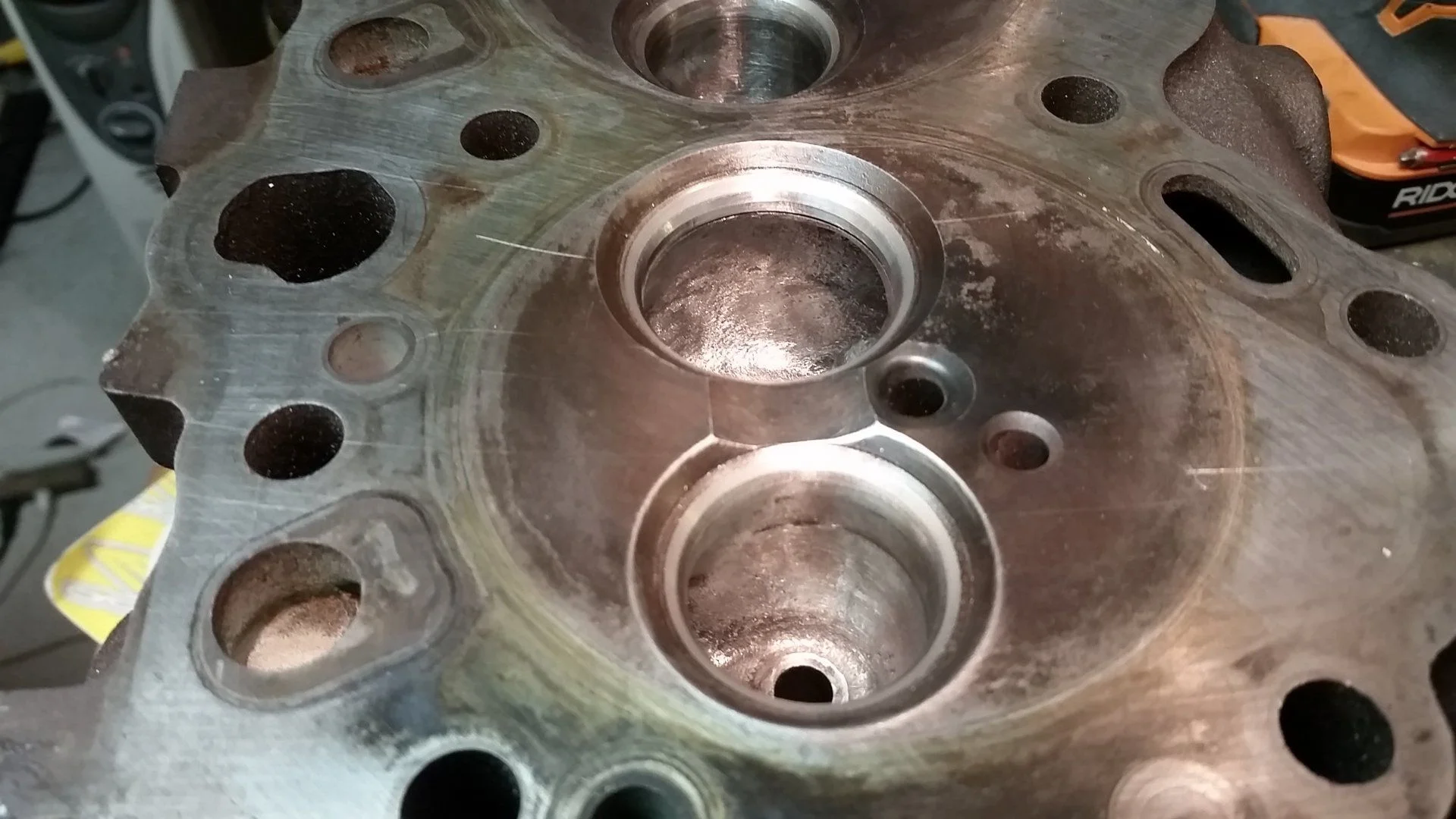

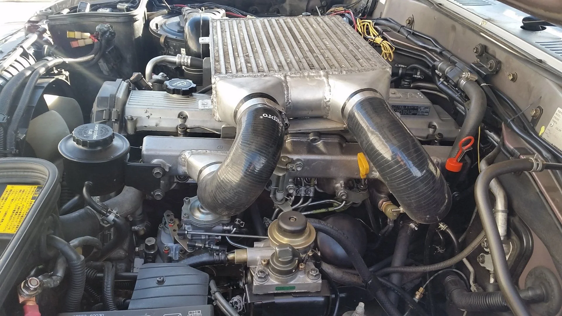

Just finished an intercooler install and turbo upgrade on my 92 HDJ81V. Still a few things to do but at least it is driving. After researching thru the considerable amount of info on MUD and working with what I had at my disposal. I built the intercooler from a Mazdaspeed 6 unit I had. It has been dicussed about cylinders 1 and 6 not getting as much air because of the centre feed intake manifold so I decided to add a second inlet.
This also allowed a more efficient intercooler setup. Many intercooler designs do utilize the entire core as effectively as they could. The single entry into the cooler splits into dual exits allowing even distribution across the intercooler. I fabricated the inlet and outlets from flat sheet and purchased components trying to transition as smoothly as possible from turbo to intake.
Combined with a MAMBA TD05-18G with 11 blade GTX compressor and a 9 blade exhaust turbine. Have about 200 km on motor and so far things feel pretty good. Pump and injectors rebuilt buy Oakanagan Diesel. Freshened up motor...rings, valve job, porting, multi angle valve job. 3" exhaust. Airbox mods coming soon.
Here are a few pics
Well that's a new approach, nice work!
That's a nice set up :) Do you have a splitter in your scoop to help air get to the front half of the intercooler as well? I don't know how the aerodynamics actually play out, but I know there are products for Subarus to help air pass over the front half of the intercooler. Necessary or helpful? I'm not sure...
