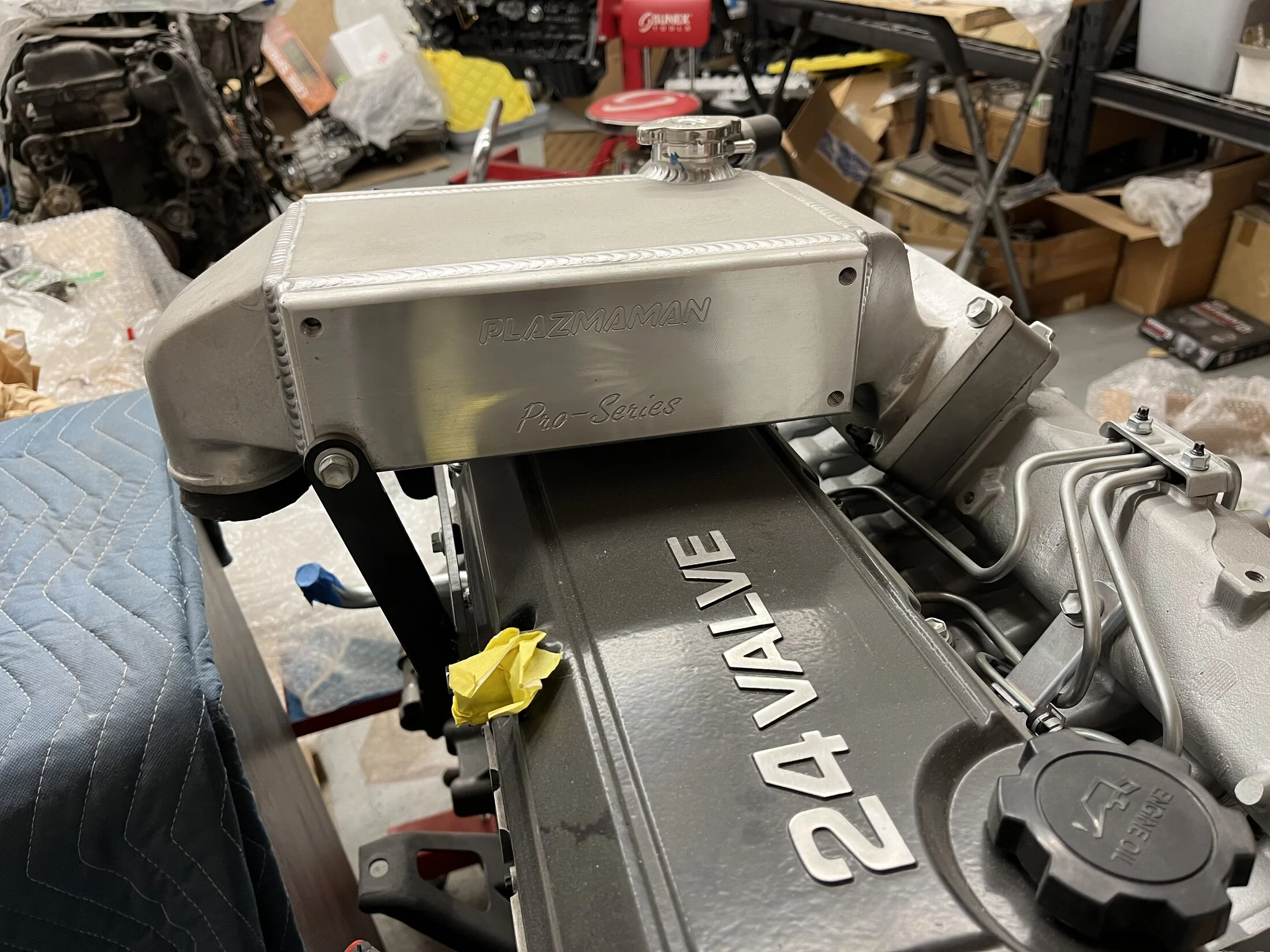

Anyone have experience with the Plazmaman W2A kit on an 1hd-ft? Information on them seem limited; or I'm not looking in the right places...
Greg
I have one on order for 1hd-t should be here in 2 weeks. just the intercooler not the kit, I'm going to run a universal heat exchanger and a Mercedes/Bosch water pump. I bought a front mount and then changed my mind...
Greg
We have one on an FT but haven’t run it yet.
Cheers
What made you change your mind?
Didn't want to add a bunch of big pipes running all over the place and adding a bunch of volume between the turbo and intake (i know the lag is minimal). Where the turbo is on the 1hdt in a landcruiser you cant clock the turbo downward because the motor mount is right in the way. You have to run a big u-turn and go back down.... 3/4" rubber hoses are alot easier to run then big 2.5 or 3" pipes. Also I'm guessing if your at the bottom of big hill at a standstill intake temps might be a little lower with the air to water system if the water temp can stay low. can't be sure about that though, Are there downsides? yes more complicated, more things that can leak, more fluids, more wiring.

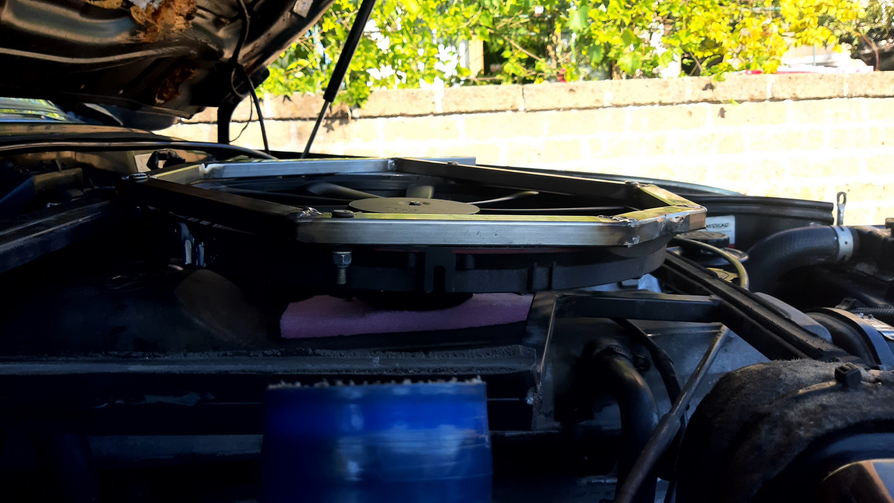

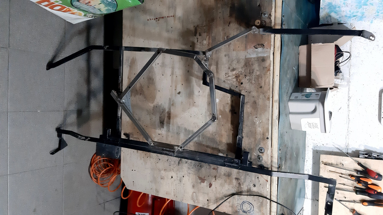

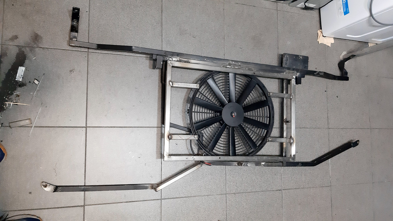

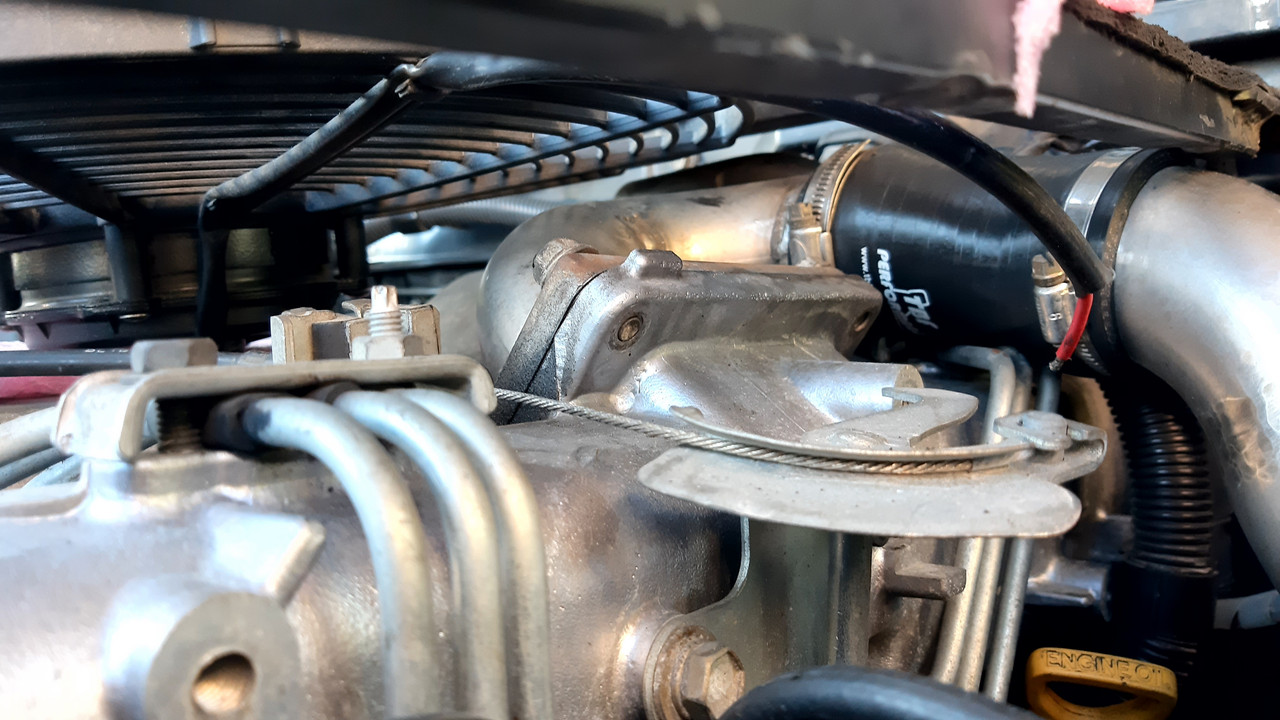

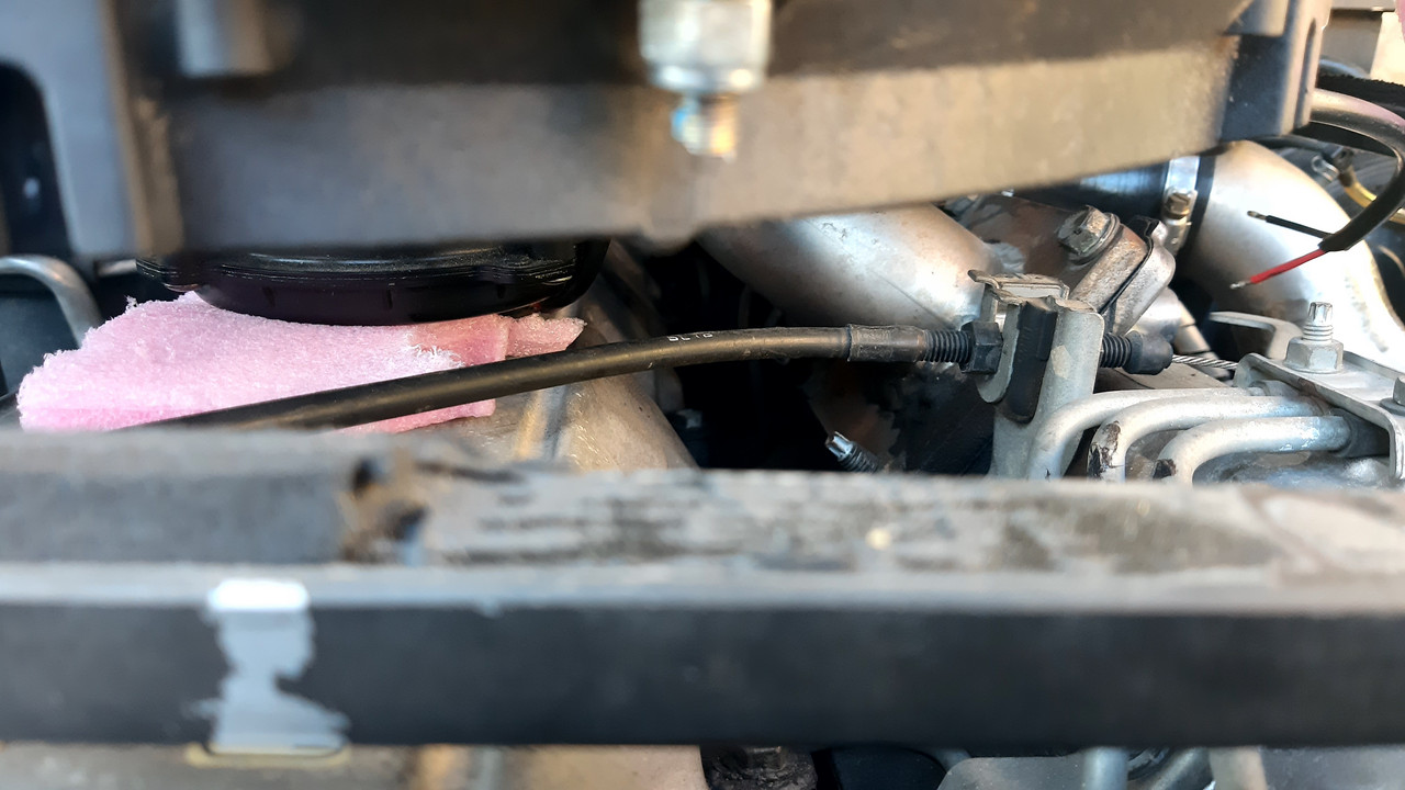

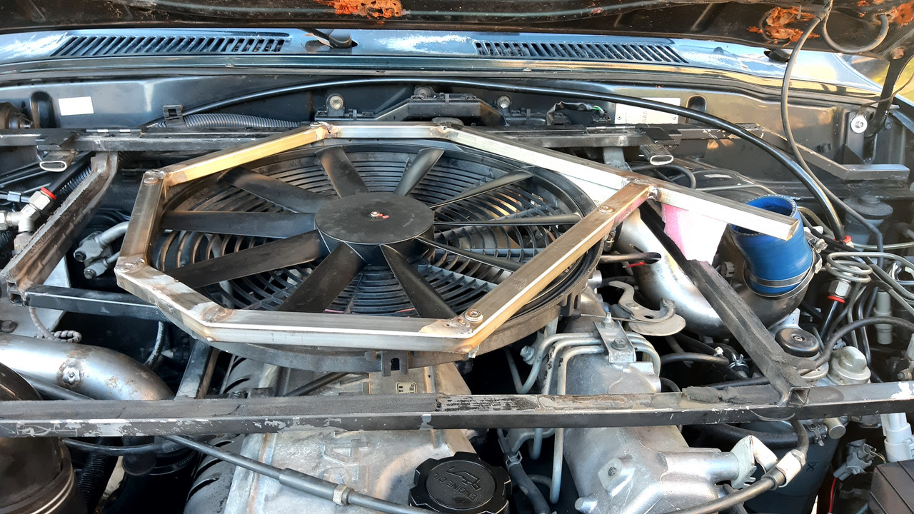

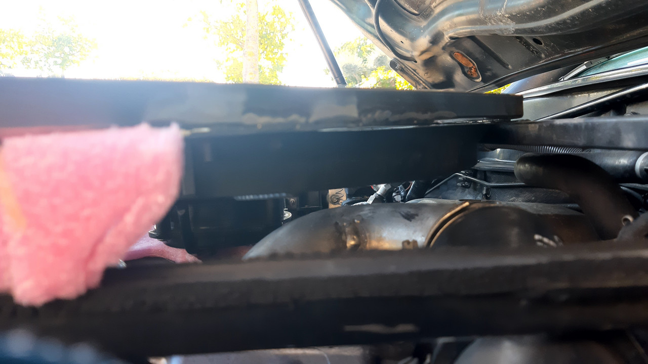

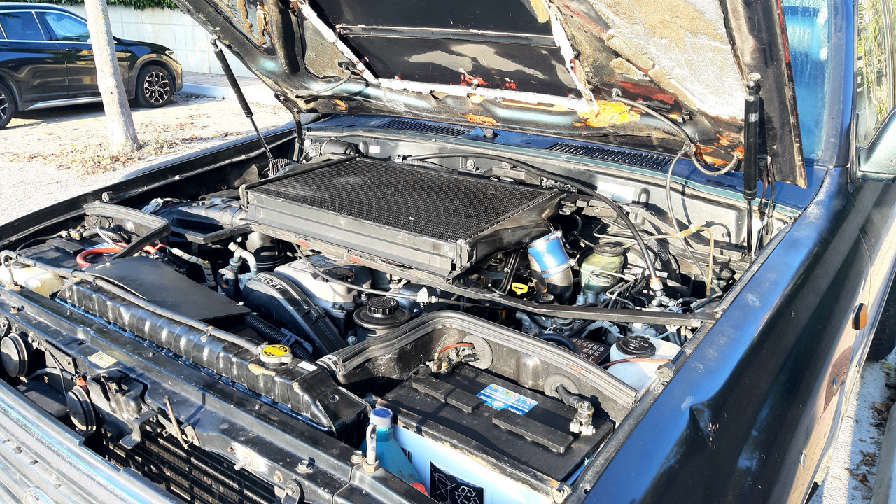

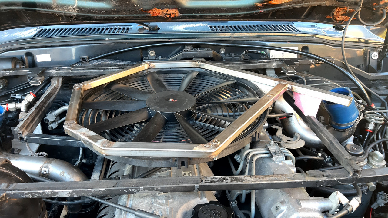

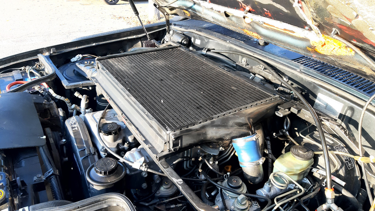

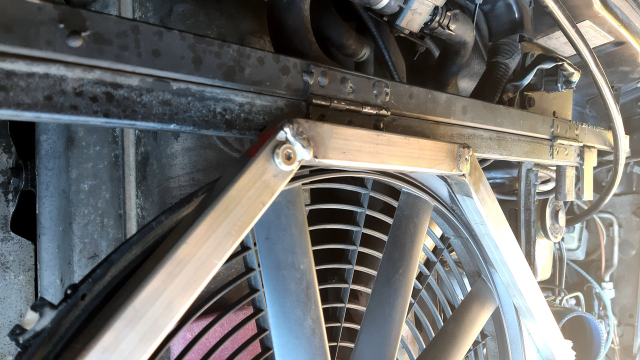

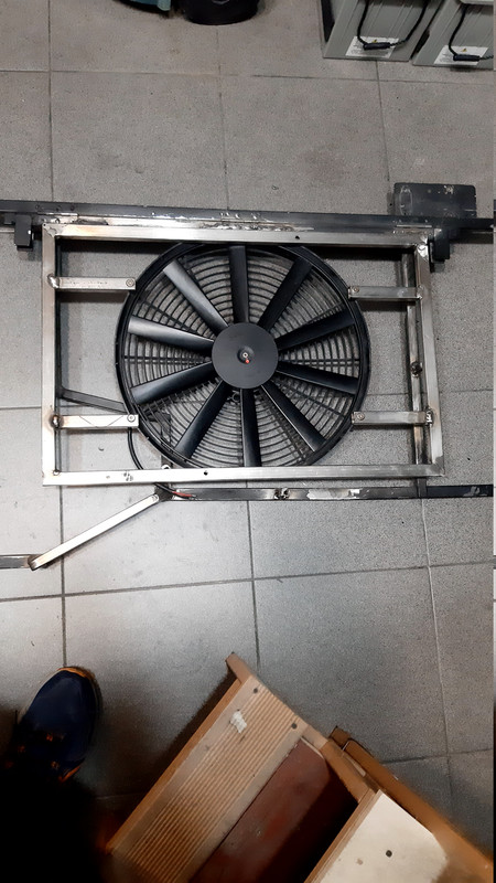

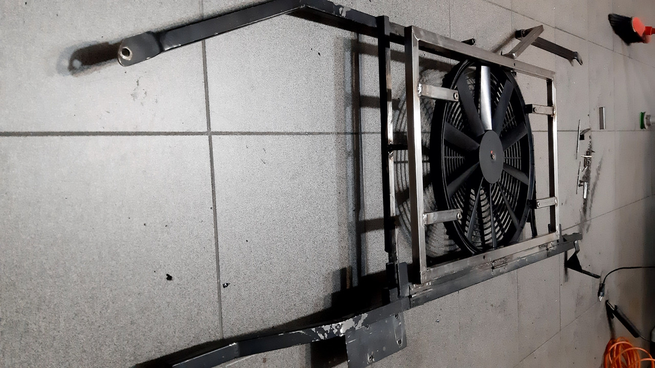

hallo to all of you from italy. Over 20 years ago, I posted on this forum and other in spain, france etc. my installation about intercooler with top mount on 1hdft. This post, i think, has been deleted or was missed, it is not present more on this forum. over 20 years after i'm doing last step of this upgrade (after having upgraded ct26) by adding a 40cm SPAL vent on lover side of intercooler. @ the moment, i'm working for last step and trying to traslate all my report from italian to english language. Just for fun, you can see some pics about my job. Many othr pics will be posted soon.
