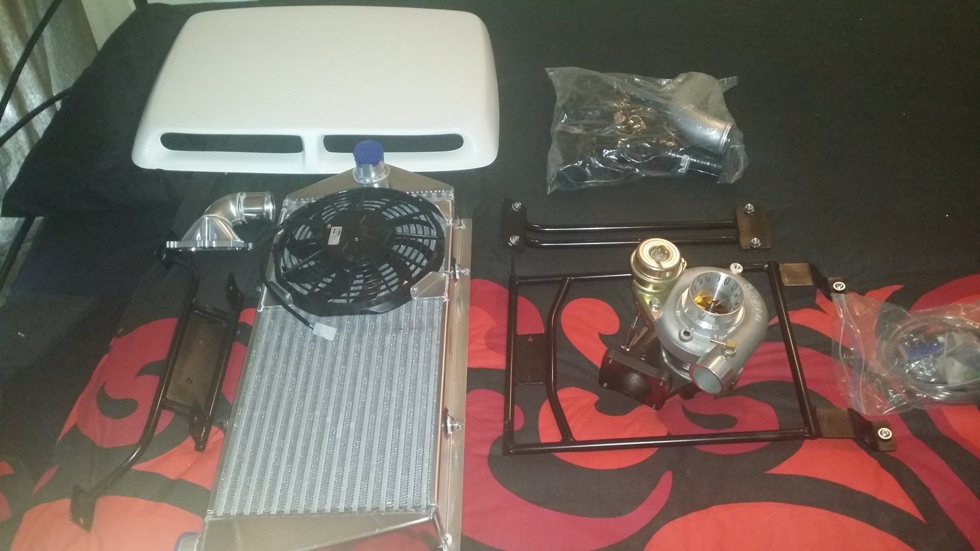

Thought it best i put a picture up of my intercooler kit in here, it's made by "Jonny Tig". A lot of people may not of heard of Jon but his skills an knowledge with intercooling and tig welding are some the best to be found. I have no affiliation with his company but this is the second cooler i have had him build me now and i've been more than impressed with his work an product both times.
600x300x76 light weight Euro tube n fin core and 10" spal pull fan.
View attachment 1498390 View attachment 1498391 View attachment 1498392
Is that a bolt-on intercooler kit, or the parts to make your own setup?
