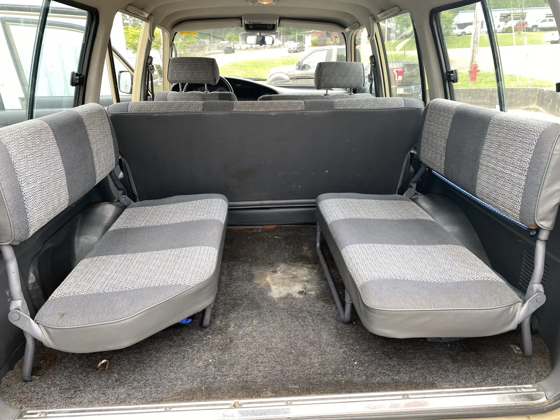

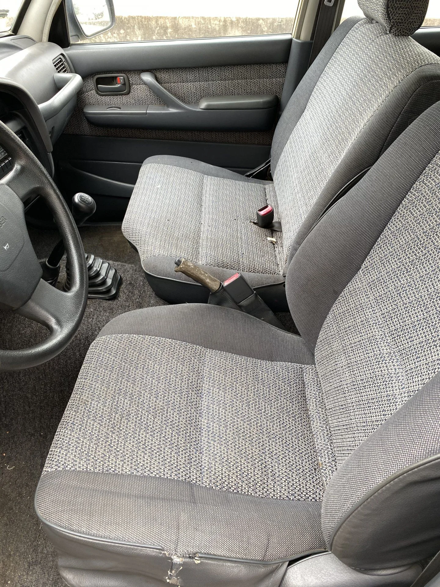

Now that is a really nice cruiser. Stupid simple and will go for a very long time. Super basic, no flares, no sunroof, no dealer added rack, 5 speed, carbureted, cloth interior!
Love it!!

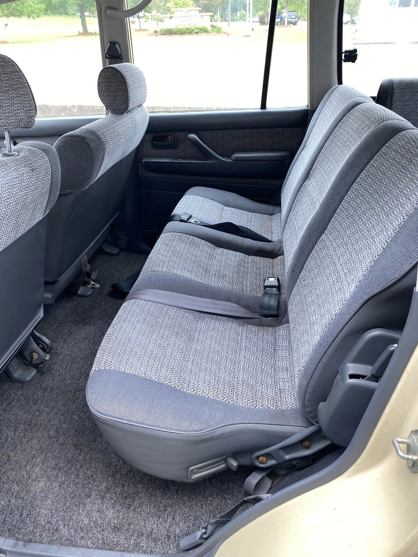

Love it!!

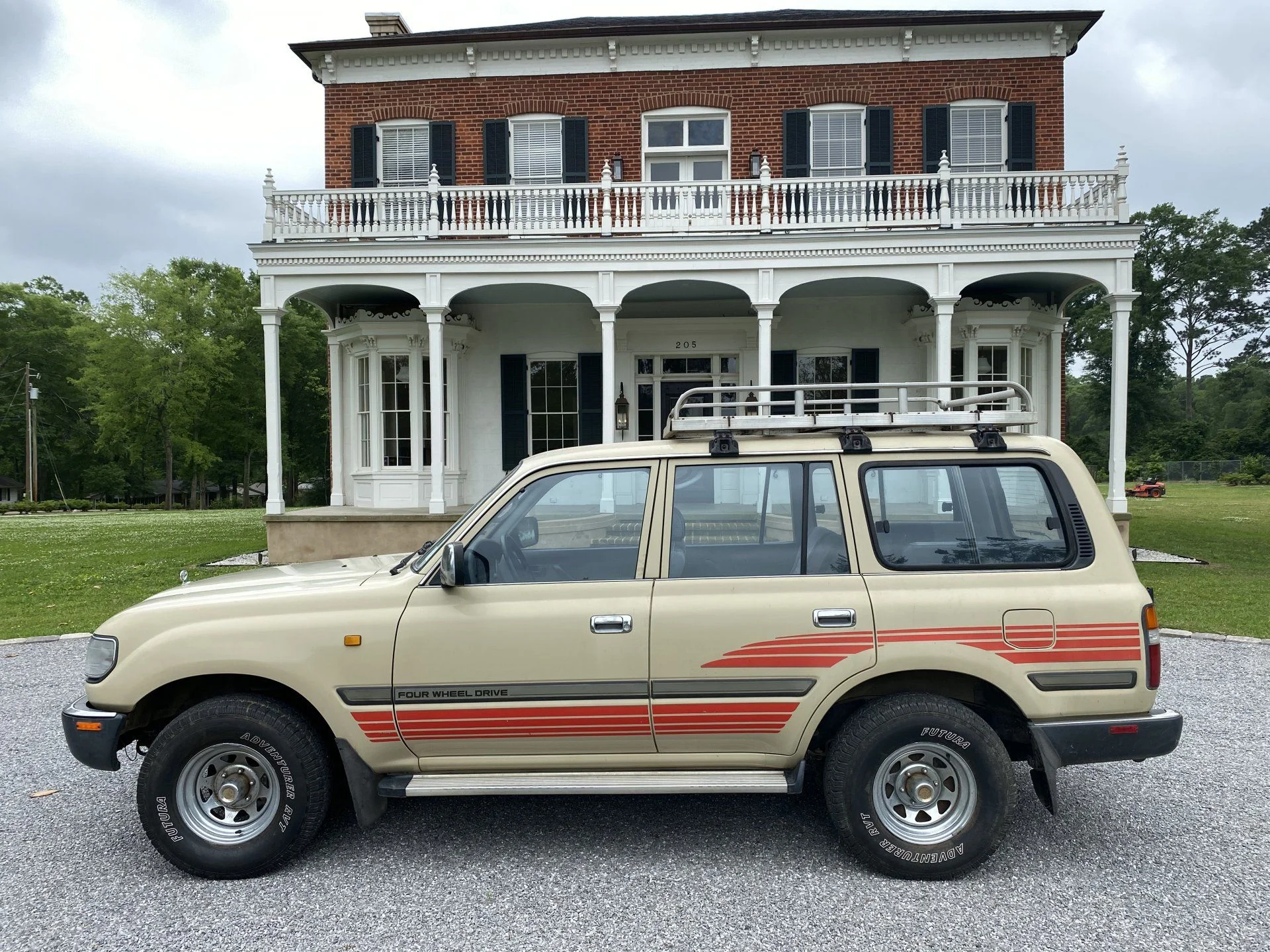

Thank you. And, like you, I knew this truck should be a Carbed 3F but if you see the photos, it’s clearly a 3FE.......
The plot thickens.

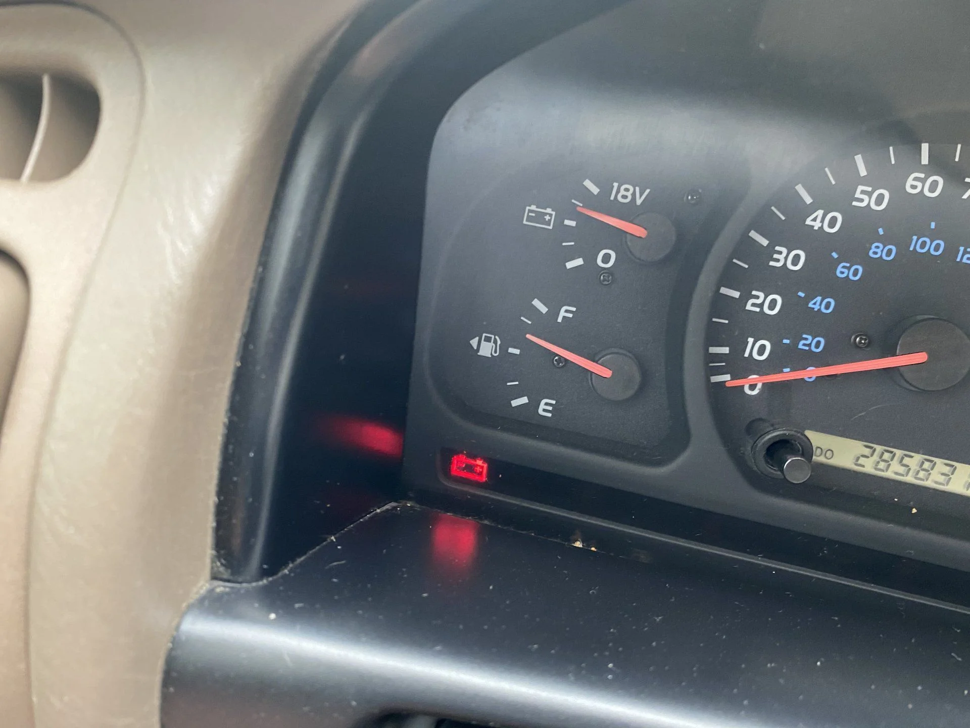

His truck tossed a charge light at the exit after a the 80 mile run so I made some calls to my 100 guru @USMC22 and he figures the alternator is going bad

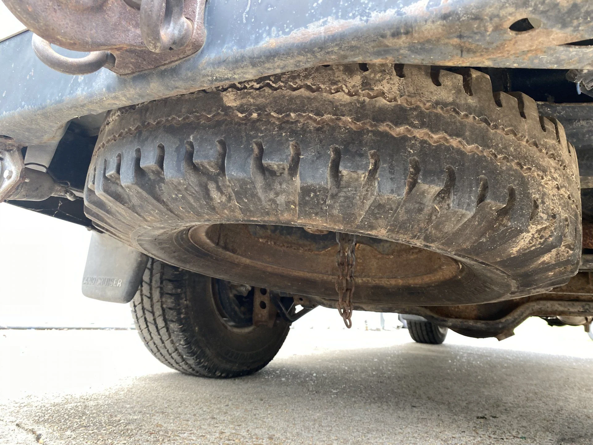

This thing was imported with this little matching trailer. I dug it out of the weeds. Kicked the tires and took off.
100 miles to home. I got this.

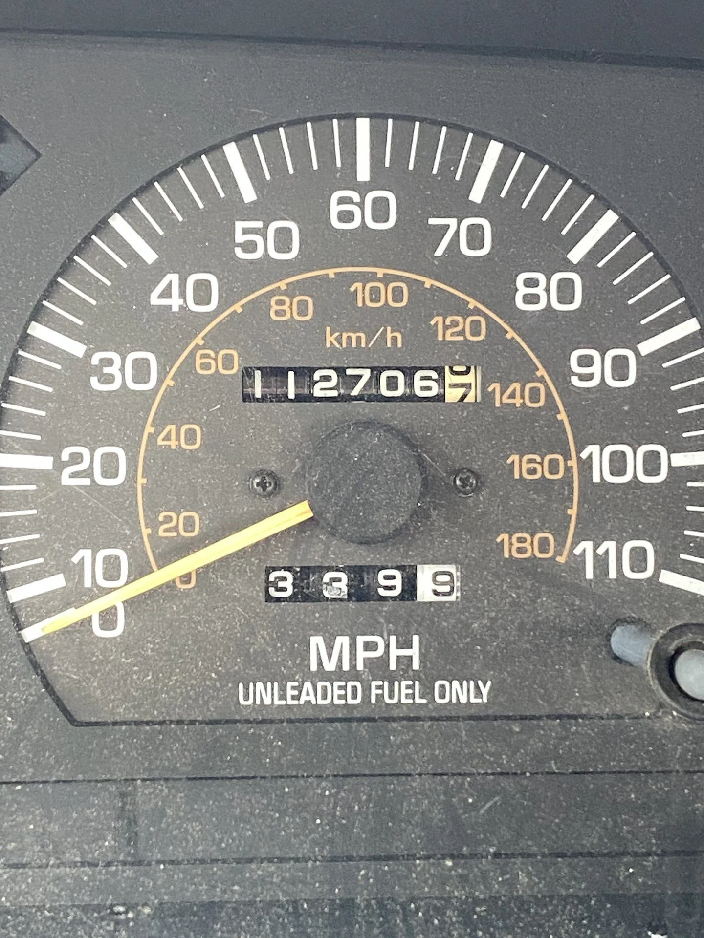

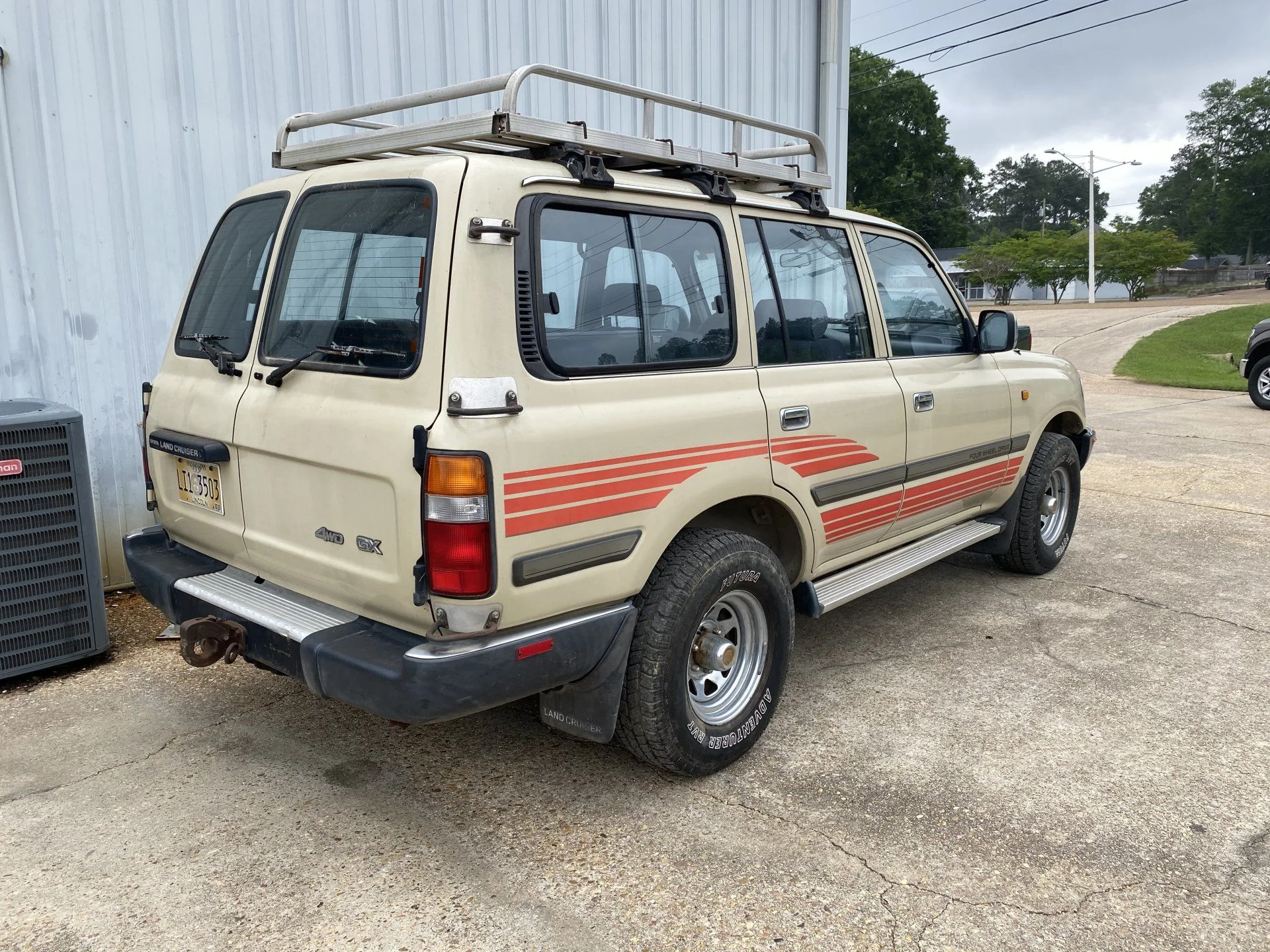

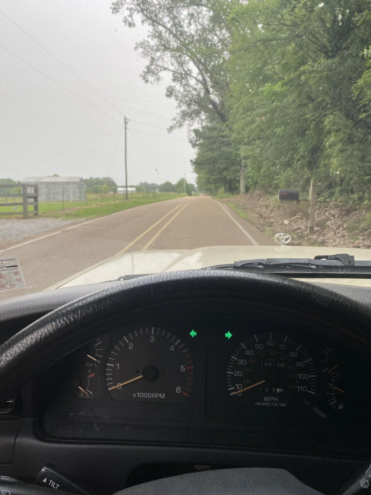

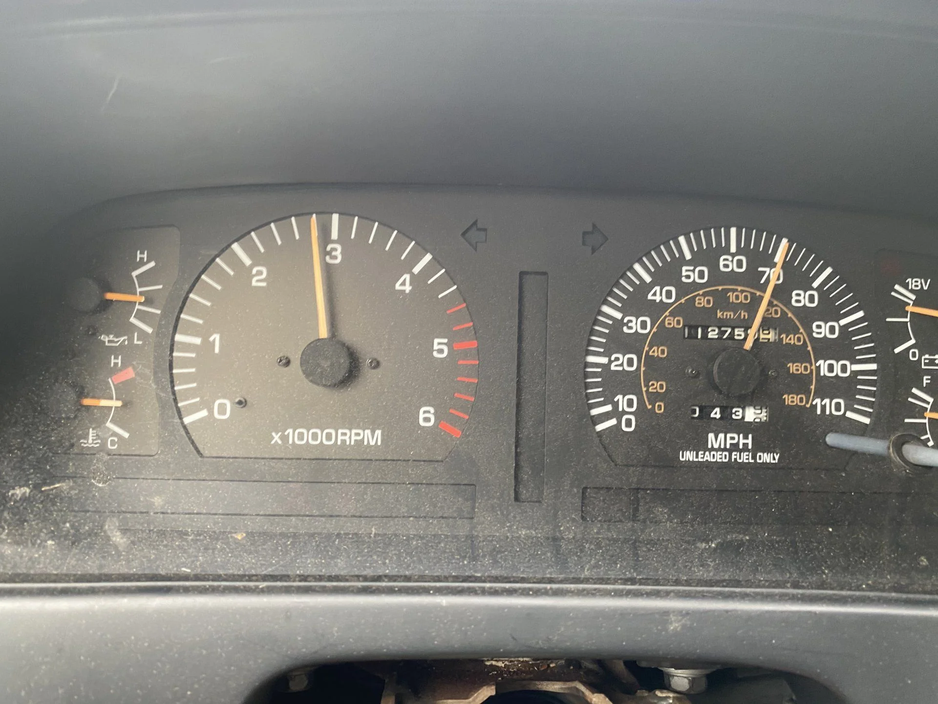

The speedo is a bit on the slow side with these awful tires and the KM to MPH conversion.
At about mile 70 it started hiccuping ..... I pegged it as a bad fuel filter or gas as this truck has not been driven hardly any in the last 20 years.

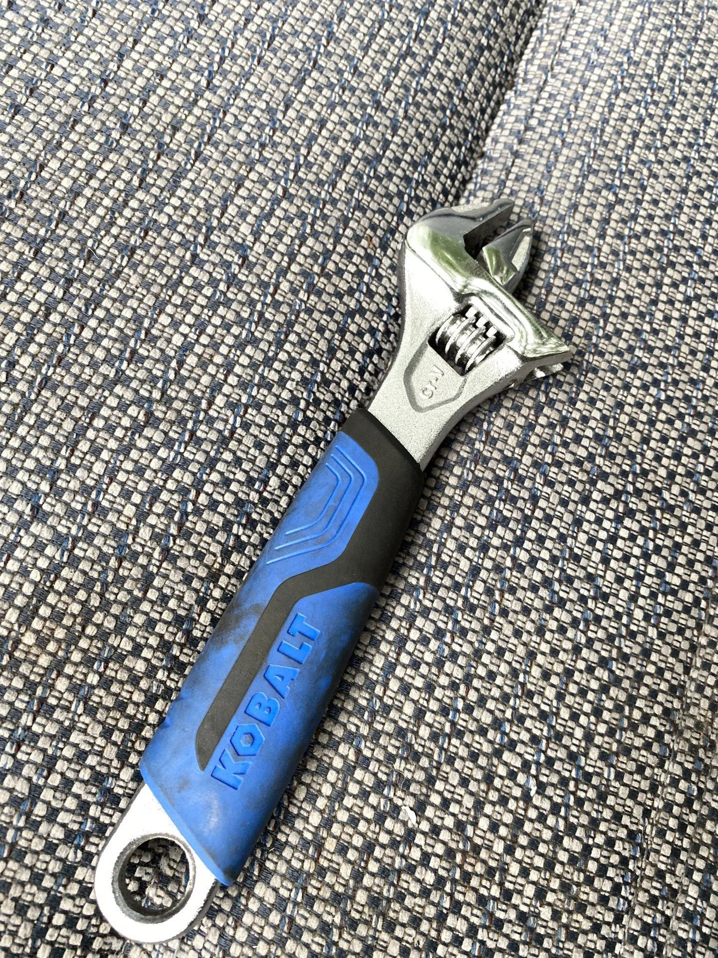

Dead. No fuel. Also, no tools.
I crawl under the truck and realize some genius had installed a frame mounted Walbro electric fuel pump right in front of the filter and the Positive wire Has come off but all my tools were headed north with my dip**** 16 year old.
I called him and got him headed back
This fine piece of equipment got me back on the road but man.

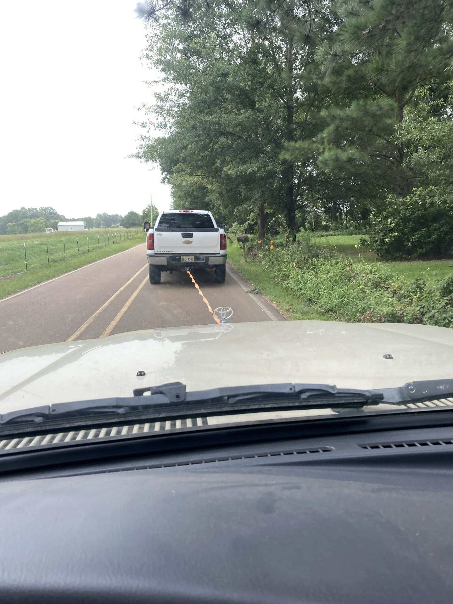

When I was 23 miles out we got into some traffic and bam. Dead again on the most crowded section of I-55 and once again, traffic carried my son a mile down before he could get to the shoulder.
I think the in-line is just getting too hot because I ended up crawling under there with a handful of ice and cooling it off and we were rolling again in 20 minutes.
I sent the knucklehead away when we got on my road and dammit if it did not die again 2
Miles out.
I ride the strap of shame home behind my Farm Service Agent.

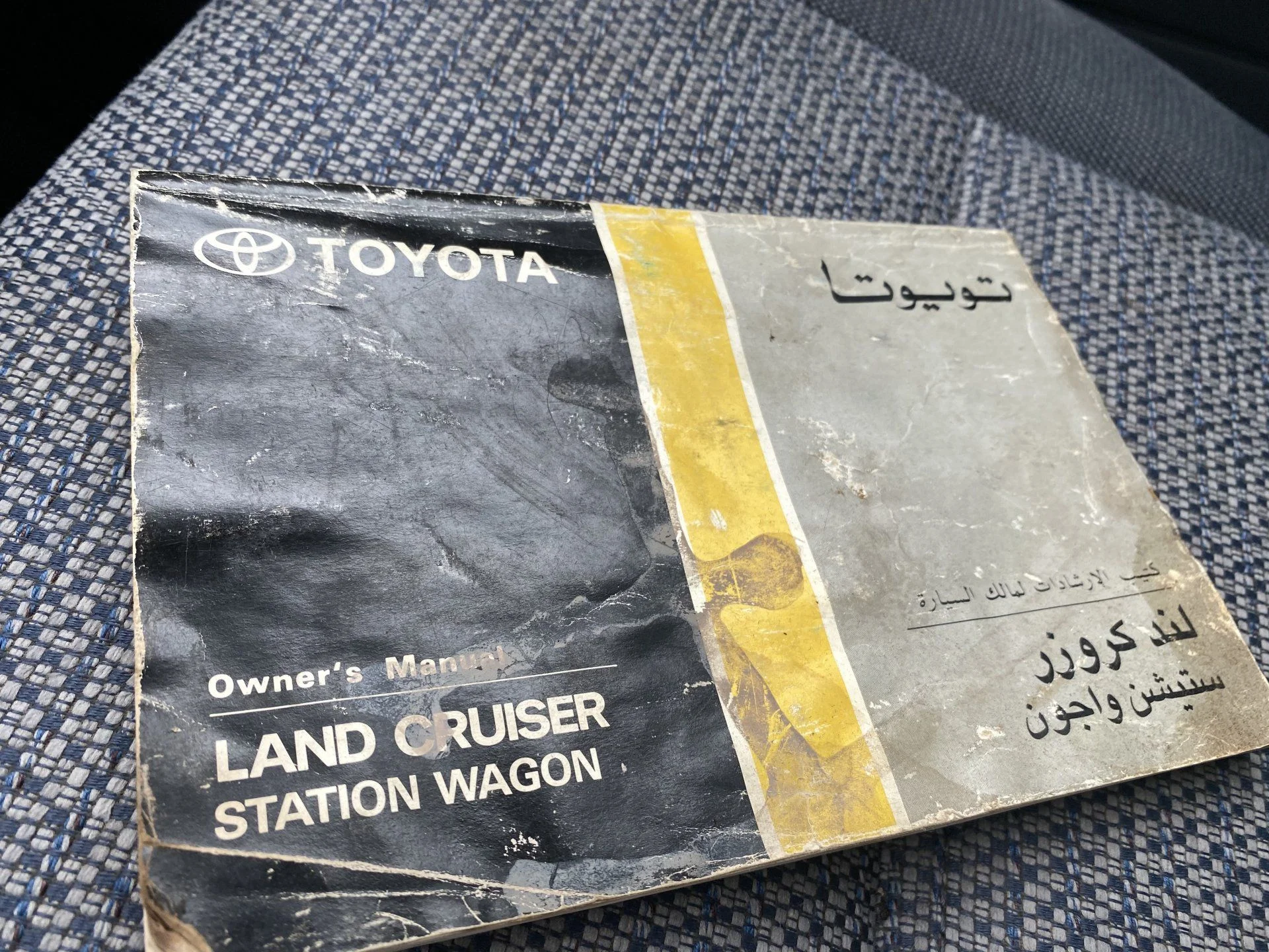

A mouse decided to camp out in the glove box on a treasure trove of OEM papers that will help me figure out how the hell the Oddball80 made it to Brookhaven Mississippi from the Middle East
Brown stain is mouse piss. Horrid.
Looks like it was purchased by my guy way back in 2007
These are the people I need to find. This is the importer and the owner before my guy
Seems that went down in 1996

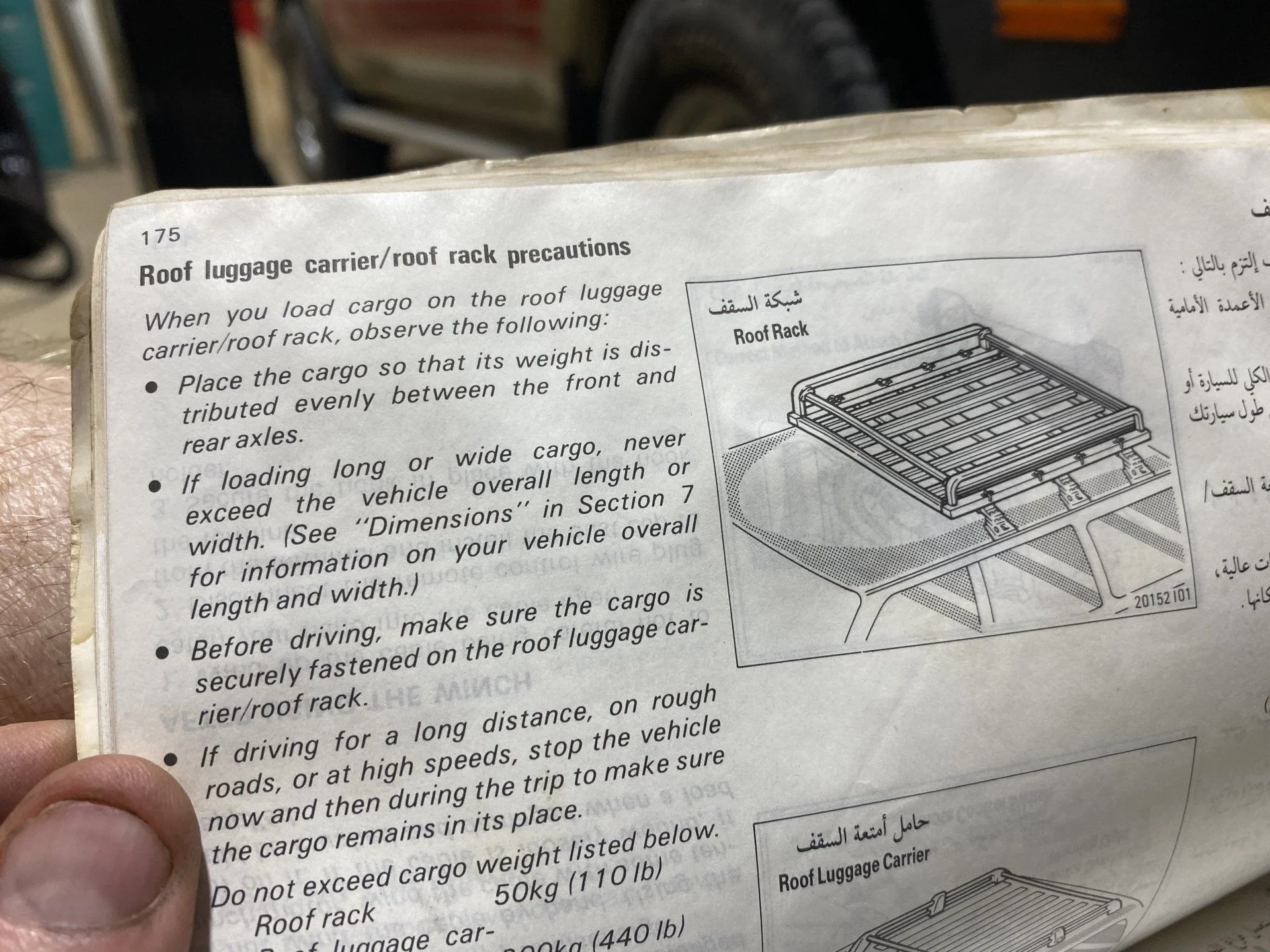

It has a service manual that shows the initial services in whatever Middle East county the US government used it in. Likely Saudi.
I cracked open a beer and the manual to see how the heck the 4wd works with 2wd 4High and 4 Low and no hubs (that I can see)

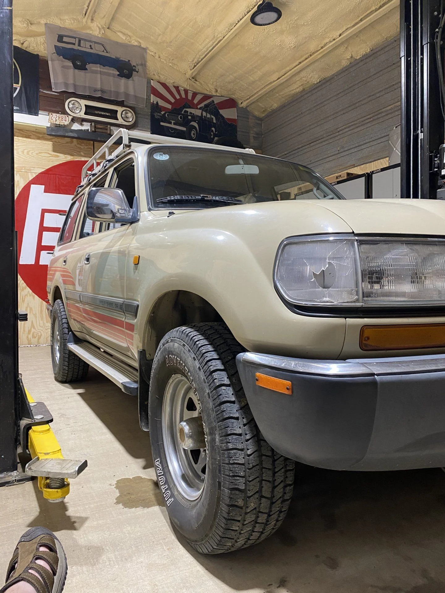

Along the way today I’ve been burning @Onur up with questions and he was really puzzled about this 3FE
“The rack on the dune runner 80 is an Aiba. Factory accessory supplier. installed at port before leaving Japan. The steps on the D pillars are factory installed.”

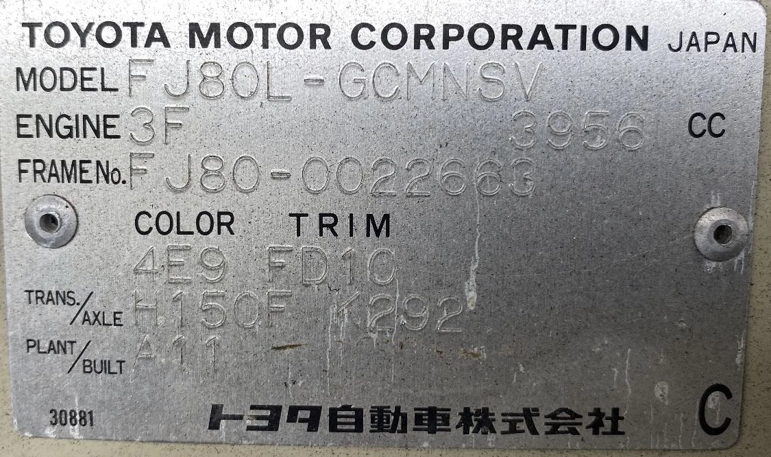

And then I found this sticker.
Holy hell, it looks like the importer converted this thing from a 3F to a 3FE .....
That explains the fuel pump setup......
I’d love to hear more about this if anyone knows. @SteveJackson ??
