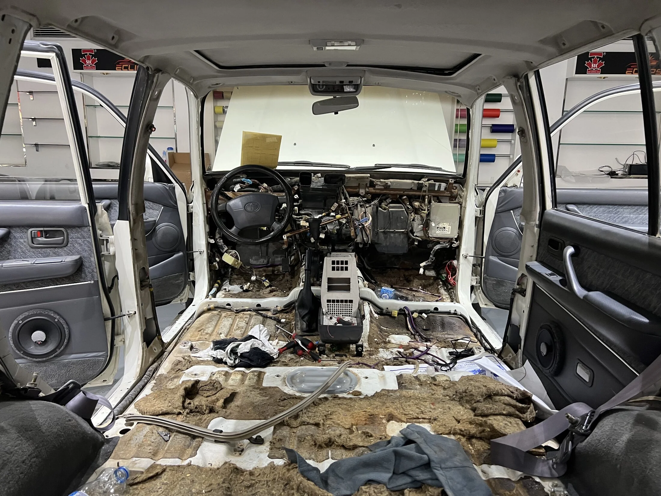

A couple months ago, I stripped the interior when I had the exterior painted. That alone was a solid 6–8 hour job by myself, and it set the stage for what I started today.

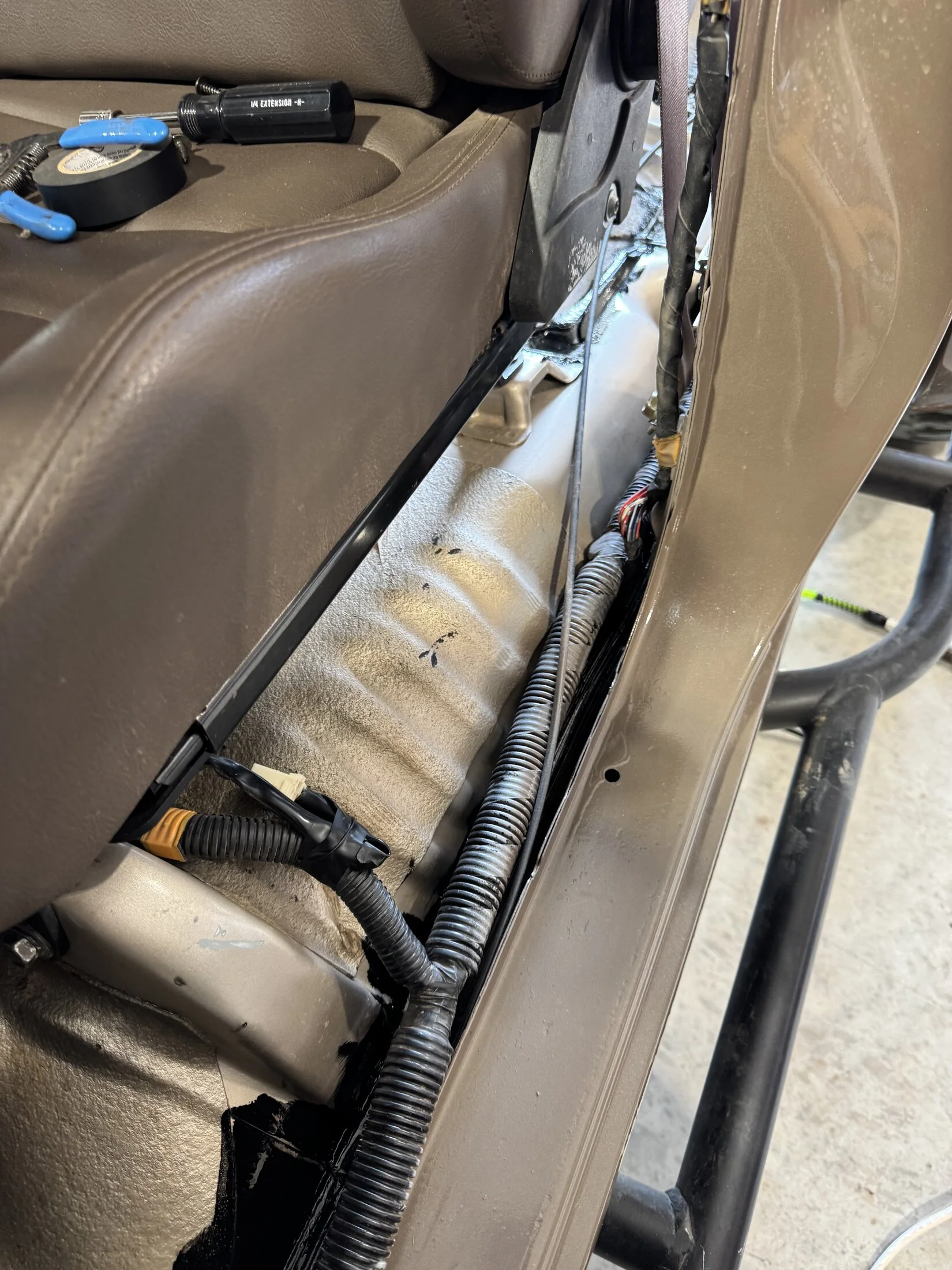

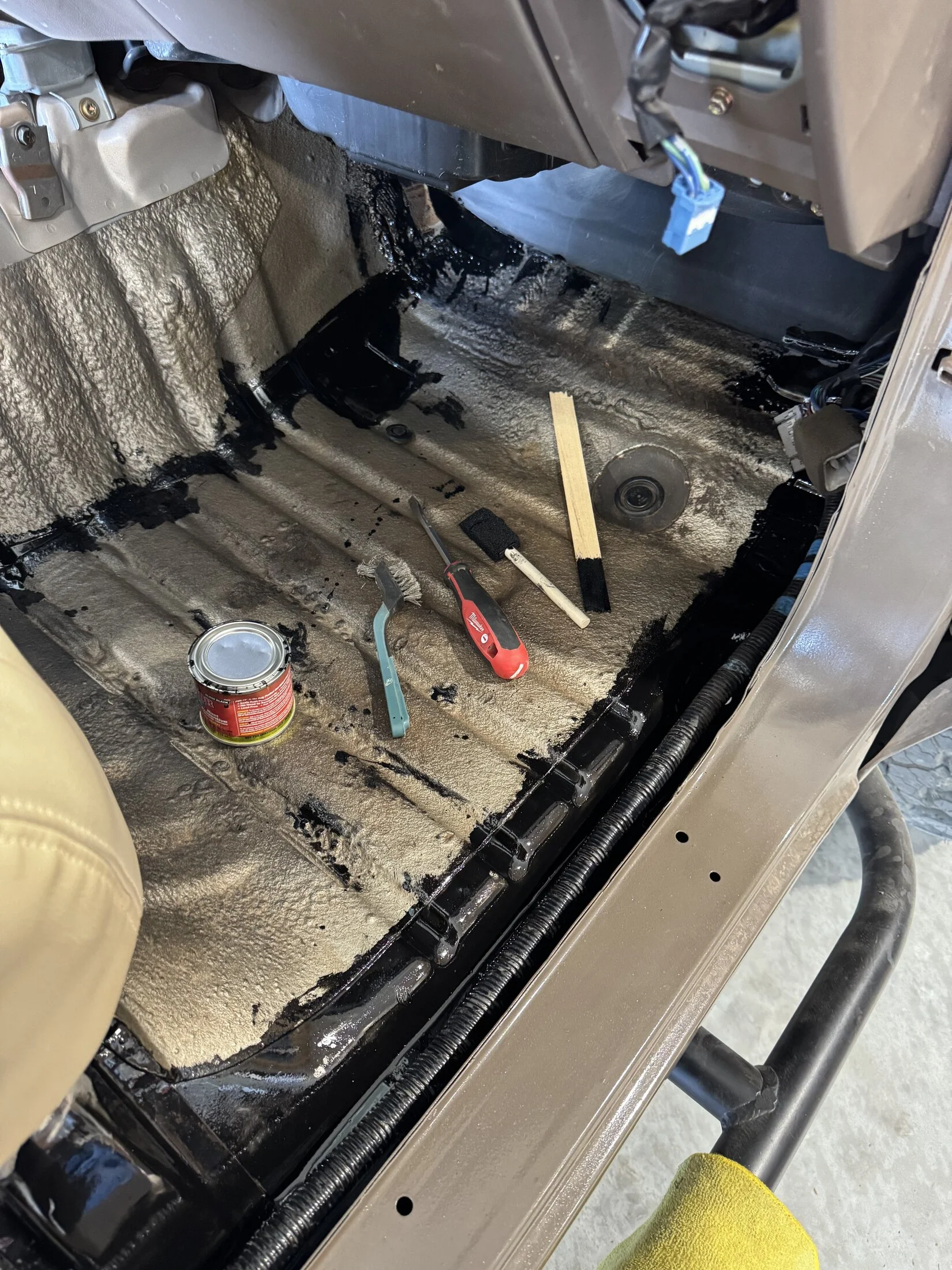

To kick off the prep, I used a leaf blower and air compressor to clear out all the dust and debris (which there was a lot from MOAB and our dusty trails in Oregon). While I was in there, I pulled the dash gauges and tachometer to replace the dash bulbs—figured I’d knock it out while everything was accessible, and sprayed out those areas as well. Then I went through with a metal scrub brush to remove any lingering fuzz or loose grime.
After that, I deep-cleaned the entire interior with Harbor Freight’s Grant’s steam cleaner and microfiber towels. Once it dried, I wiped everything down with 90% isopropyl alcohol to remove any remaining residue and ensure the surface was prepped properly for adhesion.

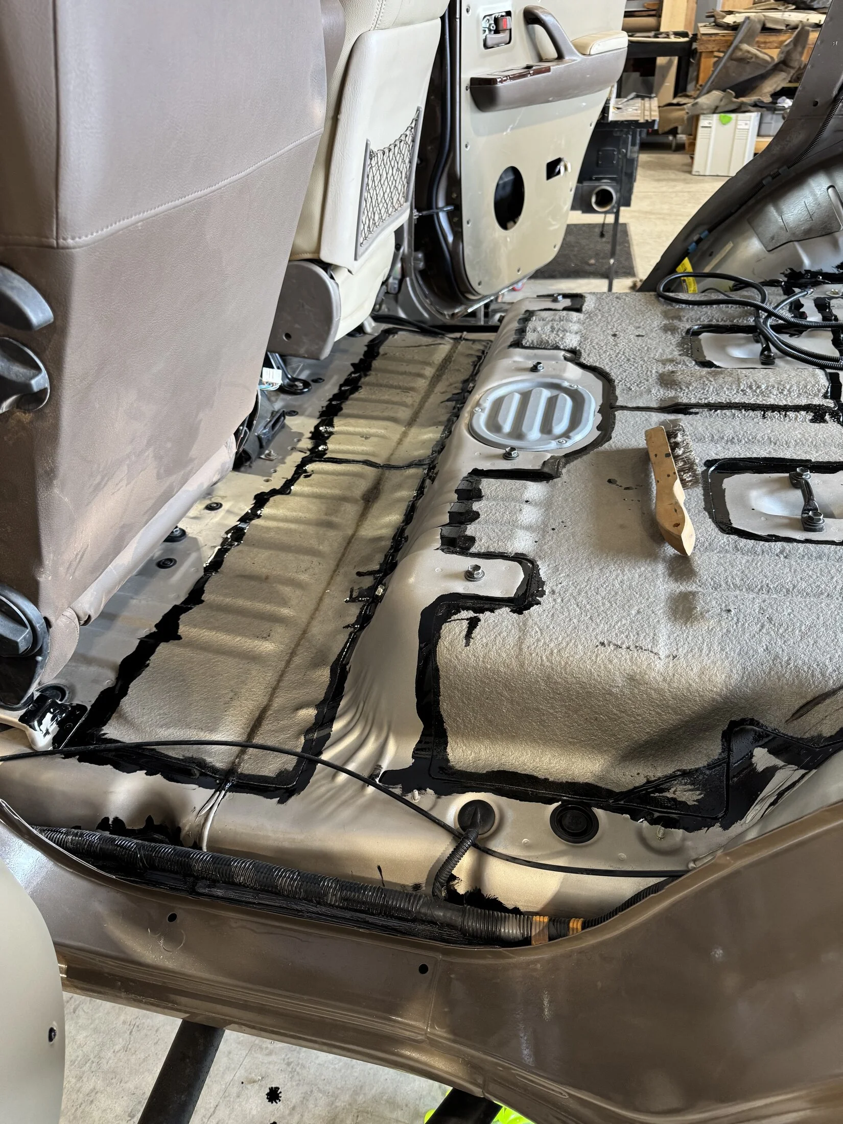

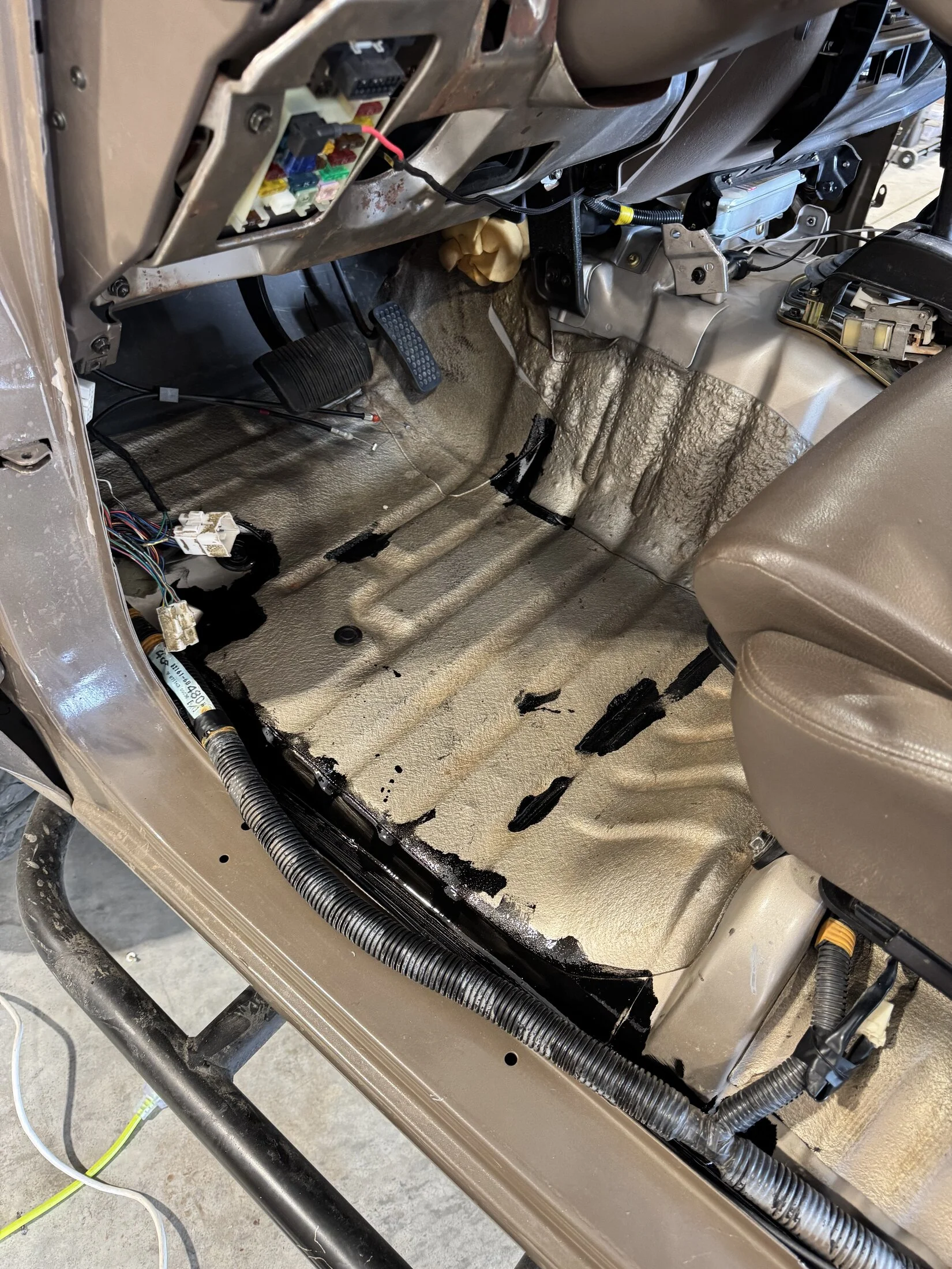

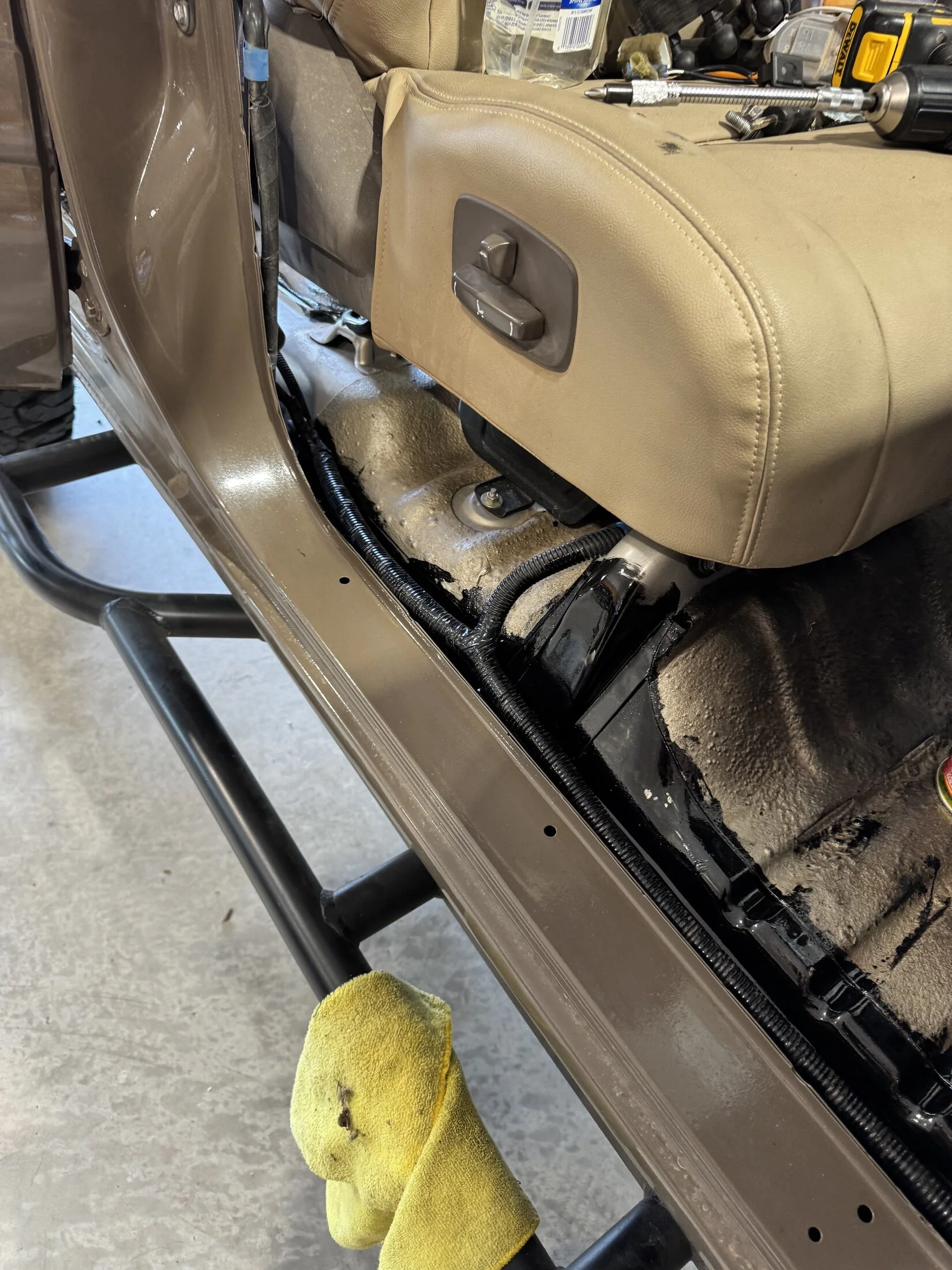

Since the interior was already out, I took the opportunity to apply POR-15 to any low points and metal seams where water might collect or where existing rust might have already formed—just a little insurance against future rust. I also sealed the edges of the factory sound deadening to help prevent moisture from creeping underneath it down the line.

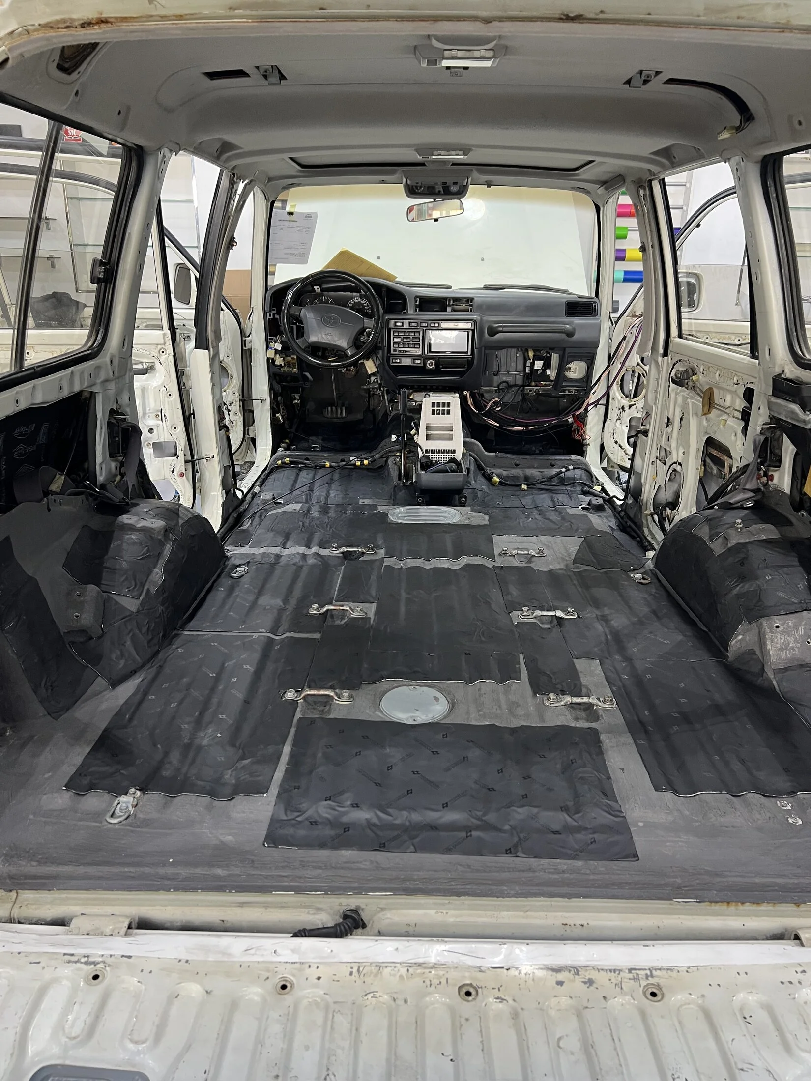

If the POR-15 cures by tomorrow, I’ll begin laying down the first layer of Resonix Mega CLD Squares, aiming for roughly 90% coverage across the floor. I’ve invested about $2,000 into materials for this project, with the goal of reducing road noise, improving sound clarity, and enhancing thermal insulation. I’ve got a quality audio system going in, so I’m treating the foundation with the same level of attention.

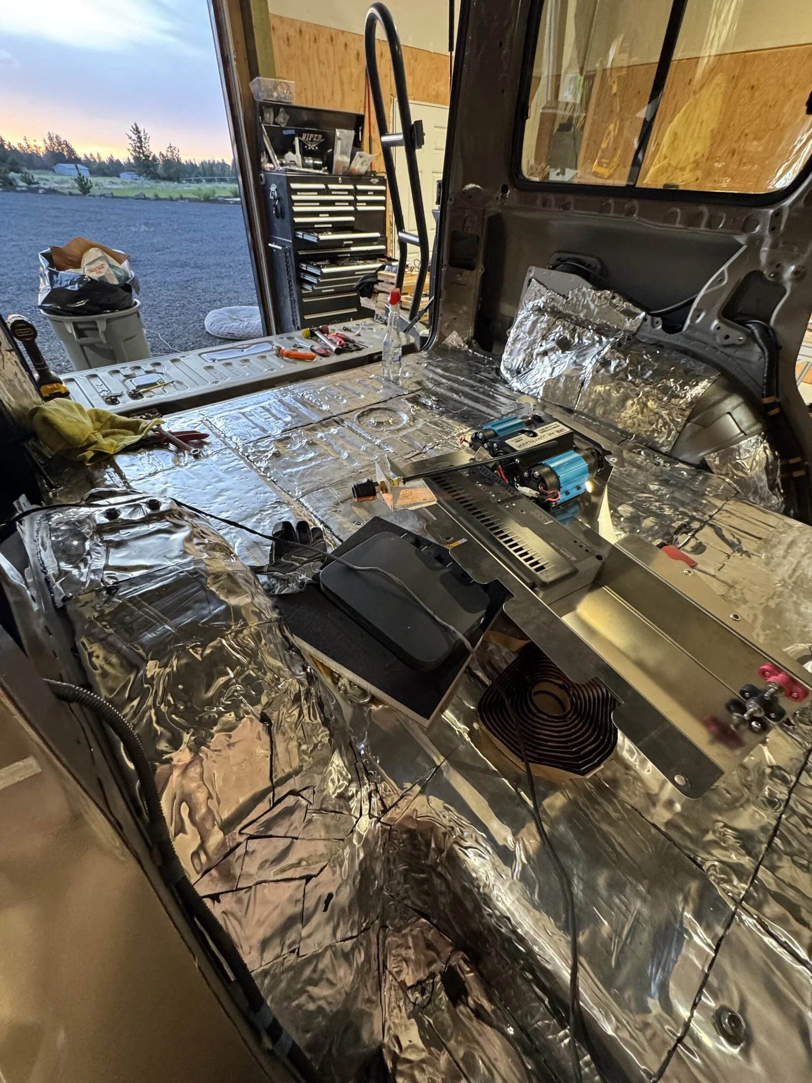

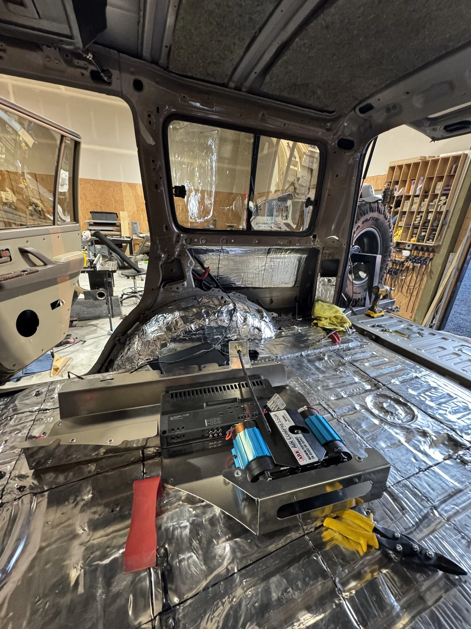

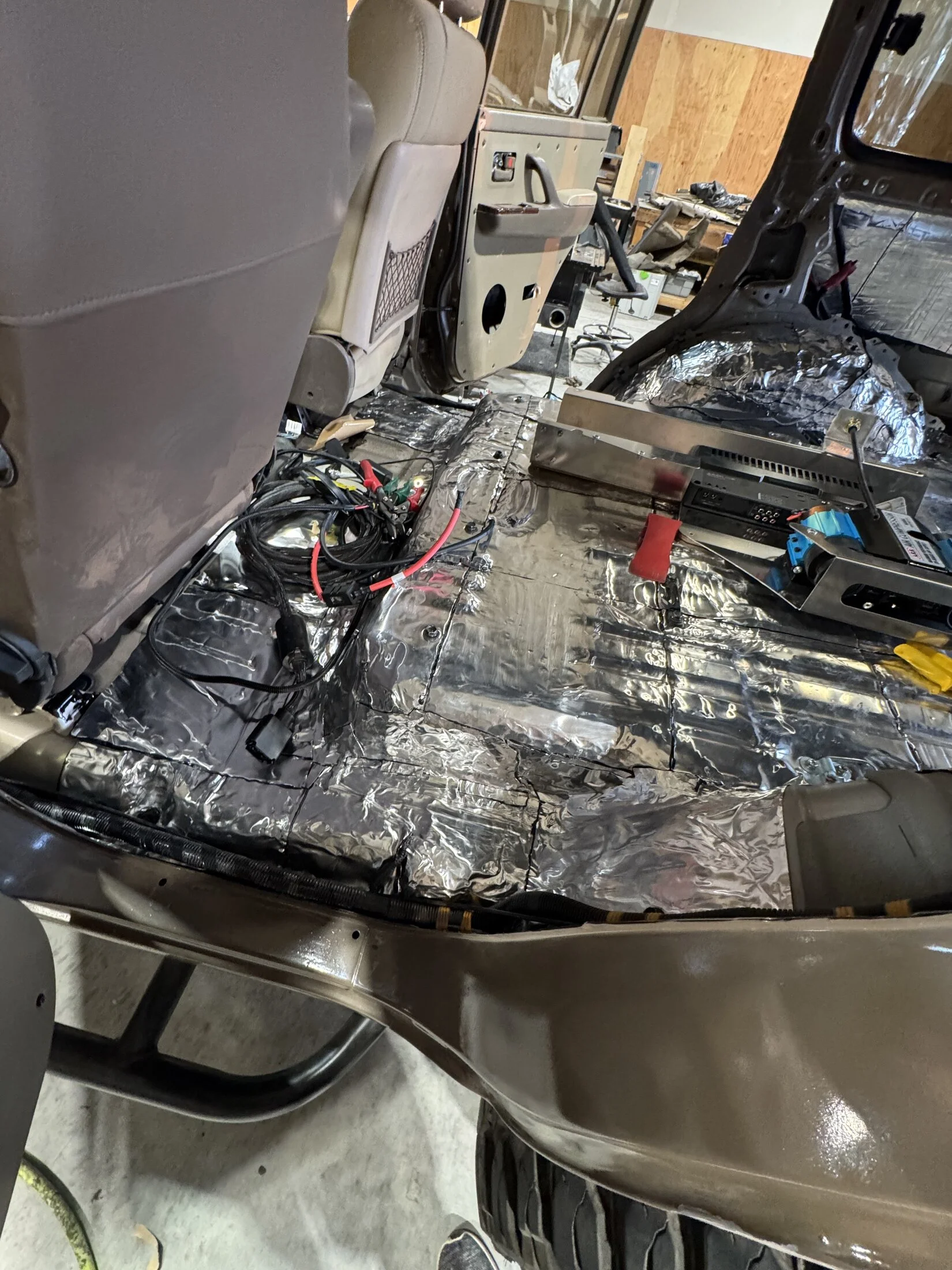

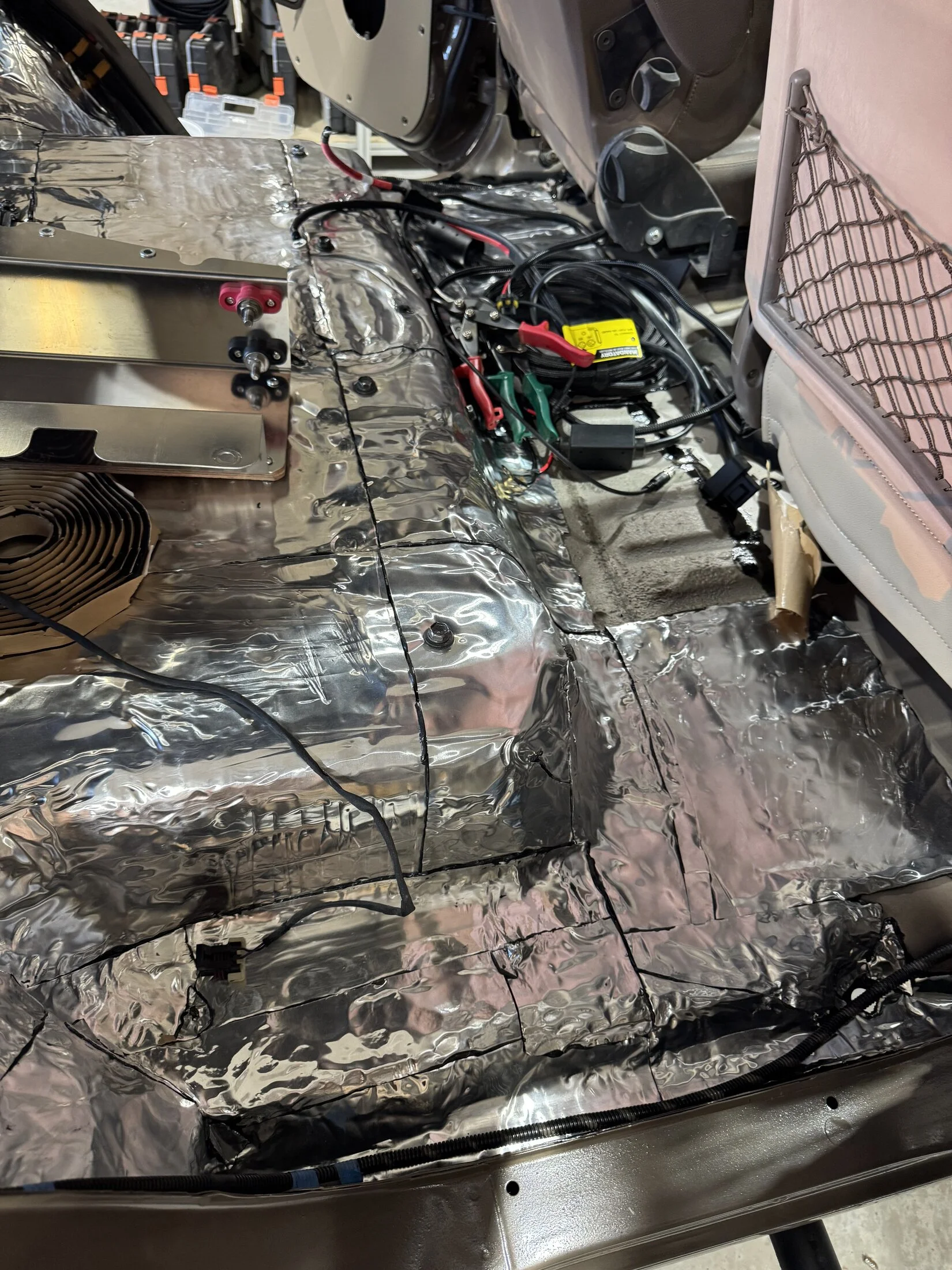

Day 2: Got 40 sheets (12”x12”) installed today—and I’m already out. Still haven’t finished the floor, doors, or parts of the quarter panels. Definitely underestimated how much material I’d need. Unfortunately, it’ll be a couple weeks before I can pick this back up.l as the materials are on back order.
The stick on butyl only stops ringing in the panels. Whack them before and after. You need mass loaded vinyl or foam of some kind (weight) to absorb the lower frequencies and sound in general

It really comes down to the quality of the product you choose. This stuff is top of the line—extra-thick butyl and heavy-duty foil. To really notice a difference, though, you’ll usually want to add a layer of closed-cell foam or fiber mat on top (which is what I’m doing).

I noticed a big heat soak difference under the passenger seat and into the second row. Especially during long trips the floor doesn't get super hot anymore.
Fwiw, 100% coverage for vibe/resonance damping is definitely unnecessary and just wastes material/money.
That being said, I installed ~70lbs of Amazon Basics in my 80 and the difference was impressive.
