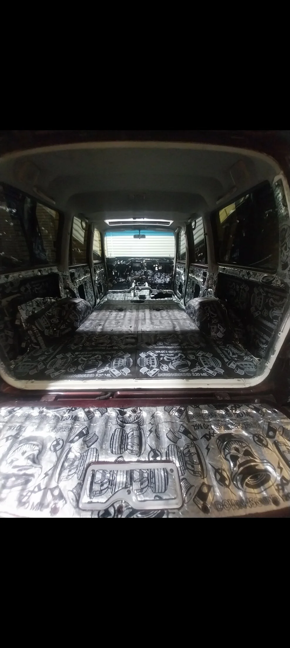

Fwiw, 100% coverage for vibe/resonance damping is definitely unnecessary and just wastes material/money.
That being said, I installed ~70lbs of Amazon Basics in my 80 and the difference was impressive.
I followed the 25% coverage rule, but I never did do the ceiling. I'm sure that'd cut down on the noise even more.
